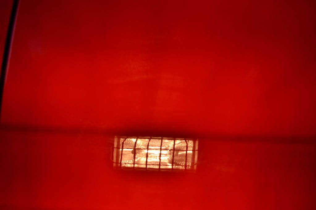

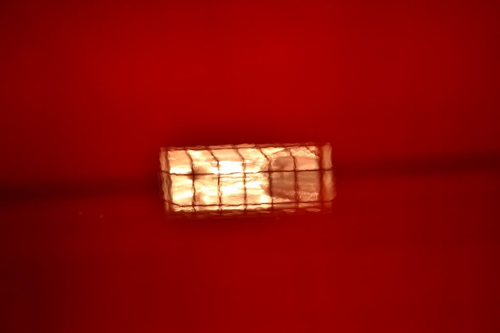

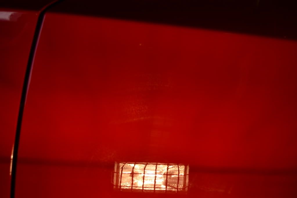

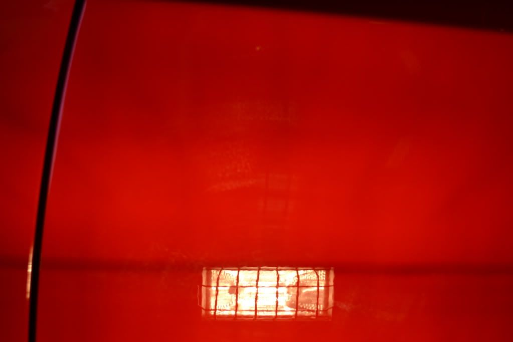

I was clay barring my car with poorboys clay (My paint literally feels like sand paper).

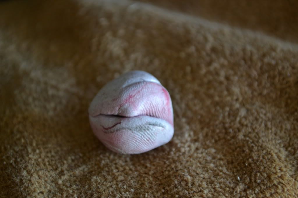

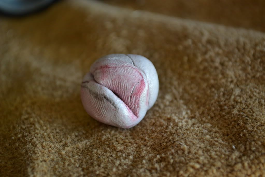

Anyways; I started noticing that I was getting serious marring across the paint. Pictures below. As well, on the rear bumper I was getting red all over my clay bar. Is this some sort of overspray or am I taking paint off?!
I was able to get everything corrected (Makita 9227c with M105/205 and Hydropads). But I'm just trying to figure out why my paint is in such bad condition.

clay doesn't remove clearcoat and a Z4 definitely has clearcoat so clay away without worry. You may have to polish again afterwards though. Sounds like you've got a tonne of overspray.
Had any bodywork done lately?
The red paint seems to be overspray from a previous paint repair. Overspray will definitely feel very rough like sand paper.
Yes. The stupid shipping company put a dent in the roof of the car.
So they had to sand the whole roof completely down and re-spray that...and I assume they did the rear deck lid as well. That would explain the overspray in that odd area.
Ok, that would make sense of why it was very rough.
It's too bad your vehicle is red also cause it kind of makes you think twice about what you're doing. Are you taking off paint, or over spray?
If it feels like sandpaper...I'd say without a doubt you have over spray. The fact that you're pulling red off with your clay is a pretty big give away that there's just red over spray. I also highly doubt your vehicle has single stage paint. The marring from the clay looks to be on top of clear to me.
Maybe a part of your vehicle has been resprayed? I say clay away, then polish out the marring. Then you'll be all set!:dblthumb2:
Yea, I tend to agree with everybody else that is is the over spray from the repair so no worries there.

Just something else I noticed in the first and second picture on the panel above the light it looks like you have some clay smears on it. Possibly using to little clay lube make sure its just about dripping and the clay shouldn't be grabbing onto the paint (once you take a majority of the overspray off)
no,
unless you drop it on the floor, stomp on it, then pick it up and start rubbing it onto your paint with no lube...
A quick tip for our clay (probably everyone else too) if you want to get it really soft and mailable run it under hot water while kneading it. Gets it really really nice to work with and than the heat of your hand will keep it that way.

It's good to know that I wasn't do any damage about taking the red paint off, and it's probably overspray. I was getting really worried when I started hitting the rear-diffuser and getting an extremely rough finish.
I did really minor clay bar, and didn't want to push it because it was Red Paint; and I was just scared of doing and damage. But from just thinking, it's probably bad overspray and I'll clay away and polish everything up
