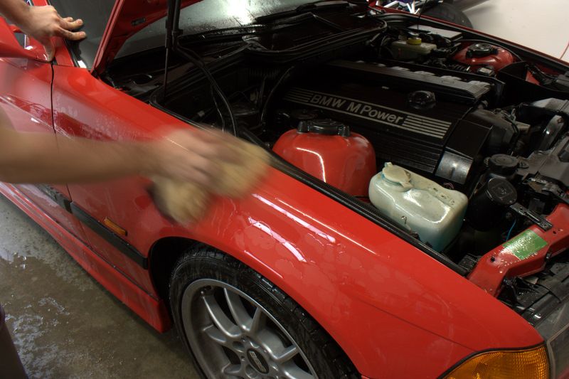

The issues I've seen with APC's on paint is when they are used in stronger concentration for cleaning engine bays and jambs. Over spray or dripping from the product lands on tops of the fenders or adjacent panels and stains the paint. While I've never seen "paint failure" or serious damage from them, those areas will likely still require some amount of polishing to remove the stains. This goes way back to the early 90's when I was doing high volume work. We always wet fenders and adjacent panels down with water to avoid the issue, but occasionally it would still happen. The majority of the APC's we used back then were from Car Brite or Auto Magic, but I've seen Simple Green, some "Purple" cleaner from HD/Lowes, Megs D101/103, and on this BMW M3 below, P21S TAW, which was used to clean the engine. I had wet the fenders on this car but it was actually the black kidney grills that were damaged/stained by TAW, which had to be polished out by hand to fix the issue. LOL....it was actually kind of ironic too. I had taken process pictures for writing an article on engine cleaning and how APC's can stain the fenders, and I ended up having staining on the grills instead. :awman:
wetting fenders down
