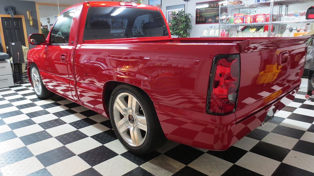

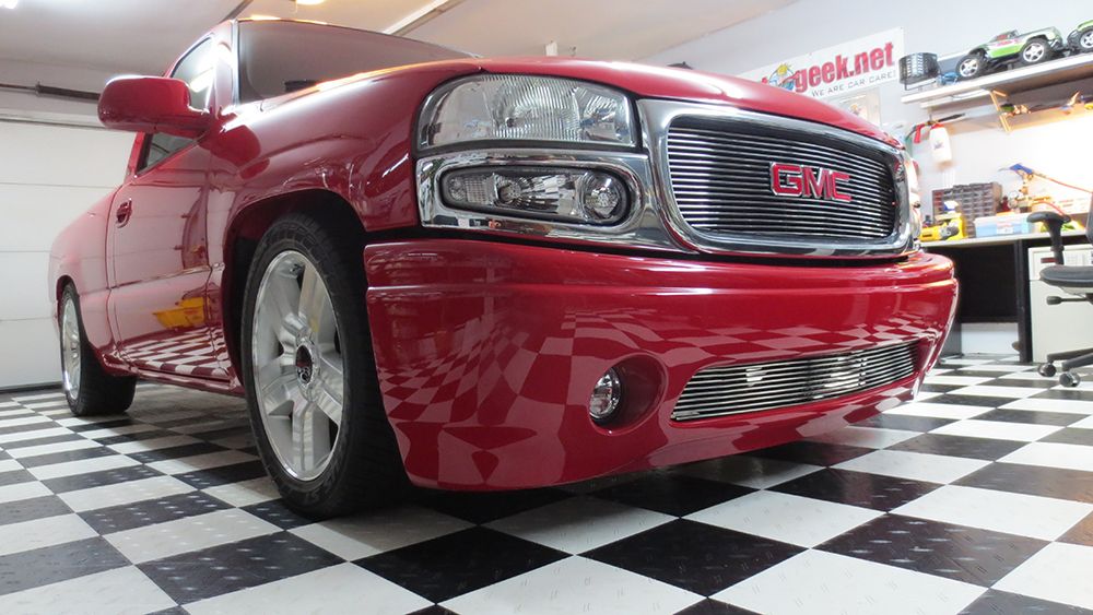

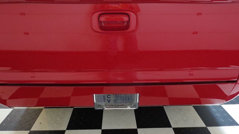

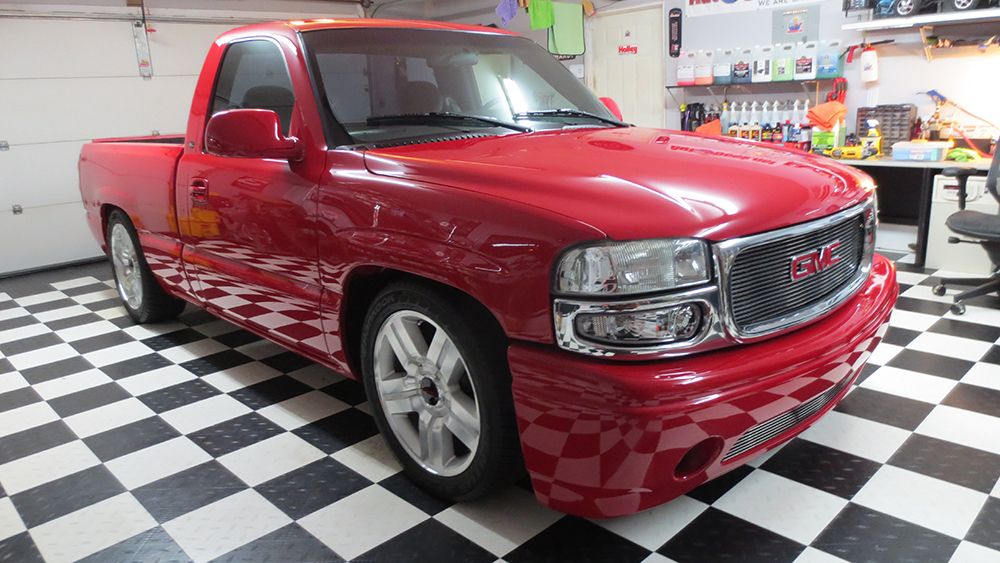

Prima Amigo is a prewax cleaner and glaze that has just enough micro abrasives for lite correction with the correct pad. I did a full correction on the truck a couple weeks ago so I wasn't looking to remove or fill any swirls. What I wanted was to remove the coats of wax I applied after the correction, then to apply some of the new ($50) Fuzion wax on a clean prepped surface.

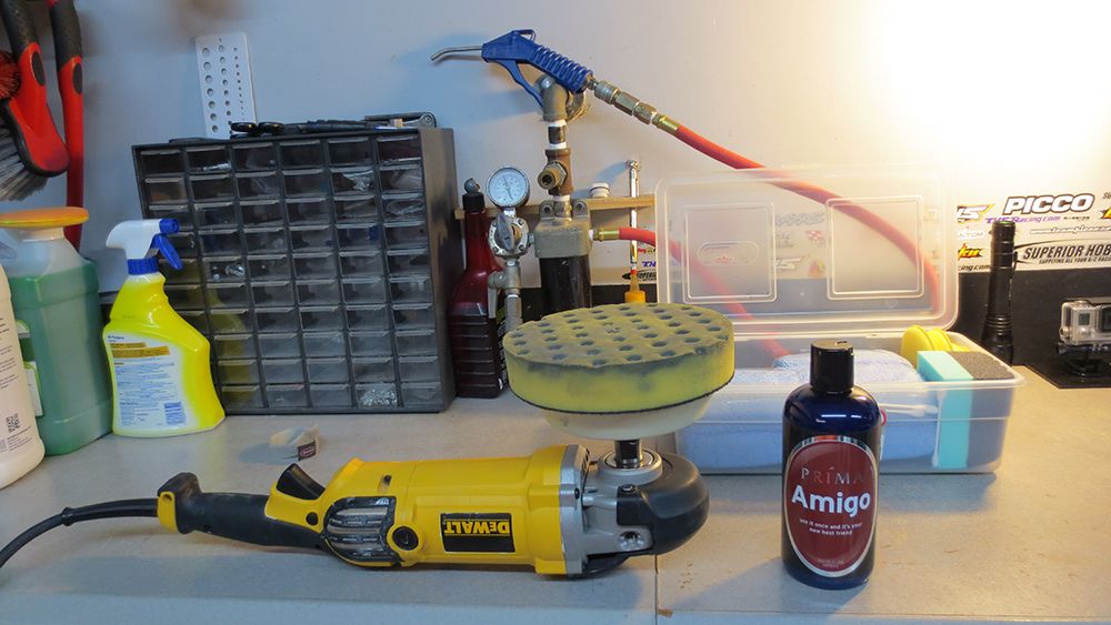

My original plan was to use the GG 6" with a 5.5 LC flat black pad to work in the Amigo as the directions call for a DA. Going through my pad drawer I noticed a new 6.5 CCS Gold Jeweling pad... hummm wonder if this super soft pad along with the super fine abrasives in the Amigo might be a good jeweling combination? Hell give it a shot you know it will get the paint LSP ready anyways!
600 RPM's the large soft pad easily conformed to all the nooks and cranny's gliding smoothly across the finish. I cleaned the (same) pad on the fly with a terry cloth towel and had the paint ready In about 2.5 hours. It was a pleasure running the rotary, no vibrations and quiet enough at 600 to hear the stereo (pandora) :)
I can say the Amigo squeezed out a little more clarity in the clear leaving it super clean and slippery smooth. Hand applied the Fuzion and I'm happy with the results. I will use this method again especially if/when I need the glaze for filling/hiding before the next correction.
My pretty Gold pad :laughing:
