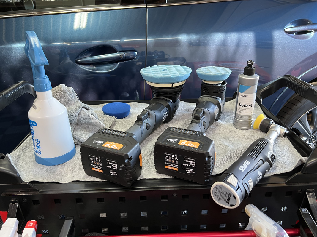

Mazda paint is known to be ultra soft and ultra-thin, so erring on the side of caution was smart here. But yes, Reflect on a Rupes white pad is certainly a very mild combo.
I polished out an Eternal Blue Mazda CX-5 using Reflect and a blue ShineMate foam pad, which left an almost flawless finish. That ShineMate blue would be similar to the new Rupes Aqua intermediate pads, or the Lake Country SDO/HDO orange. So, I would step up in pad aggression before stepping up the compound, that might just take you to where you want to be.
