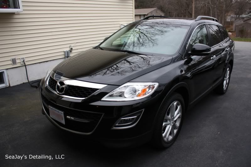

So, the vehicle upon arrival - Should note that it was a cloudy rainy day
After a quick ONR wash the paint looked in decent shape...obviously the LSP that the dealer applied was still there.

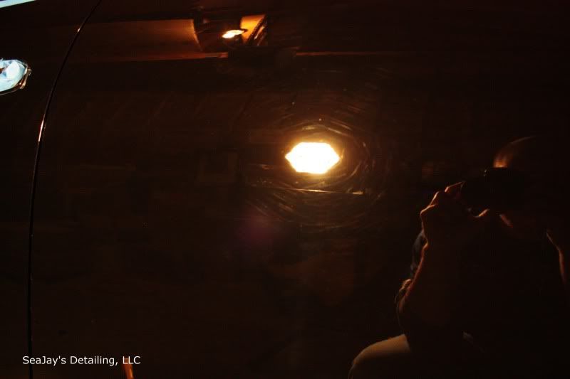

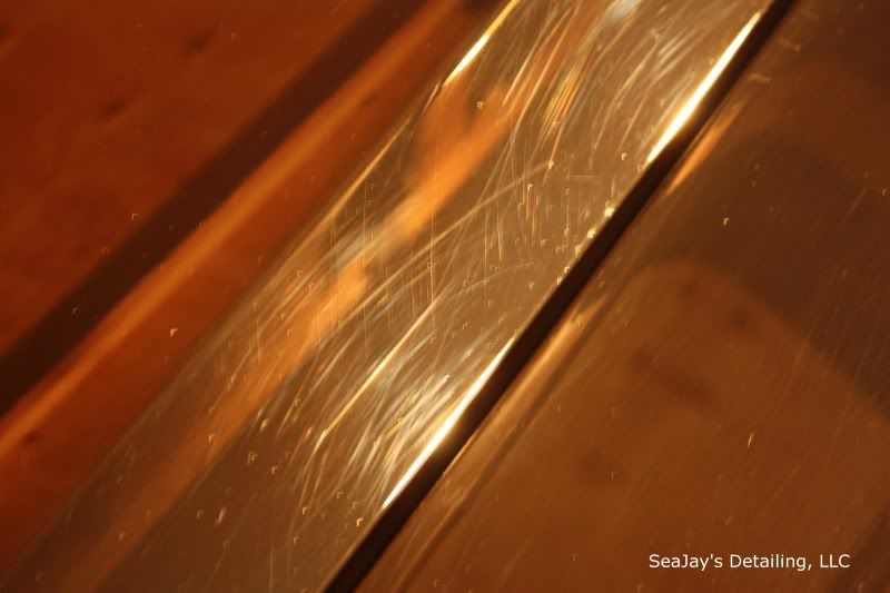

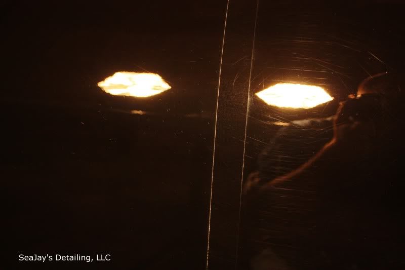

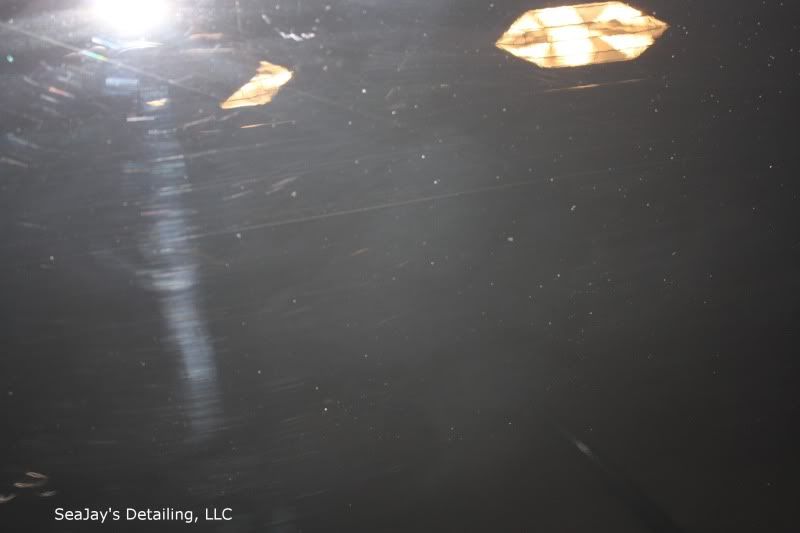

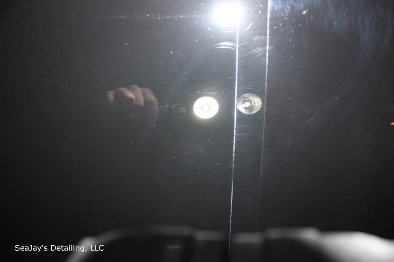

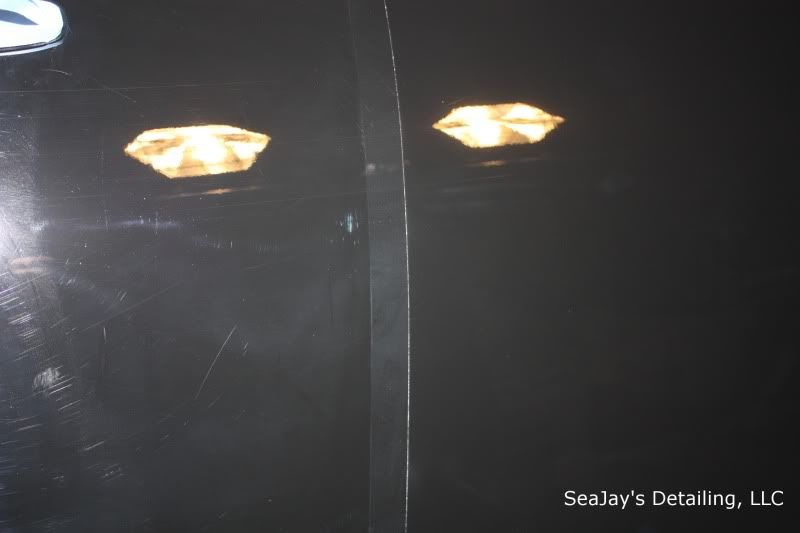

After a full claying and an IPA wipe down the true defects came out
I had a really hard time capturing the defects...again user error with the camera I'm sure. Out of the 100+ pictures I took I ended up with the ones in this thread...
I played around with a couple products/pad combos and quickly realized that this car really needed a multi-step correction. So, after calling the client up to explain his options based on time I had with the vehicle and that it was a lease, we decided a one step and the opti-coat was good enough.
I ended up using Menzera Super Finish on an orange LC pad. Which gave me a good cut and it finished off without any issues.

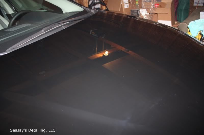

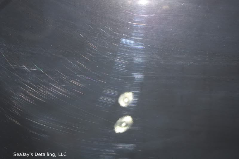

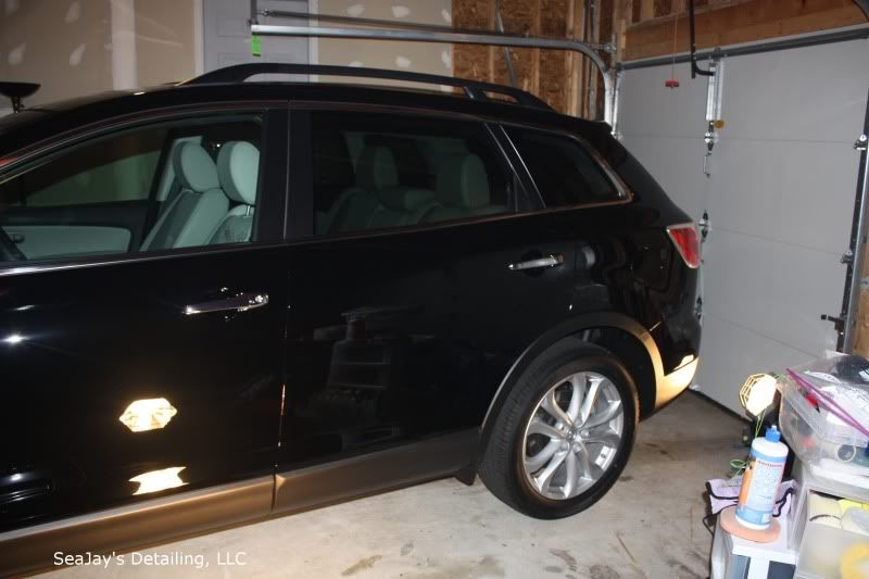

Couple 50/50's
The white flecks on the left hand side are lint from my MFs...
And some after polishing..again awful pictures

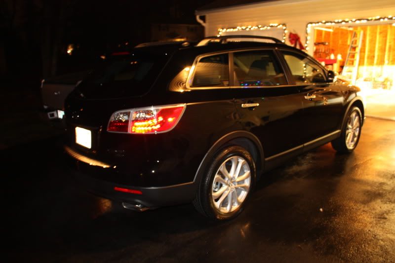

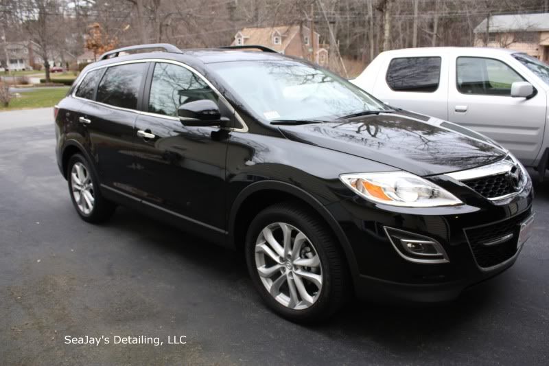

The car then got 2 IPA wipe downs due to Super Finish is extremely oily. Once that was finished I applied the opti-coat 2.0 to the whole vehicle and the rims. The windshield was not coated.

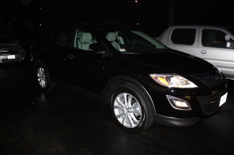

Due to it was dark and raining out after the Opti-coat application had finished drying (approx 1 1/2 hours) the after pictures are bad.
Over all I was pretty satisfied with this job. I'm not pleased at all with the awful pictures I got, but I promised Buddy I'd do a write up on the job! I'm a man of my word.
