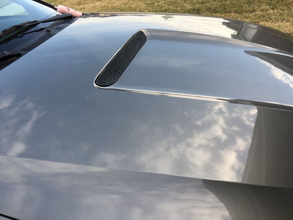

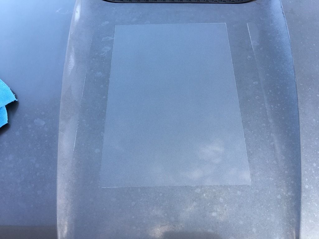

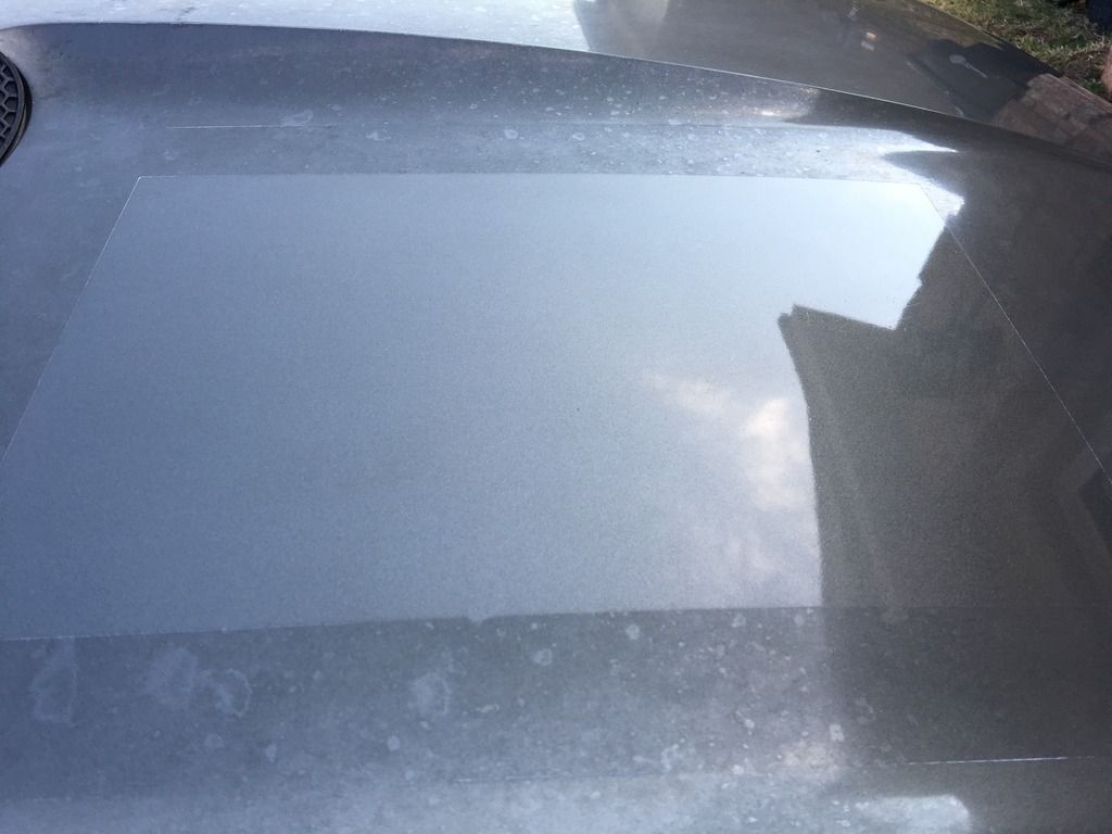

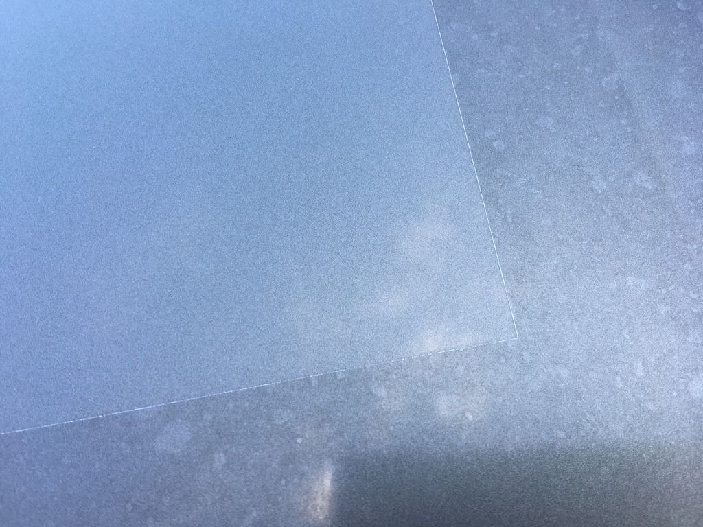

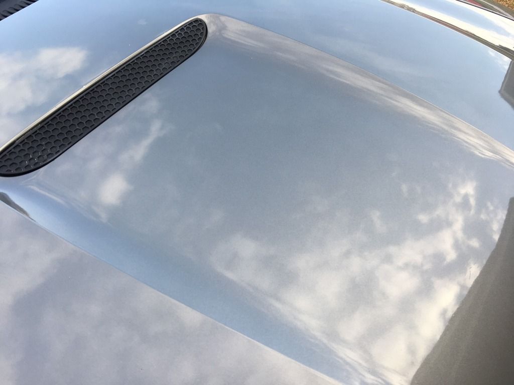

Thought I would post some pictures for anyone that might be interested in this one step product. I purchased a 02 Mustang and the paint was in pretty bad shape as you can see from the pictures. I only took before and after pictures of the hood but what a difference it made. I used a yellow Lake Country 5 1/2 x 7/8in beveled pad on a Griots Garage 6in Random Orbital Polisher. Tried to clay but it was doing nothing at all so went straight to the D151 and finished up with Mothers California Gold Pure Carnauba Paste wax. Overall a great product that is easy to work with with minimal dusting. Great shelf life as well, I purchased this product from Autogeek 6 years ago.
Before
Few 50/50 shots
Finished Product
