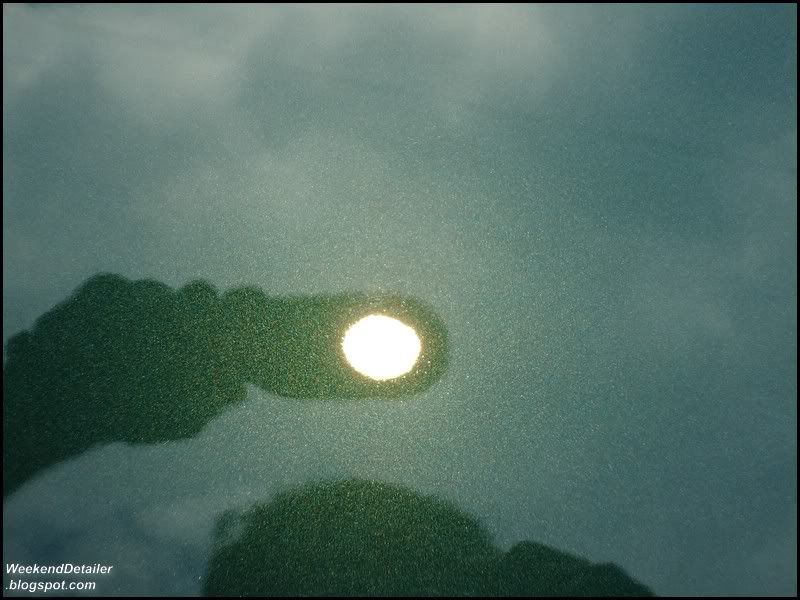

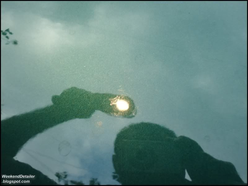

I've used the MF cutting pads with Menz 3.02 and got excellent results.
My hood was full of waterspots and deep scratches from aggresive claying some paint splatter. MF pads and 85RD3.02 did a great job o clearing both.
Before
After
