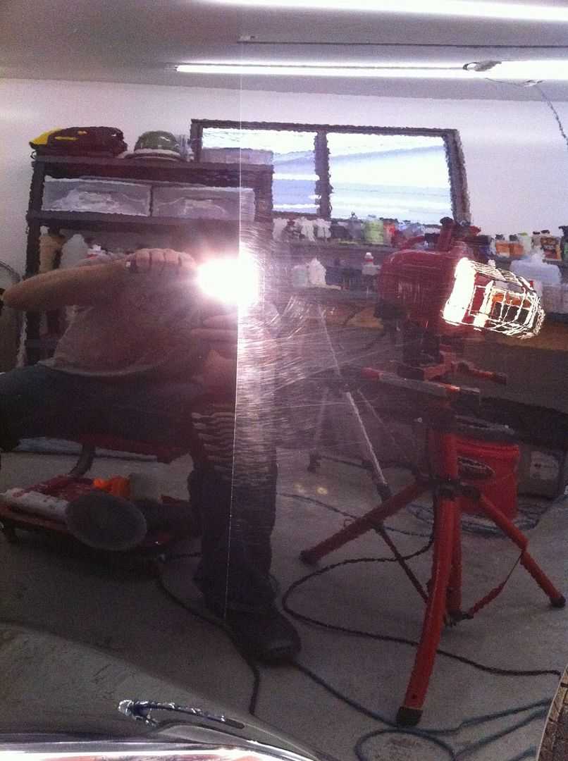

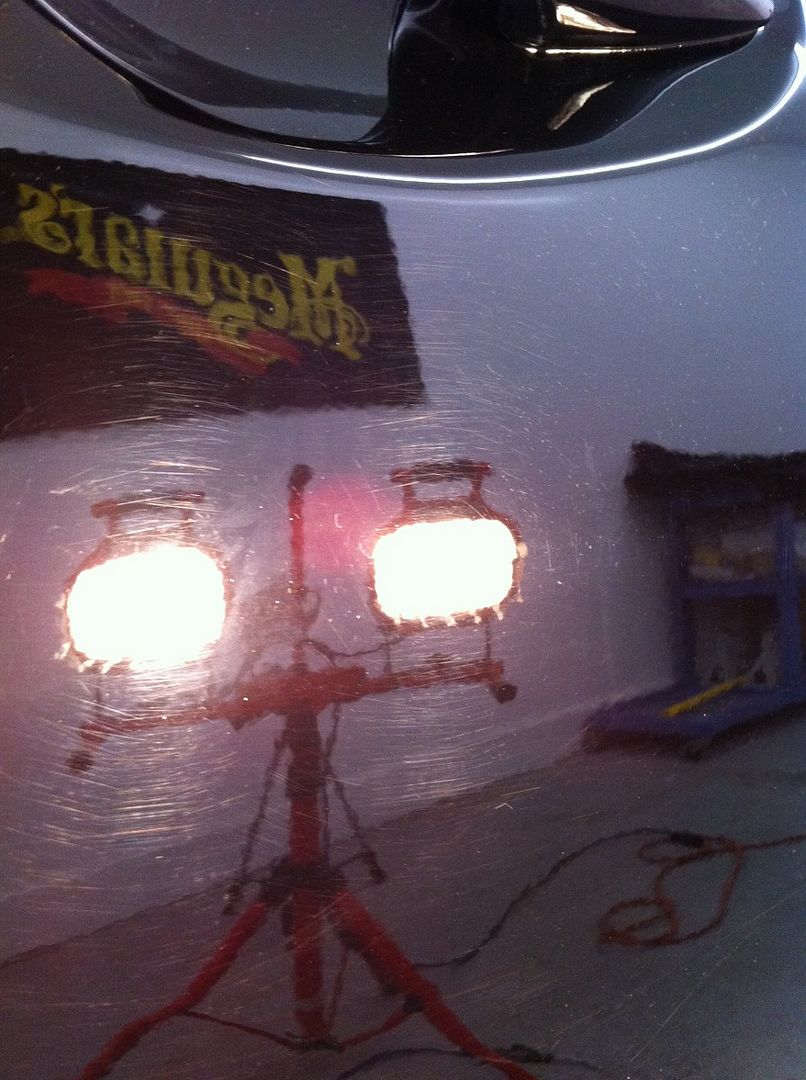

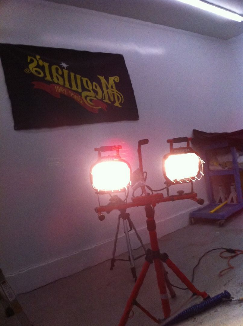

I'm working on a black 2010 Lexus with a tinted clear now. D300 worked very well, but as Joe noted, M105 actually worked better! It cut more and finished off better too! Very dependent on technique though! :props:
This is before after with D300...left a slight haze, better seen with the dual xenon.
after
and this was with M105/MF
