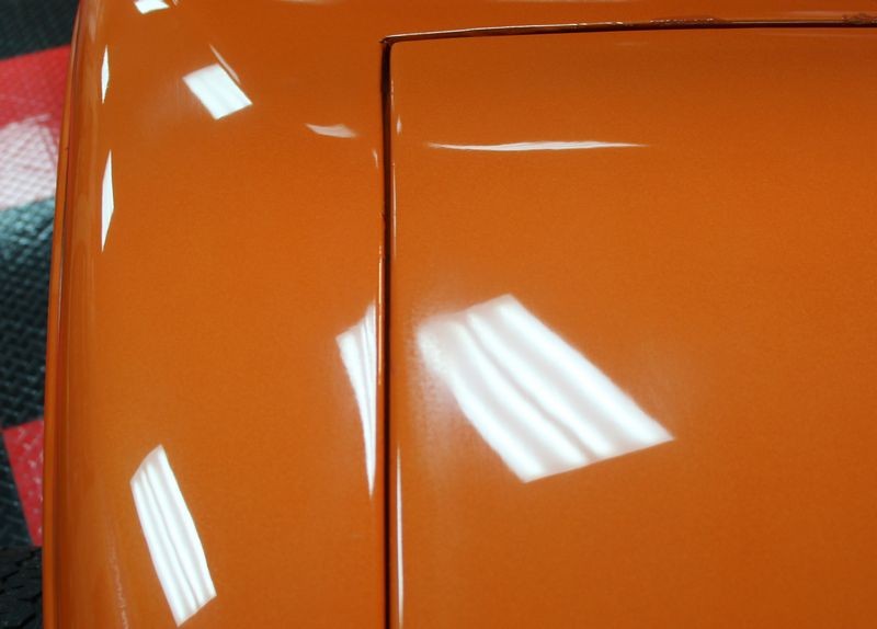

I will say that this paint is to old and single stage if I read correctly. Any attempts at correcting the paint should be dedicated to preserving what is left of it.Meguiars #7 Show Car Glaze is a final step auto glaze to enhanced the gloss prior to wax application. Get a show car shine with Meguiars #7 Show Car This is what Mike Phillips showed us to use first on this type of original single stage paint. He instructed to put it on generously and let it soak in overnight in a garage. The next day apply a second coat generously on top of that and wipe off. Then follow with a good sealant. You will still have defects but you will still also have
shiny paint.
I was curious about this too. Most if not all of the second gen F-bodies I've been around had single state paint and both of my G-bodies ('84 Olds and an '88 MCSS) had single stage lacquer (although I can't remember if G-body paint type varied by assembly plant and/or color). On the other hand, all F-bodies were base/clear starting in 1982.
I don't mean to suggest the OP doesn't know his own car, I just want to be sure he knows that late '70s and '80s GM paint systems were all over the place.
BTW-I followed Mike Phillips's technique using #7 topped with carnauba wax on my Monte Carlo and it came out great. The gloss combined with preserving some of the original patina was a really good look on an older/imperfect car that was a driver and then sat in a barn for 10 years.
