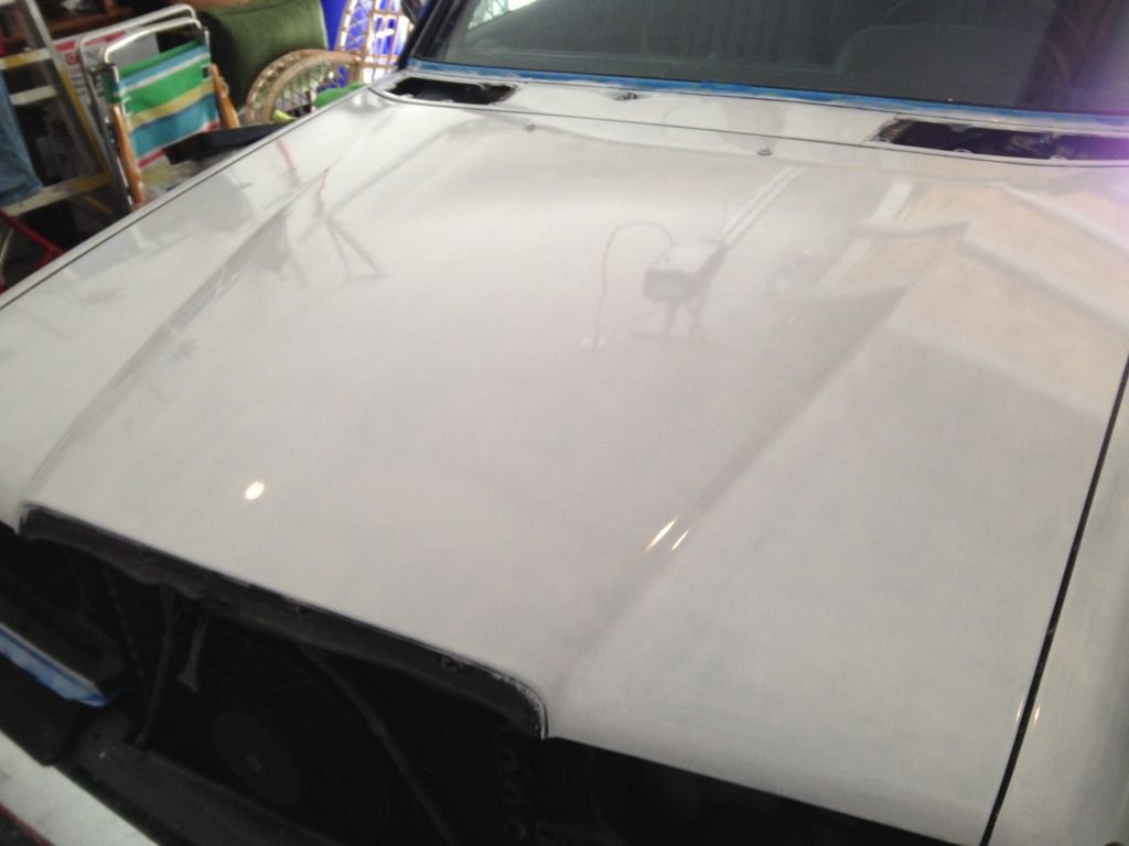

Roughed car up with 320 grit and removed trim and emblems.
Method was using Rustoleum Gloss White thinned to about 1:1 with Mineral Spirits and a dash or 2 of Pentrol. Rolled on in thin coats with a dense 4inch foam roller. 2 coats, wetsand, 2 coats, wetsand going up in grit each time.. Total of 9 coats. I will let it sit for about a month before I do a final wetsand with 2500grit and a 2 step.
On to the pictures!
Stripped down and ready to ROLL (My dad in the pic)-
After the first coat (Morale was very low at this point)-
2nd Coat (Ok a bit better)-
I think this is coat 4 or 5 -
Pulled outside for wetsanding-
Coat 7 (Now we are talking!)-
And now some glamour shots. I still need to take some paint thinner and get some of the spots where the wetsand slurry and drips are. Really excited to be able to polish it.

No idea. I didnt rush it.
About $60 in all materials, paint, brushes, rollers, etc etc
