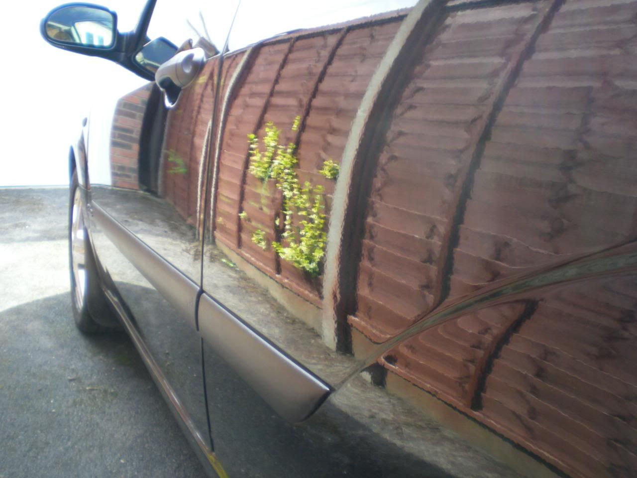

Contacted by the owner to initially remove Cuprinol that had been on the car since he and his neighbour had sprayed their fences. This is the second one I have done this month.
Plan was as for the first one did was some aggressive Chemical Guys clay then polish out. But as ever plan A did not work so plan B came into play. The whole car had to be sanded to remove it. So I broke out the Mirka 2000 and 4000 grit pads and proceeded to sand the whole car. Not one for just removing the Cuprinol and leaving a mess I gave the whole car a full wet sand detail. Customer agreed after seeing the back I clayed and sanded so ahead went the detail.

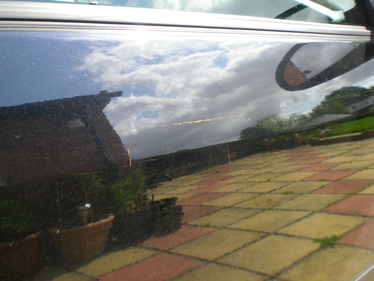

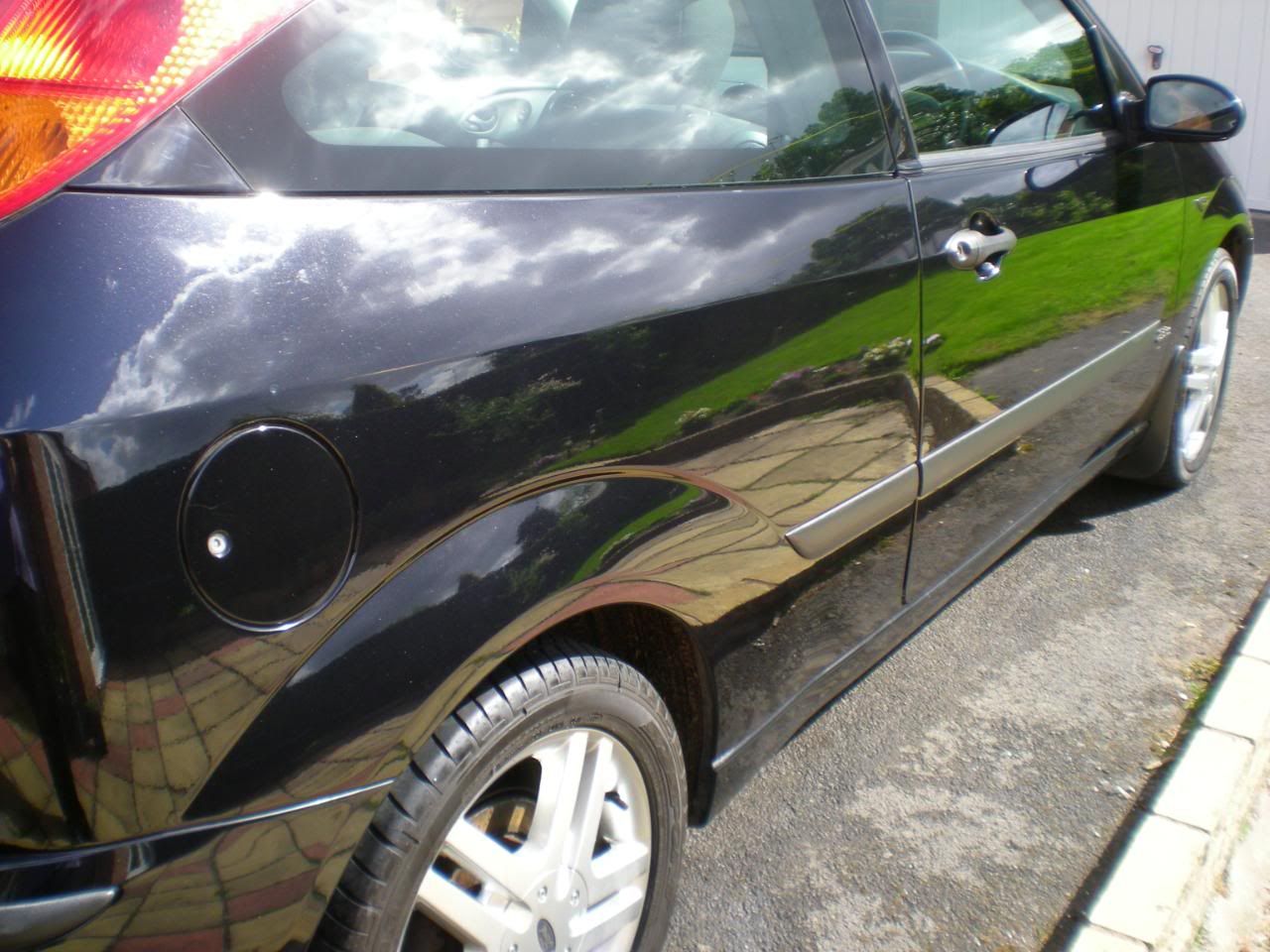

After Wet Sanding and initial polish.

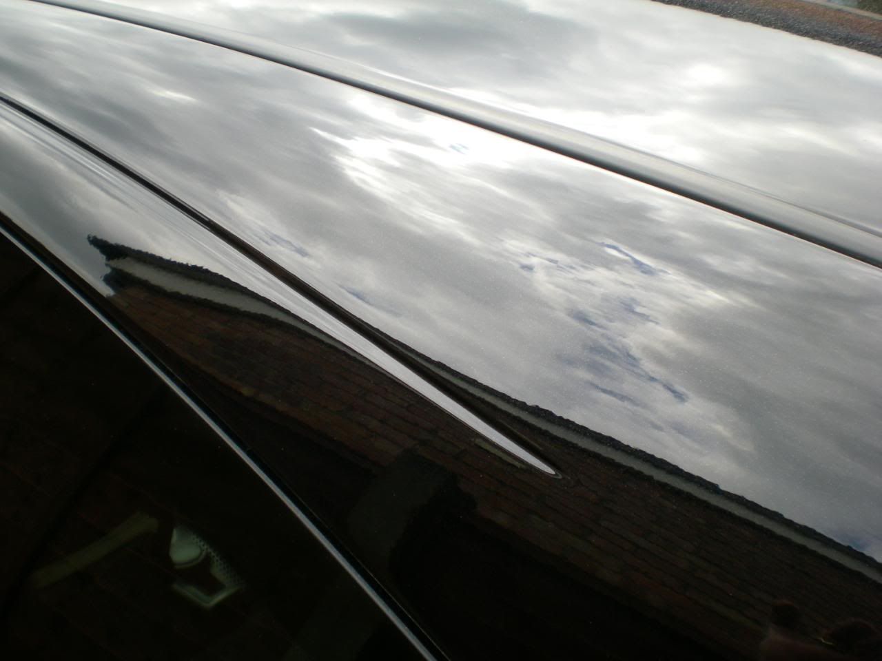

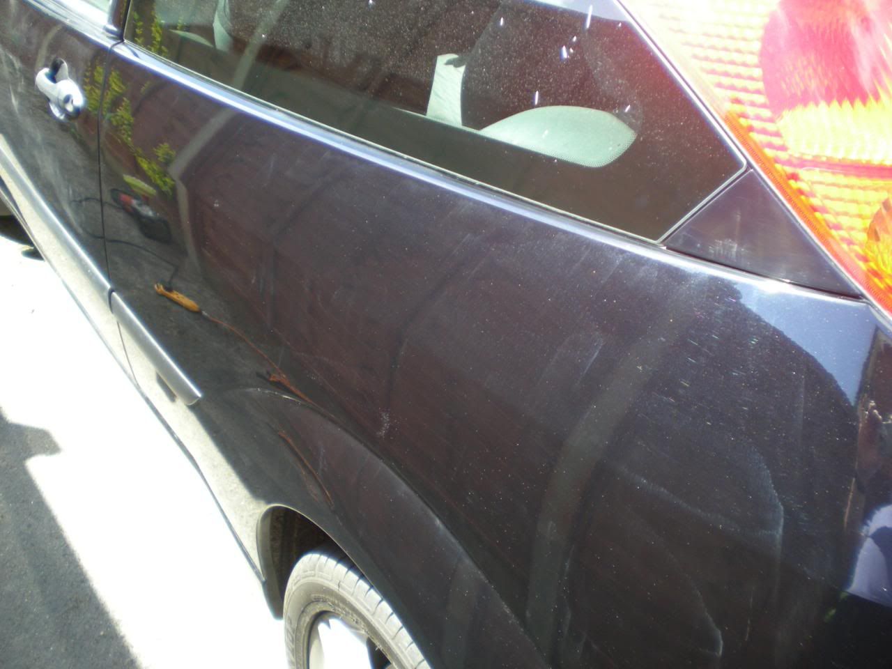

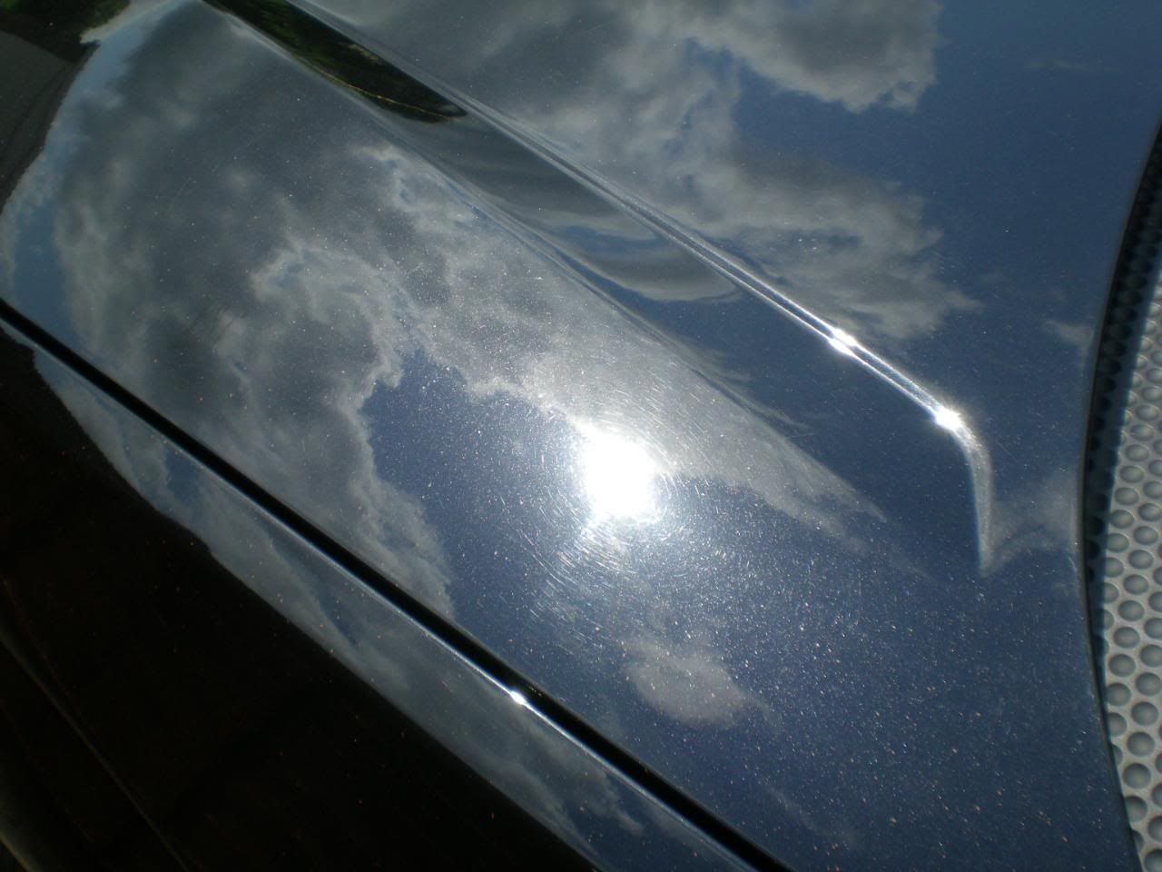

After 4000 grit Mirka disks just to remove the Cuprinol, not a full wet sand job.

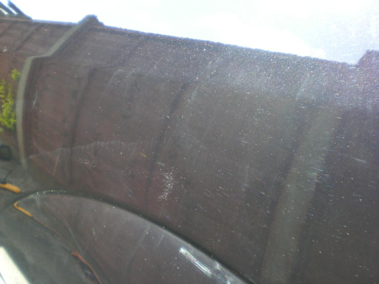

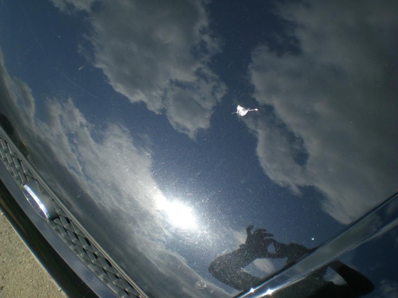

Swirly and nasty looking.

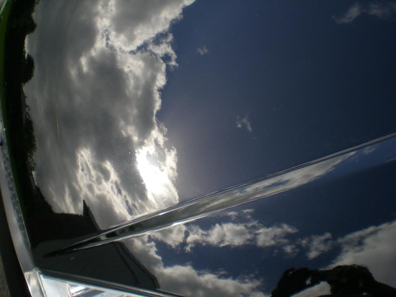

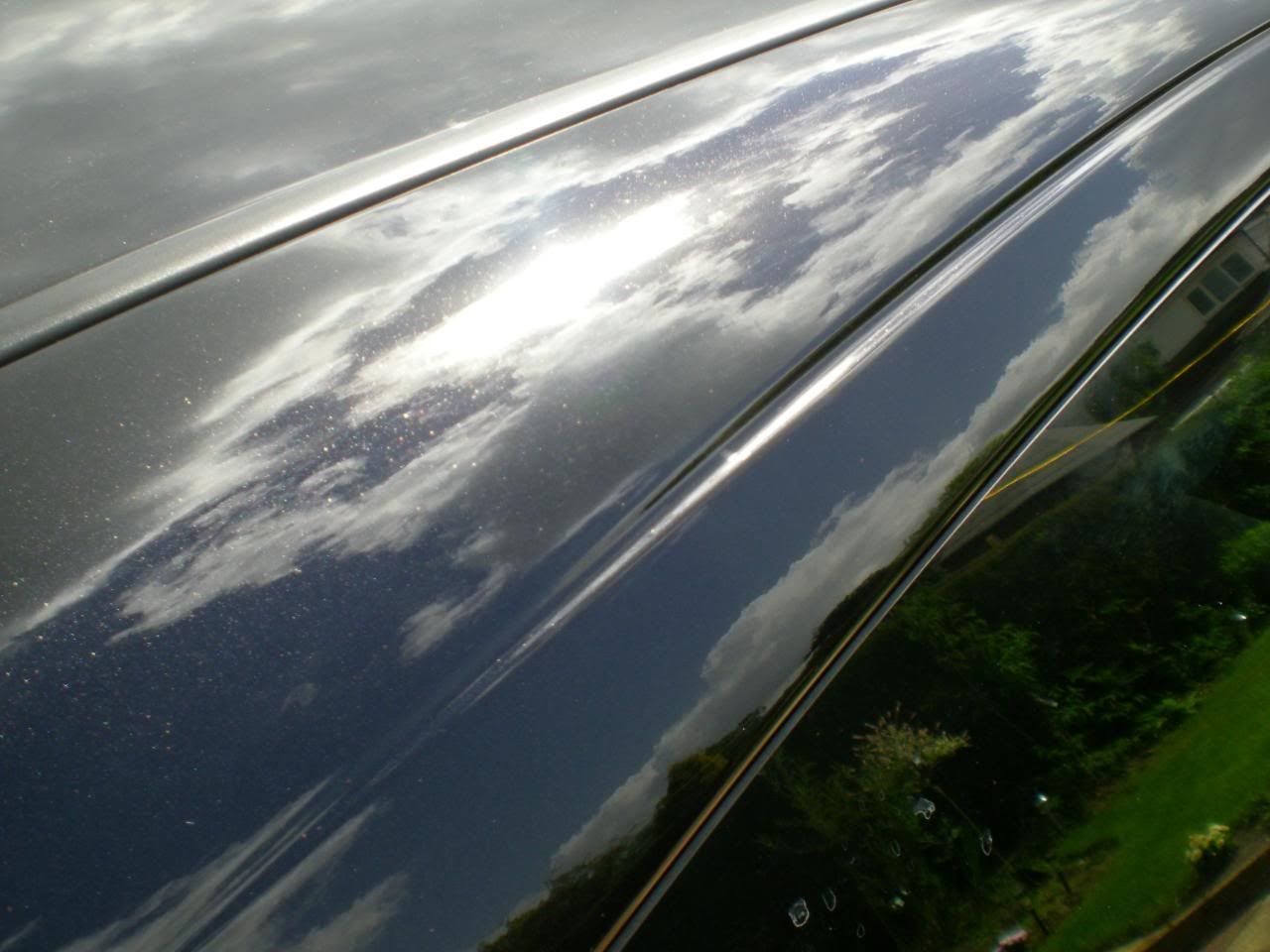

After a polish, before 2nd polish and refining.

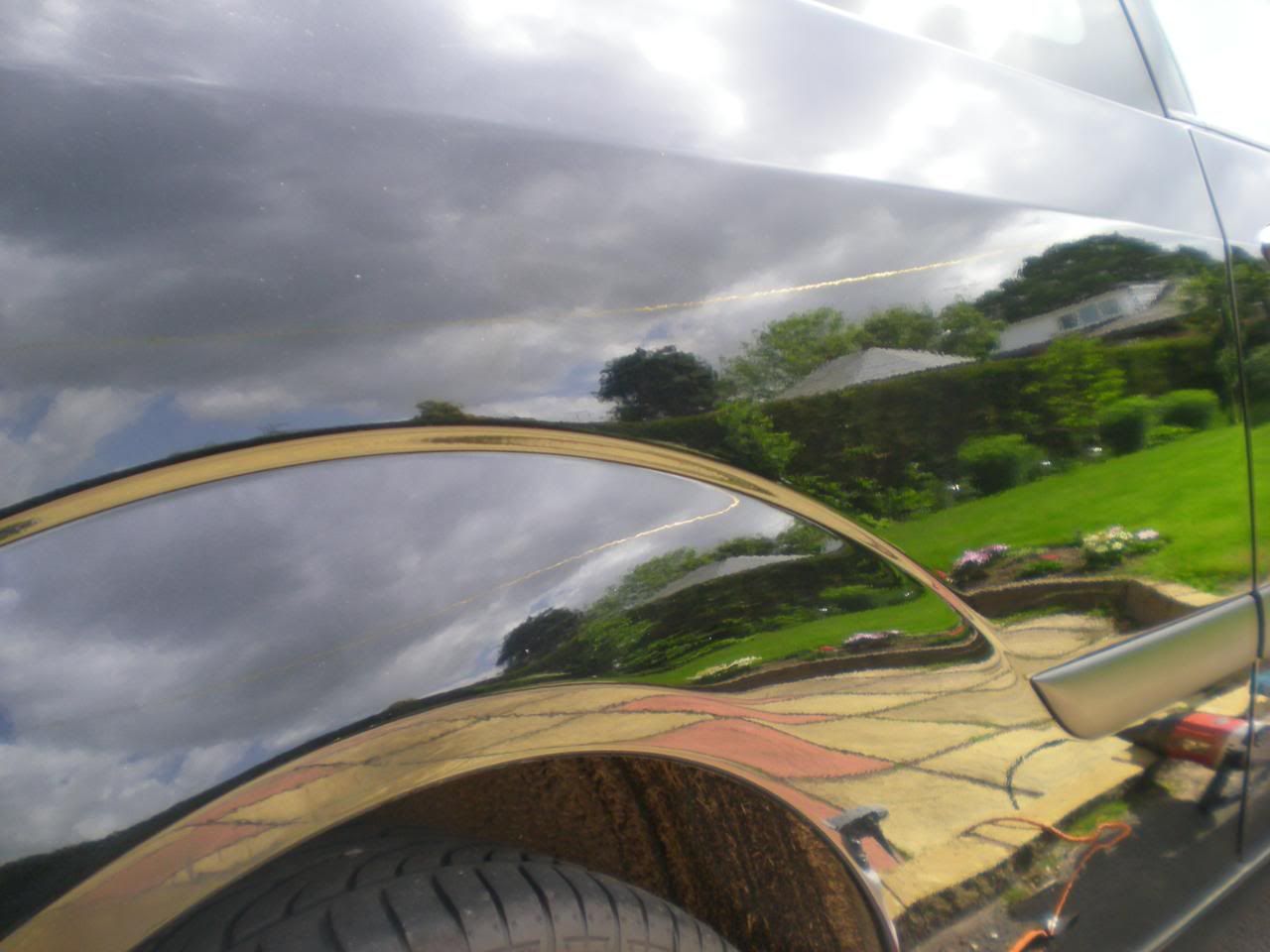

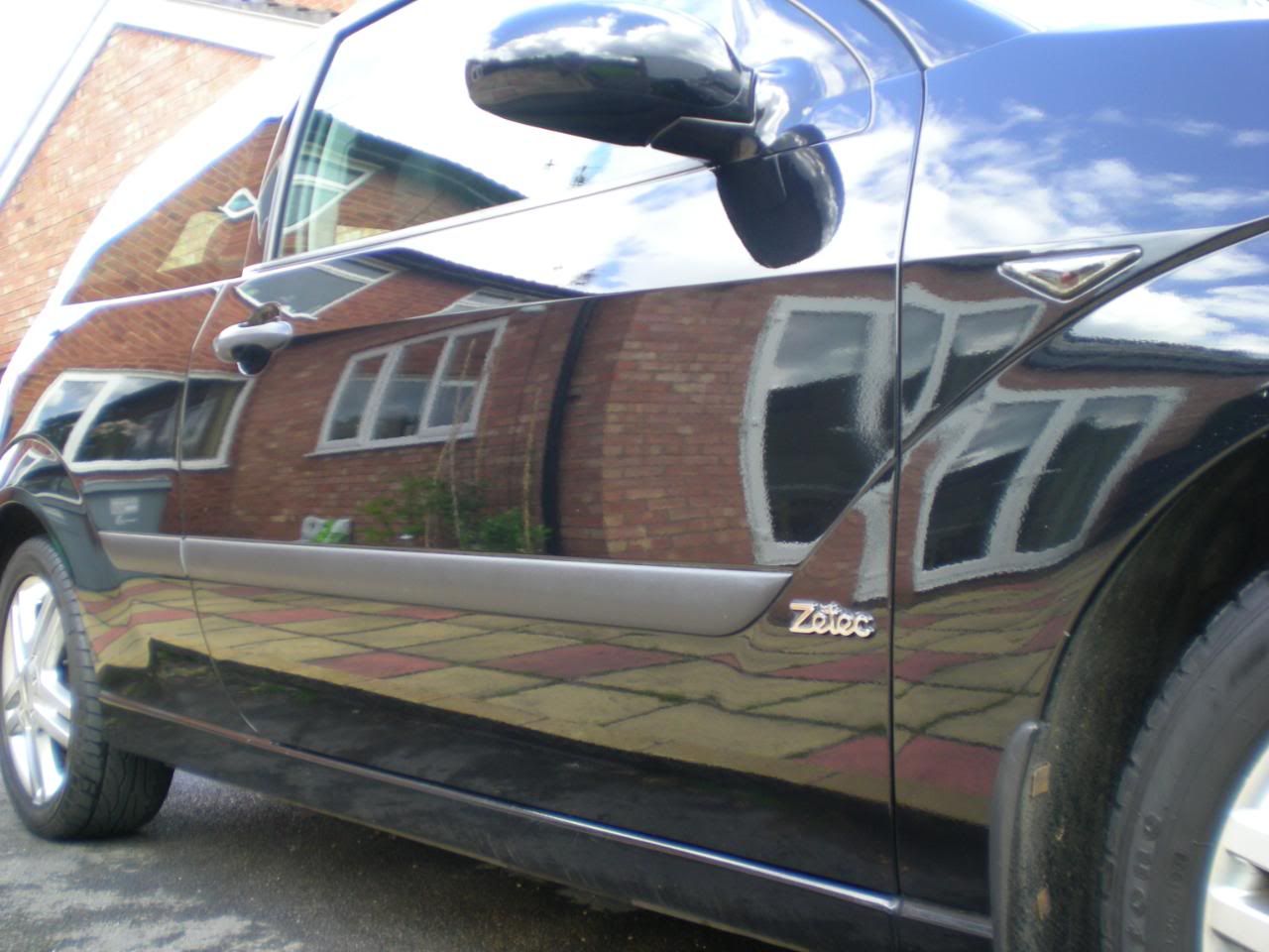

Some finished shots and reflections.
