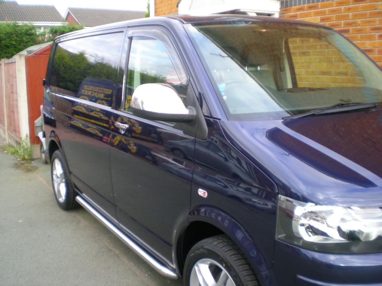

Booked in for a correction detial is this lovely 59 plate VW transporter van in a lovely blue. Don't know if you have this van in the US; it is a common van here in England.
Owned by a member on here, sorry Tony forgot your user name. Who is super proud of his van, which unfortunaly was let down by it's previous life of being washed by a yard brush.
I viewed the vehicle a few weeks ago and reported back and a deal was done. The whole of the botton half was just marred with horizontal scratches in the clear and the top half was mainly swirl marks.

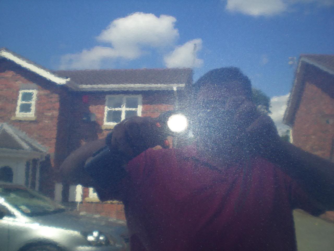

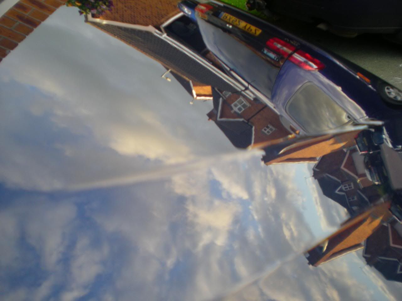

So onto a few pics.

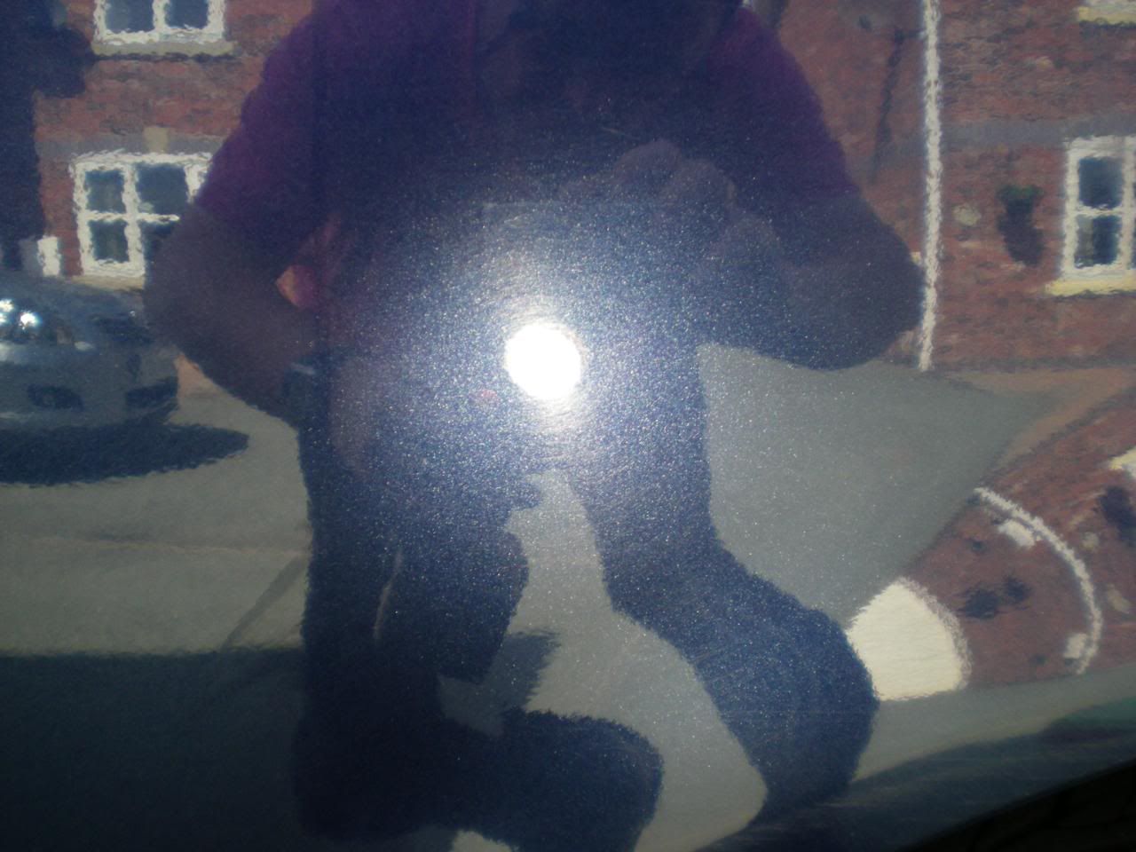

Top panels not as bad.

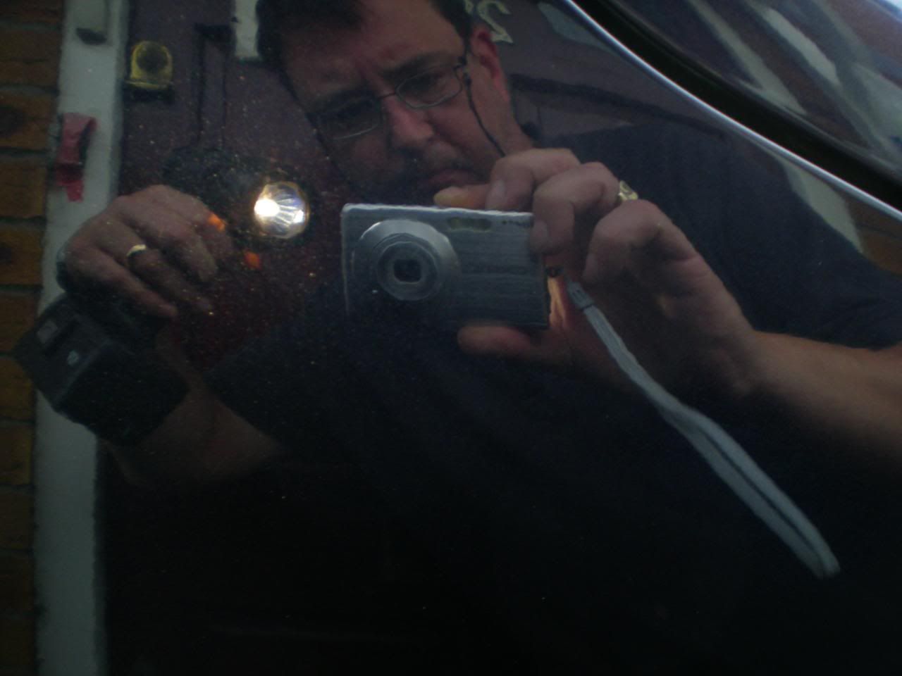

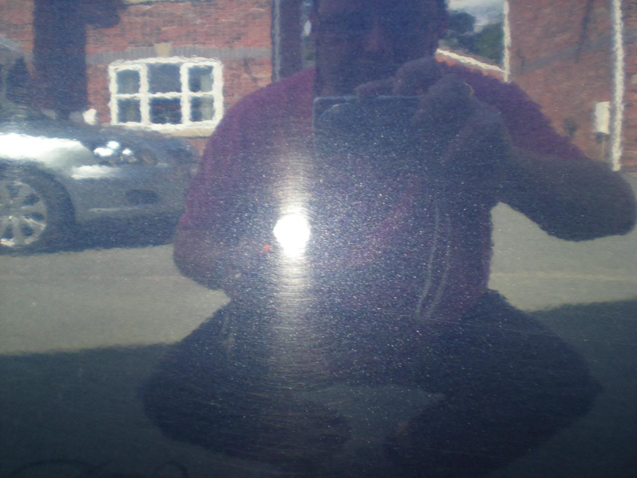

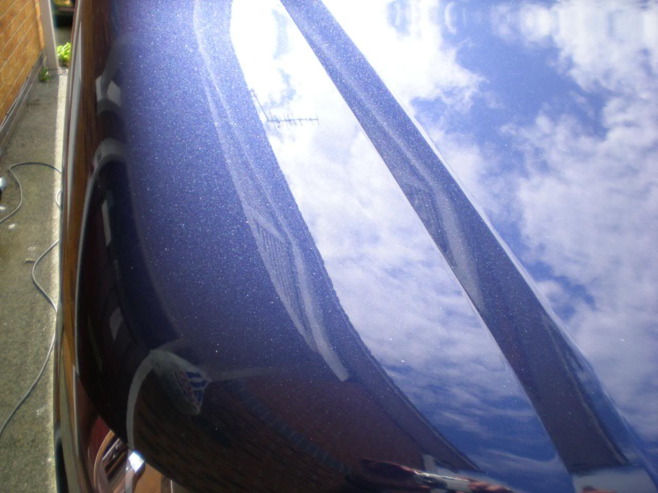

After G3 mopping.
After 3M Fast Cut on wool pad trying to remove G3 marks.
After 3M Extrafine on a yellow 3M pad.

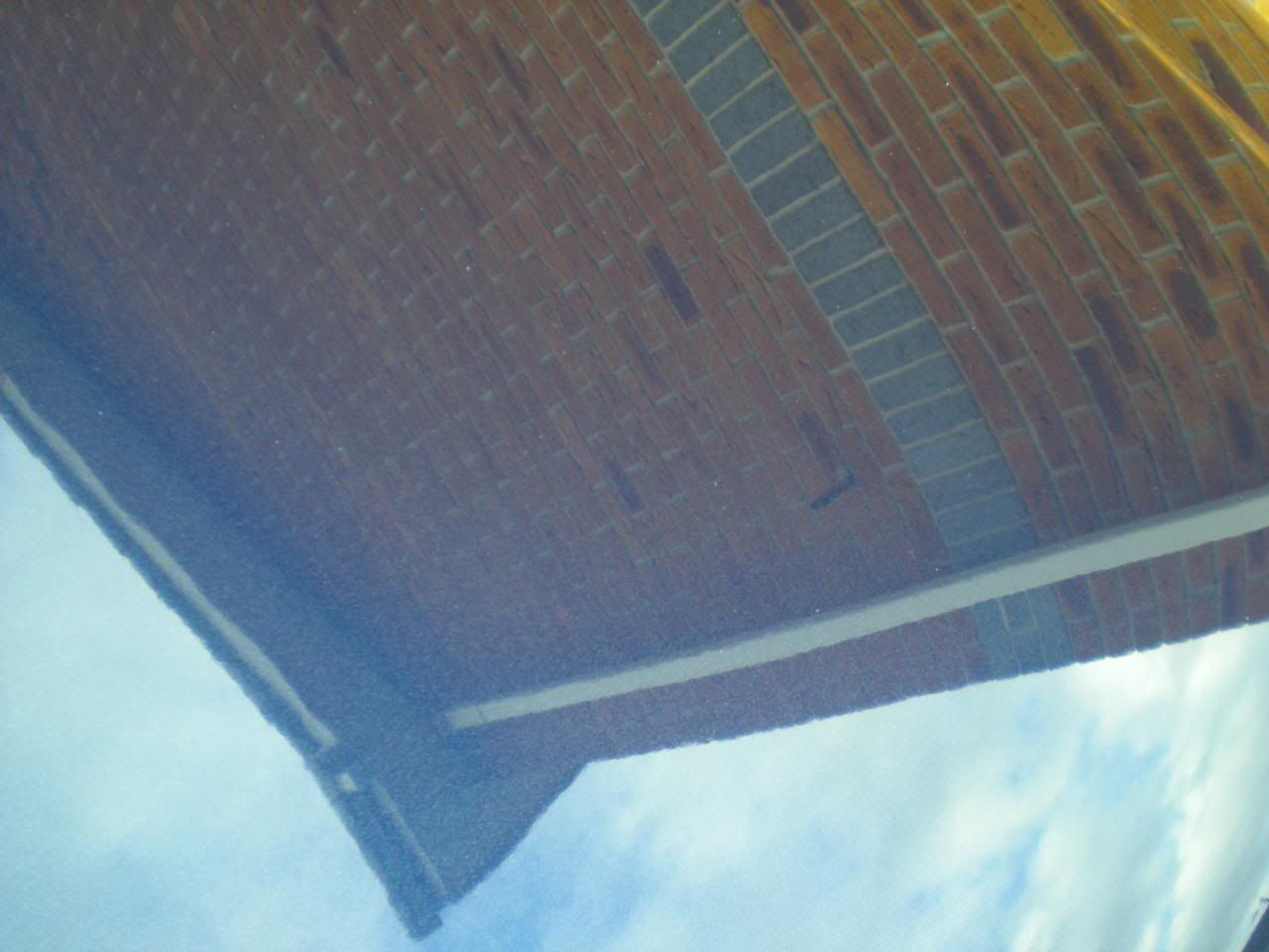

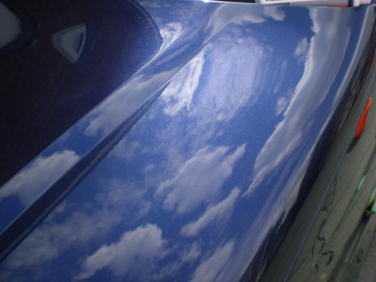

After a stressfull day this was the finish on the only panels I got finished, this is before refining.

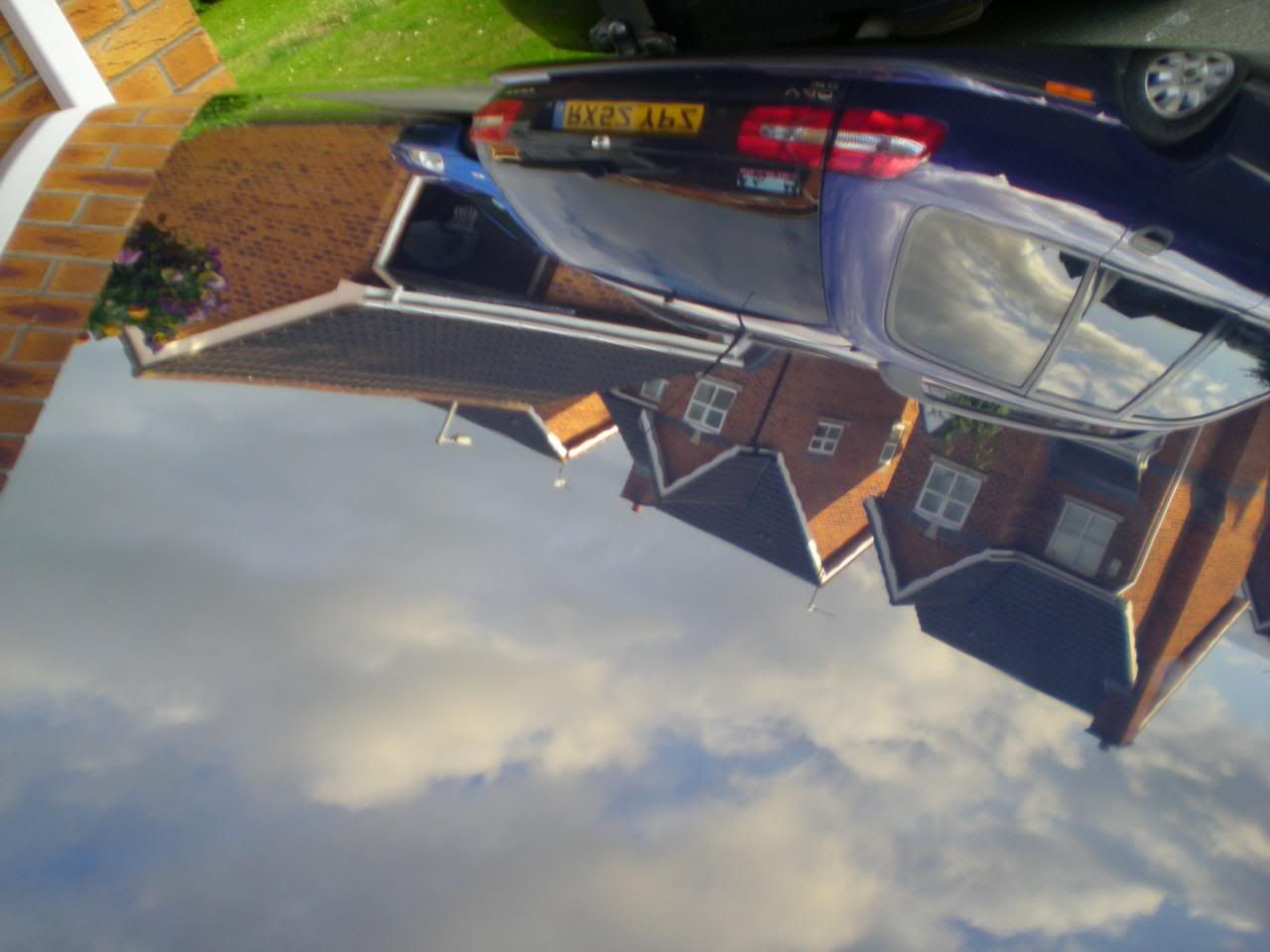

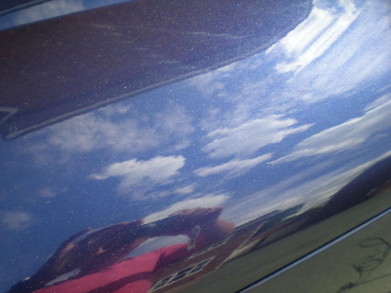

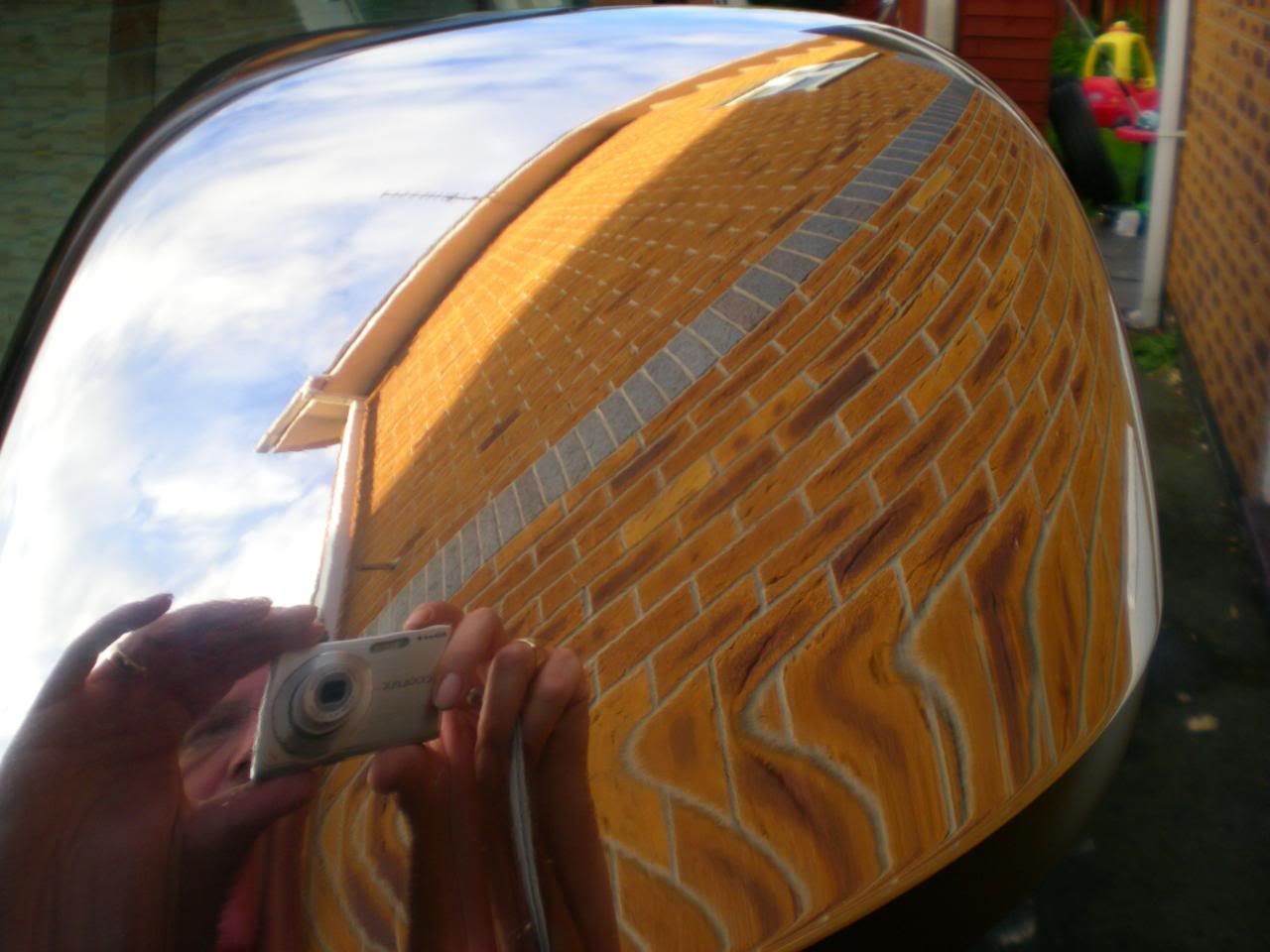

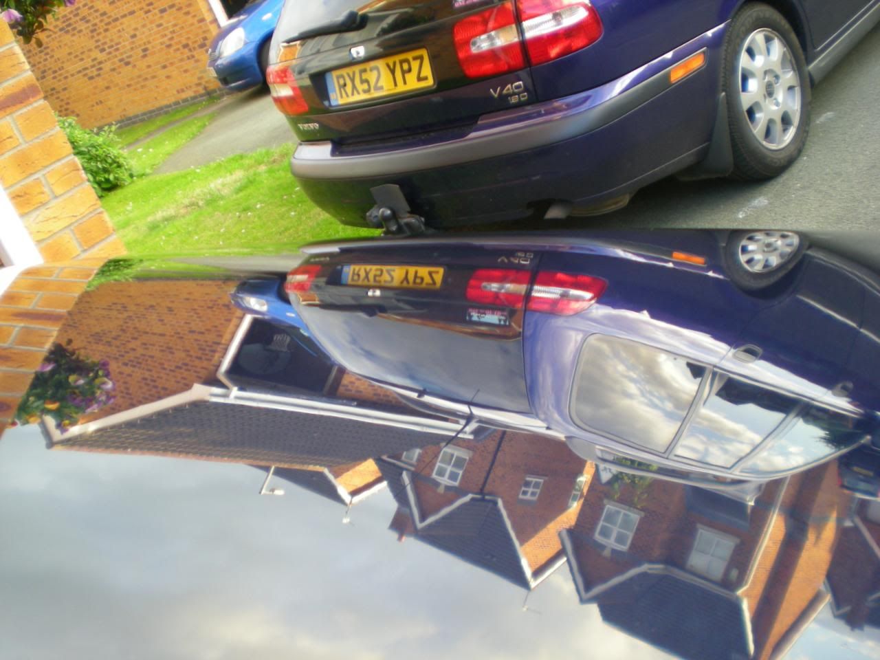

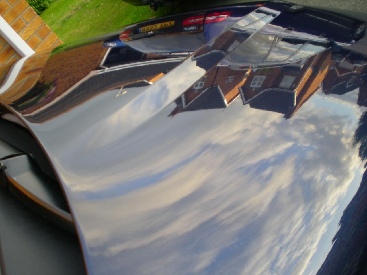

Bonnet after compounding, cutting and polishing.
Metallic flake now popping.

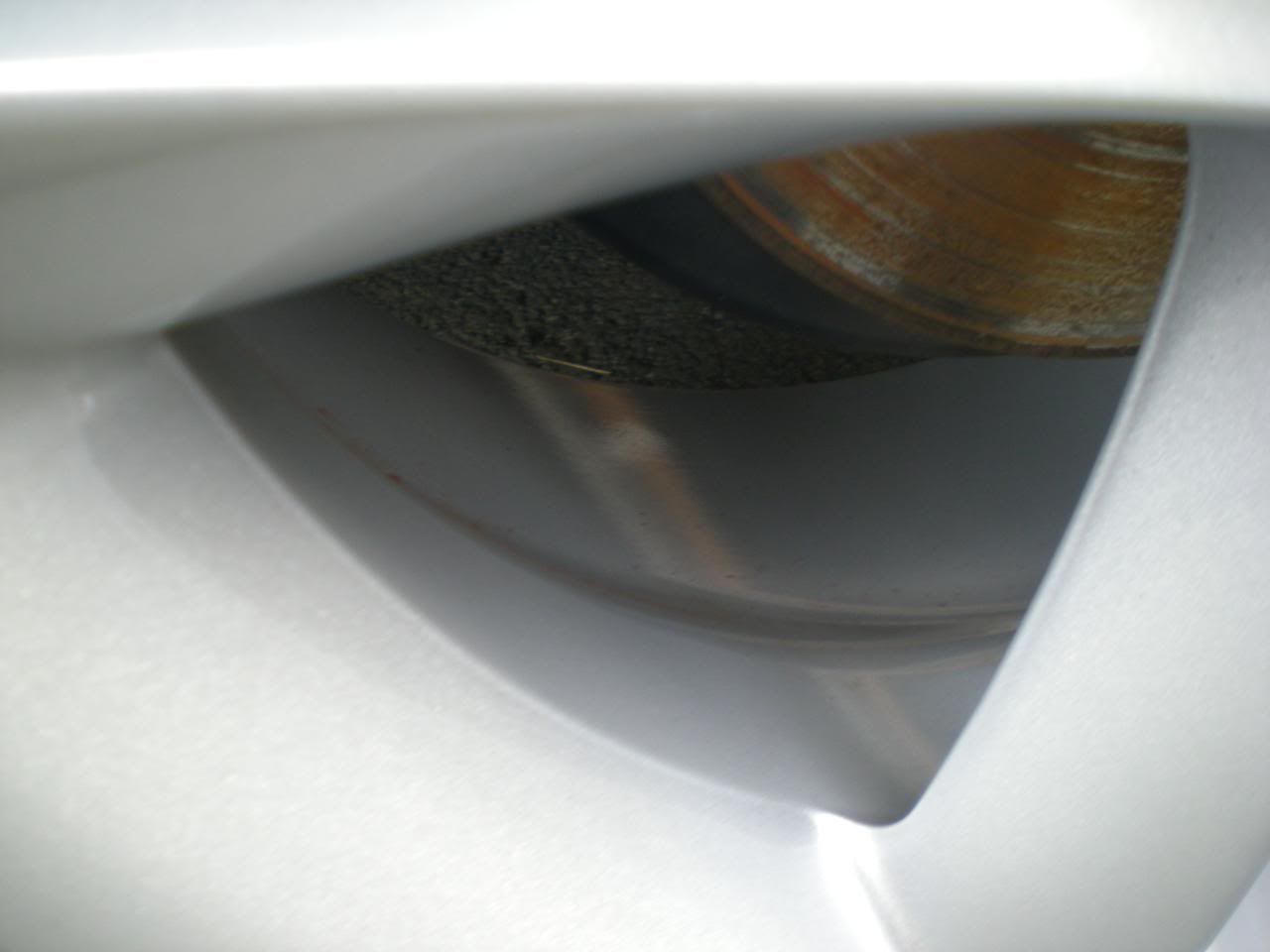

After dinner I decided to attack the wheels. The four on the van were the summer rims so just a spray with brake duster left to sit for 20 mins then a power wash off and a qucik go over with some brushes. I also cleaned the winter wheels that were in the back, they took two hits with brake duster and aggressive clay to clean then, no pics as I did them in the rain.
Plus arches scrubbed.
Wheels came up really clean and the summer wheels were painted and cleared on the rears. gave them all two coats of Opti Seal both back and fronts.

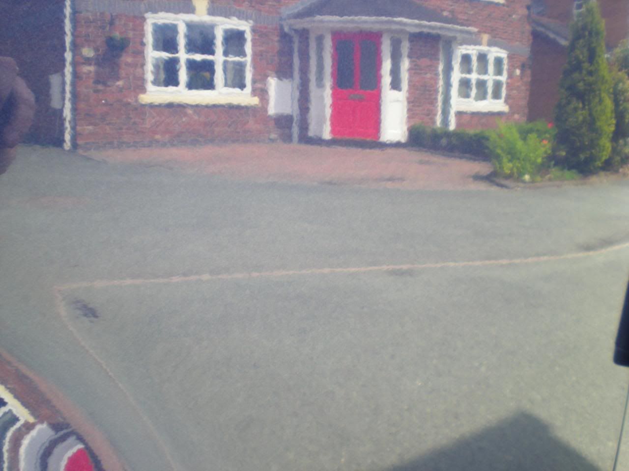

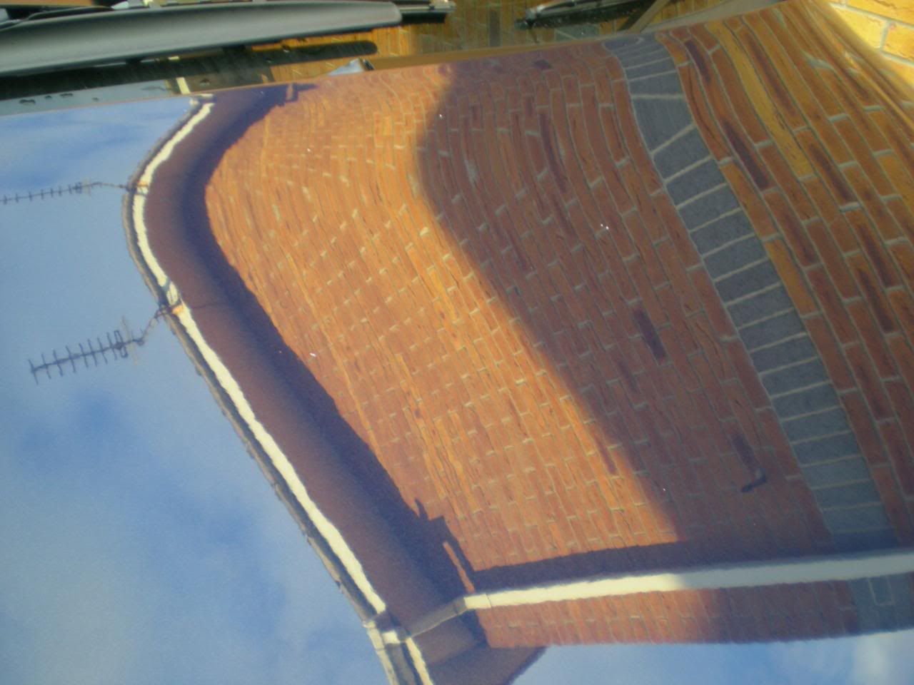

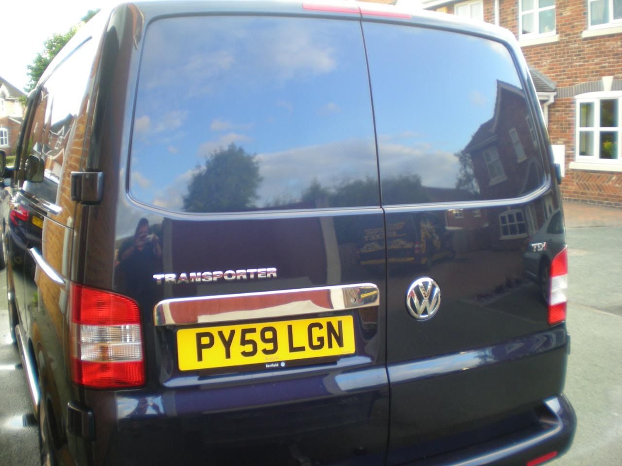

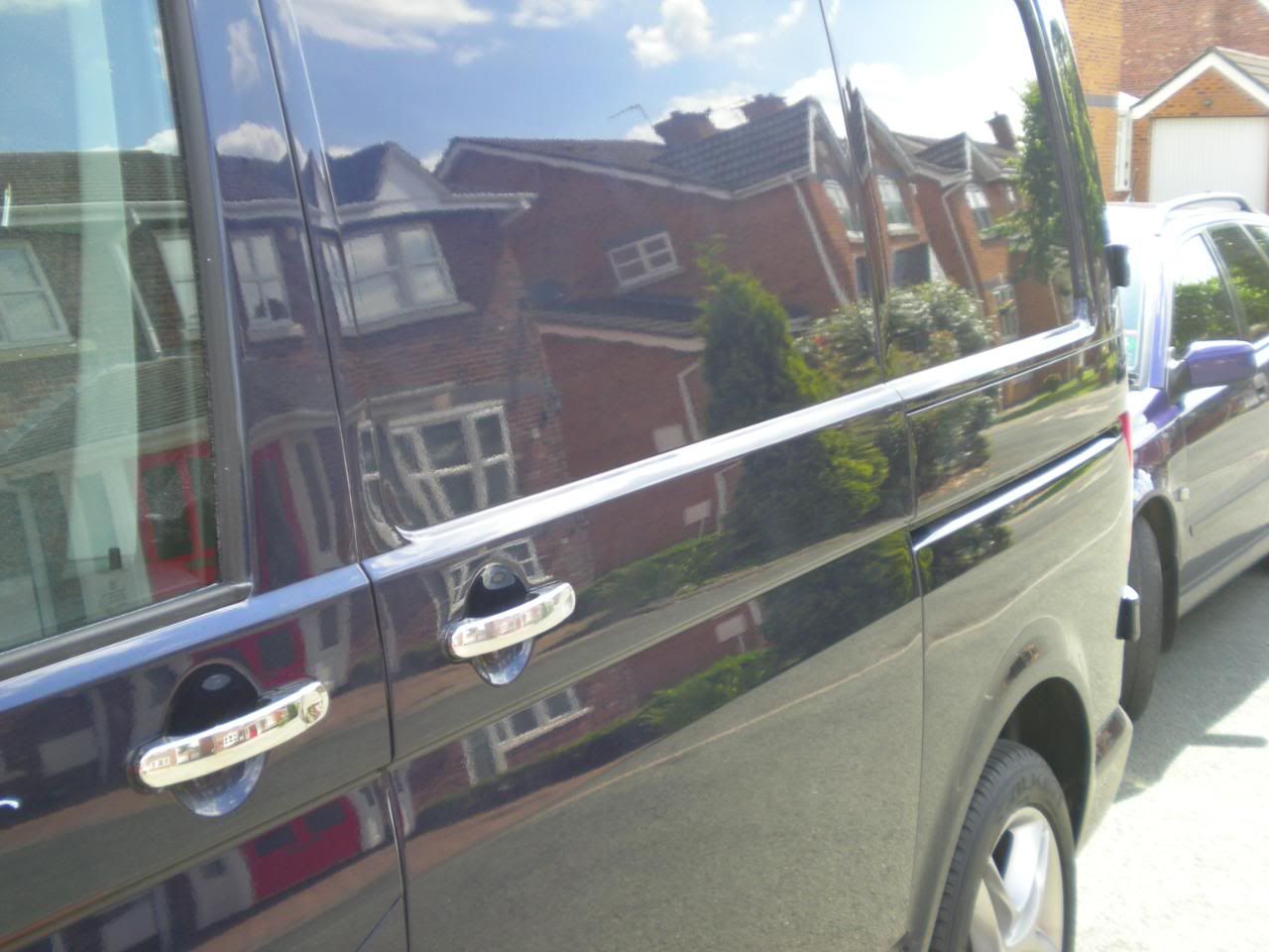

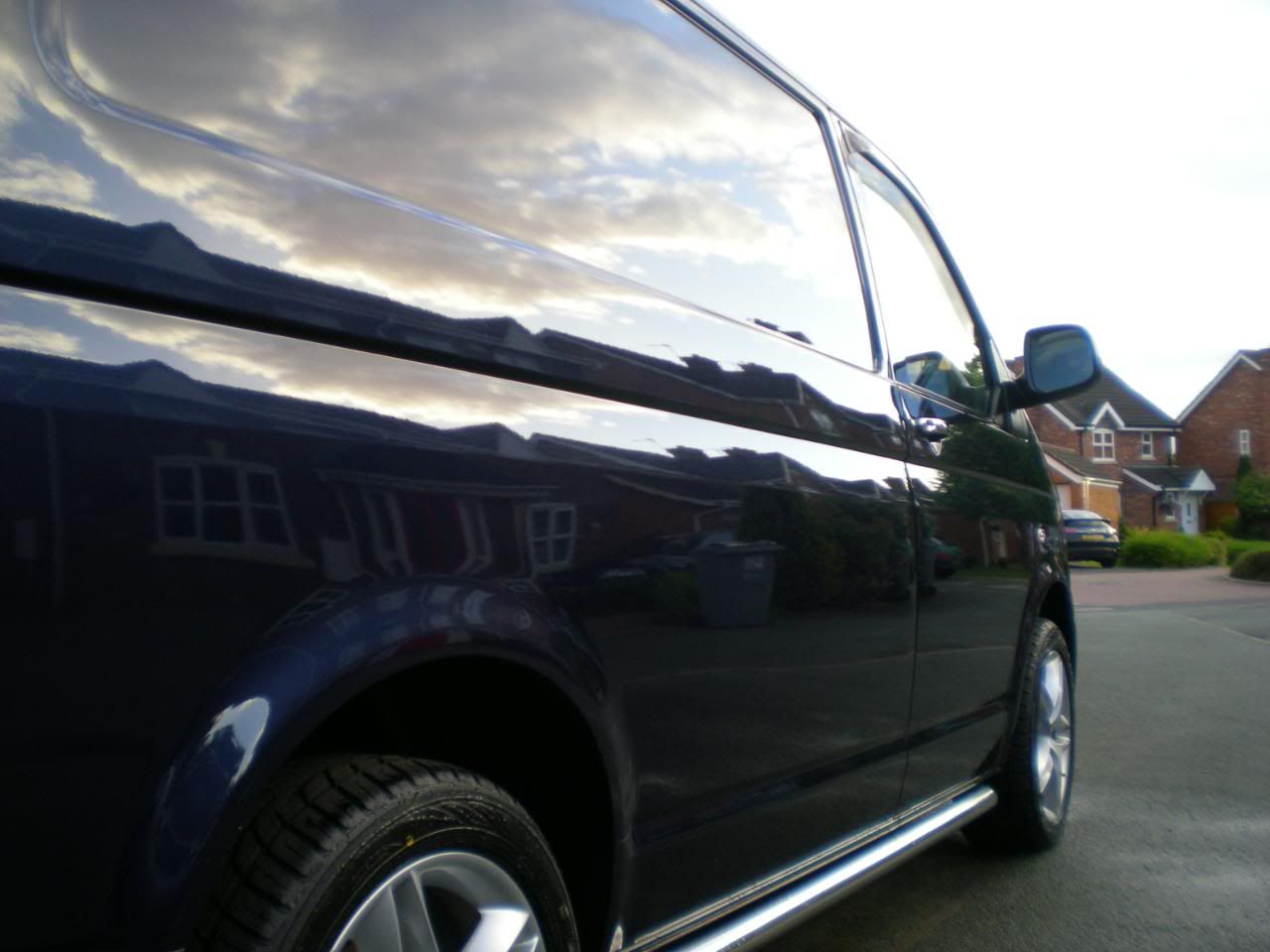

After nearlly 23 hours now these are some finished reflection pics before LSP applied.

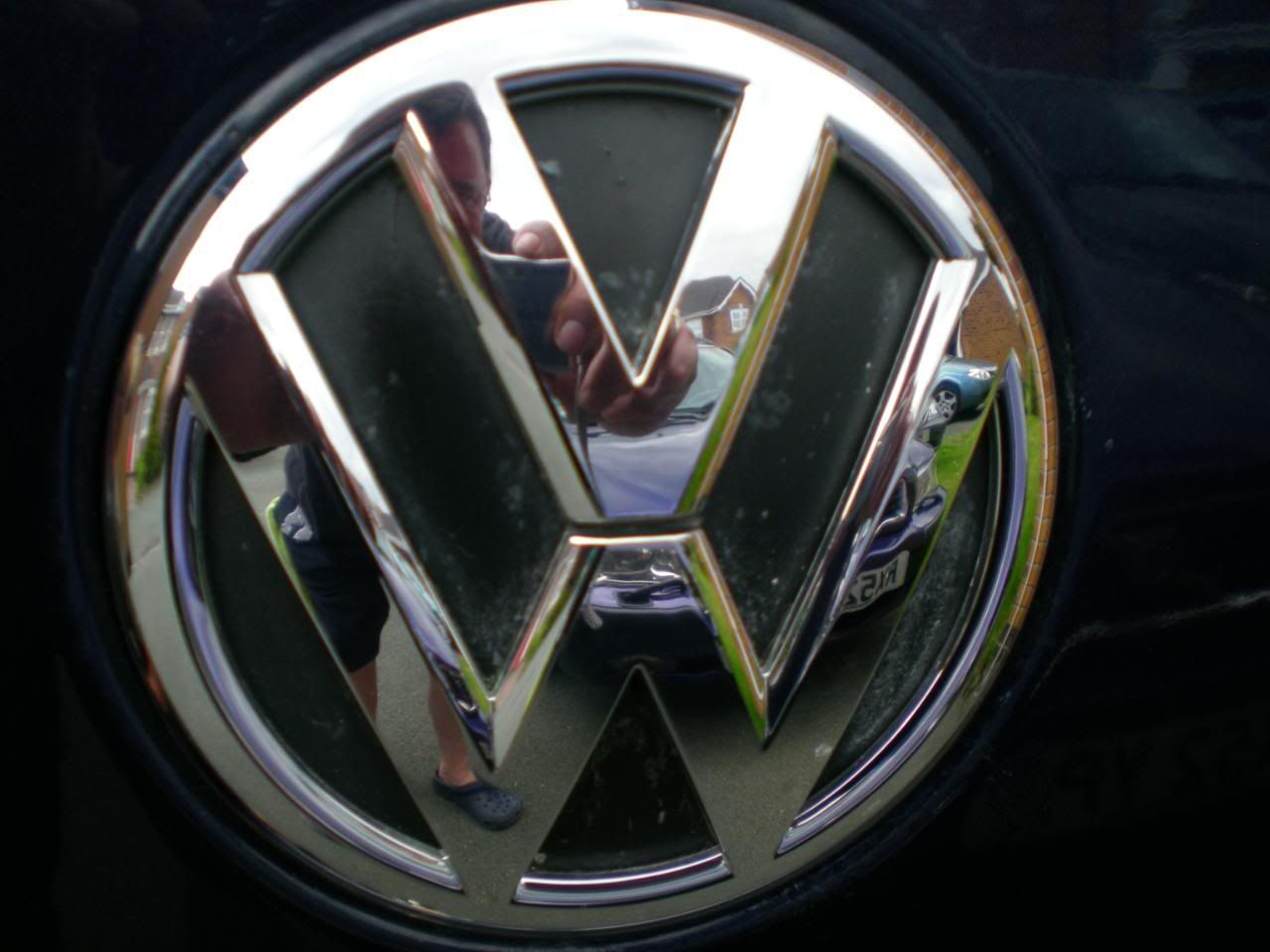

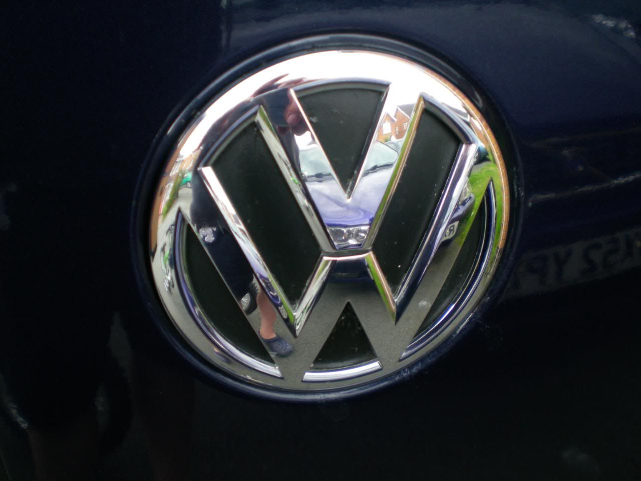

The badge had a fair bit of polish in it.
Cleaned with IPA and Wolf trim guard, not perfect but an improvement.
Wheels Finished.
LSP for the van is two coats of Opti Seal applied and left to cure for 30 minutes. Then waxed with Swissvax Best Of Show given an hour to cure. Then a quick wipe down with Chemical Guys V7 to remove the dust that had settled on it.

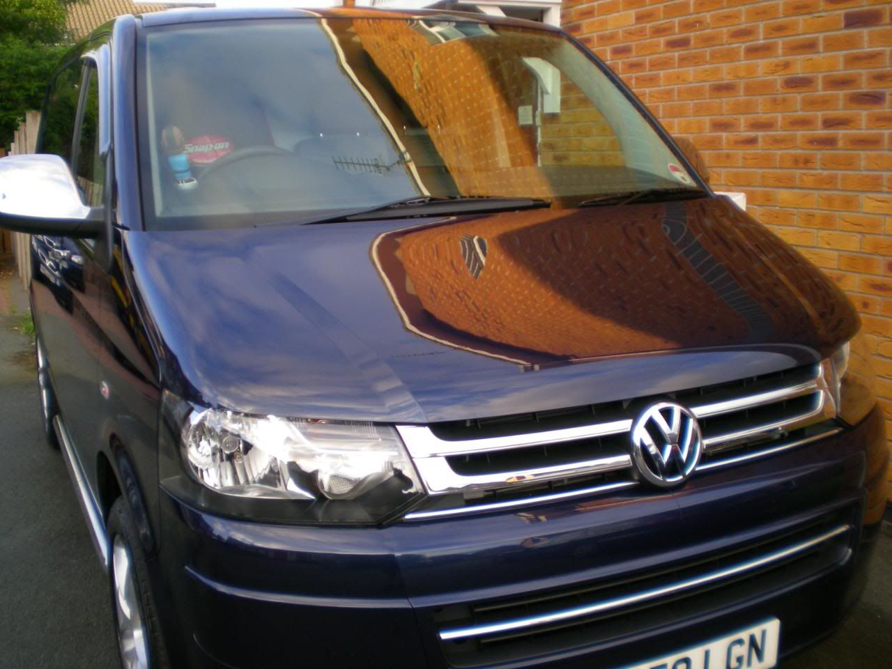

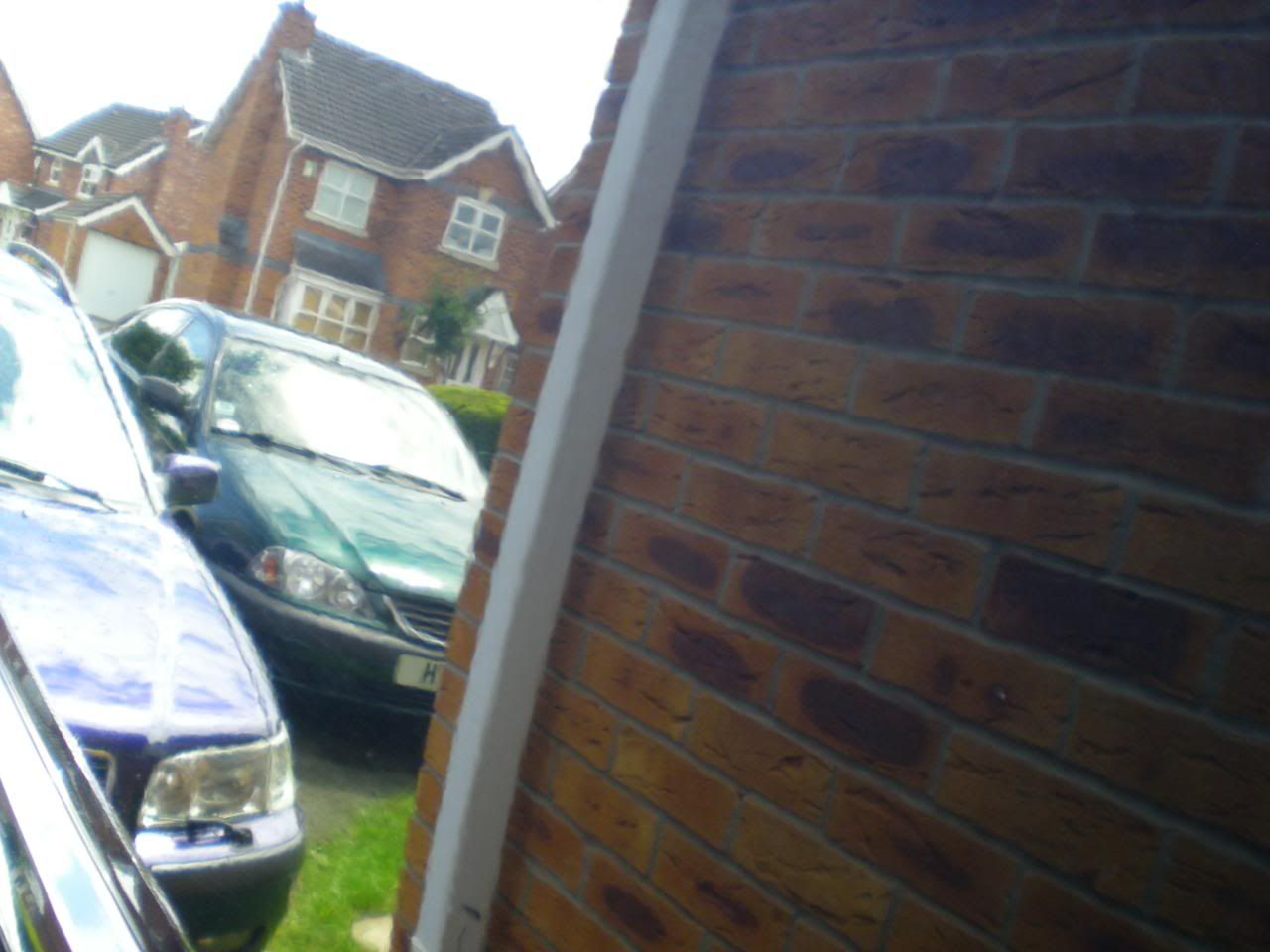

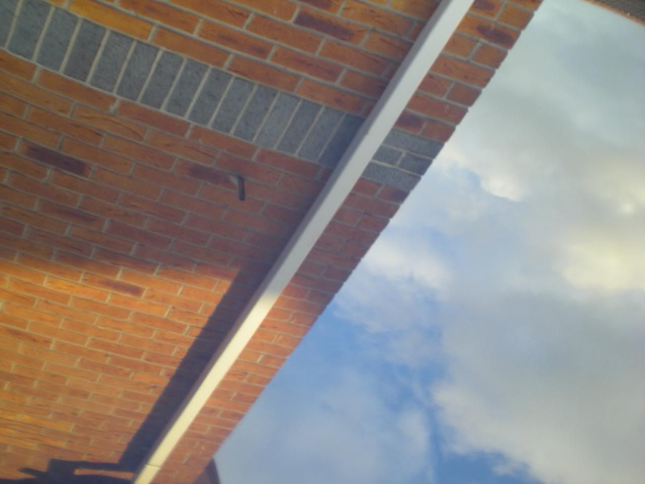

Finished Pictures.....enjoy!!!!
