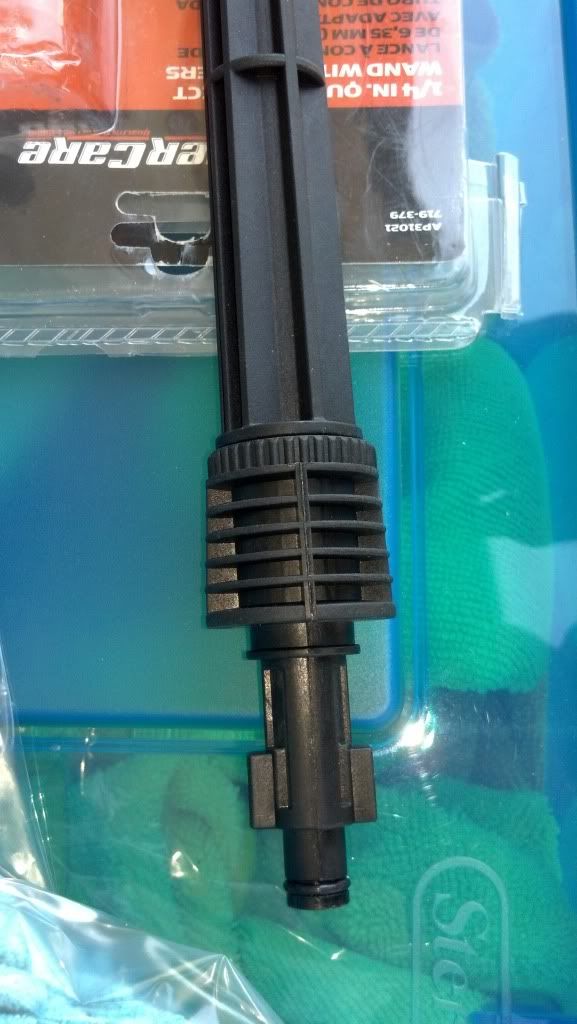

... You can mimic this set up exactly, all you need is to get is the AR Blue adapter(second picture) and substitute it for the Karcher adapter. It looks like that adapter may have came in the set you posted that had pieces stolen out of it.
... If you go this route you won't need a new gun. Just need to get that black plastic adapter and piece of pipe.

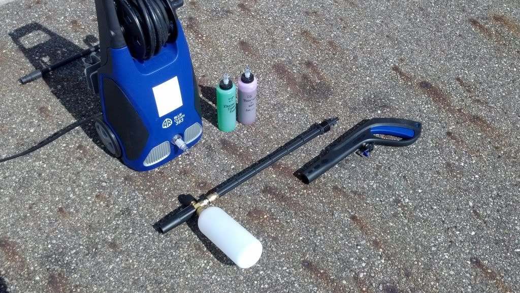

I went with a 3k PSI Troy-Bilt Gas Pressure Washer with the Honda engine and the MTM plugs right onto the end of the wand no extra crap needed. The washer came with I think 6 different tips (I use the 40 degree tip for rinsing the car off), starts right up and puts out SERIOUS FOAM!!!! I will post up pics of my detail on my car this weekend.
I got it from Lowes on sale for $339

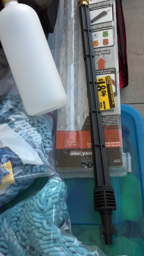

stibuki has offered me amazing advice, and believes that I only ended up needed TWO PARTS to make this all work seamless:
1. AR Bayonet adapter (which I already got in the mail last week) here: A.R NorthAmerica :: Product Details
2. PowerCare 1/4'' Quick Connect Wand kit with adapters here: PowerCare 1/4" Quick Connect pressure Washer Wand with Adapters | eBay
That's it! I don't want to get my hopes up, but both Home Depot and Ace Hardware sell the wand kit, although I won't be using any of the included adapters that come with it, I'll be using the wand, which is all that matters. So, there's a chance after all I might be using my AR383 + MTM Foam Cannon today on our next detail project, a 1960's Ford Fairlane!

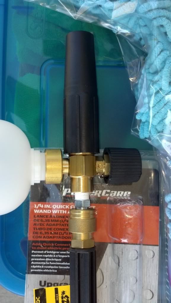

IT WORKS!!! Details coming soon, along with pictures and a review :)
THE REAL FINAL REVIEW
Long story short: I got it to work! (enter roaring applause and collective sigh of exhausted relief) Booyah! :)

5. The AR Blue Bayonet Adapter that was part-one of a two-part jigsaw puzzle making this all come together in harmony was a plastic chintzy chunk of crap that DID NOT PROPERLY FIT into the AR Blue spray gun, which was the whole point of buying it in the first place. This single issue makes the entire setup a draining aggravating experience, I have to wiggle it, twist it, press it, and yank on it 10 or more times every time I set it up to make it feel somewhat secure and stay attached, or else it just PLOPS out when I pull the spray-gun trigger like a water dart. UGH

I went to Home Depot to buy the Power Care adapter and wand kit, and since the back was slashed up I took it up to customer service and asked if they could please discount it for me? They said sure, they may be able to take it all the way down to $10, which I thought was AWESOME. It is normally a $20-30+ piece everywhere, even online, so I was pumped, because all I really needed anyway was the wand. Well, the associate disappears and talks to someone who I assumed was her manager behind a cubicle wall, and then I thought to myself "Shoot, now since I acted so happy about the $10 price tag, she's going to come back and tell me she can't honor that deal."
Well, she DID come back up and give me some news alright... she said, "Well, since this item is a clearance item, we've decided to go ahead and sell it to you for........... ONE CENT!" Haha, she even gave some dramatic pause! I freaked out with joy, it was THE ONE SINGLE LITTLE THING good that happened during this entire AR Blue Clean Model 383 and the MTM Hydro Foam Cannon debacle, so I was pumped.
I looked in my wallet, and didn't have cash since I don't carry it. The lady said to me, "Oh, don't worry about the penny... I'll borrow it from one of my co-workers!"
HAHA, so I got the final piece needed for this all to "work" out........ FREE!!! I walked out laughing about the whole thing, what a riot! Thanks for the one awesome experience out of my last 20, Home Depot :)
