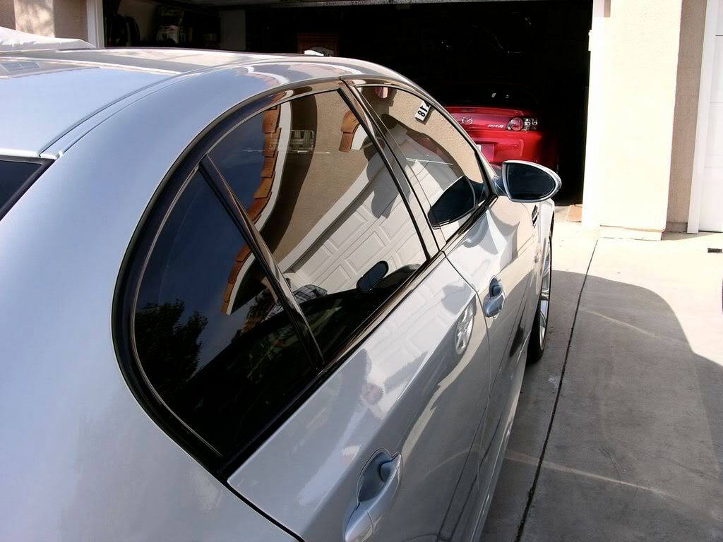

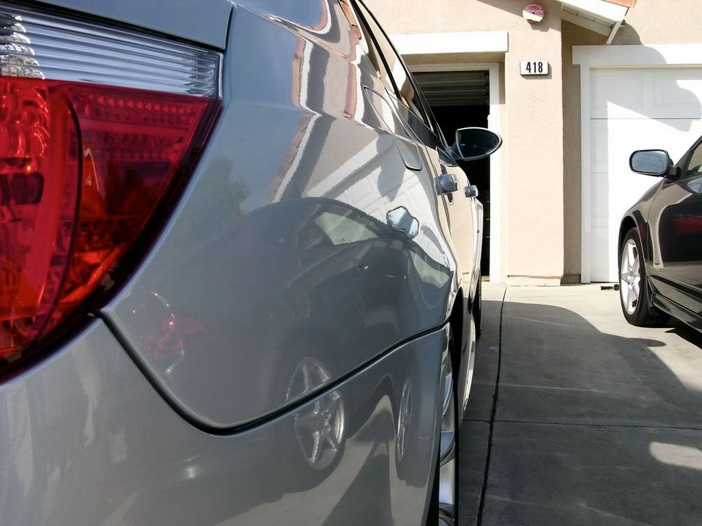

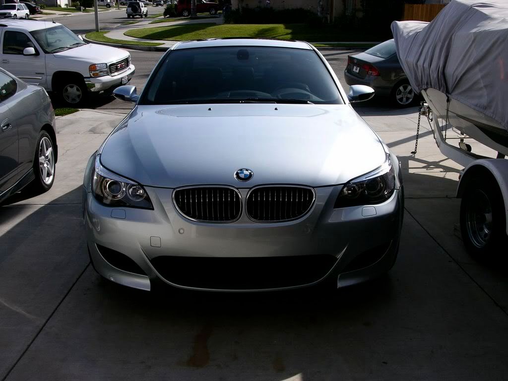

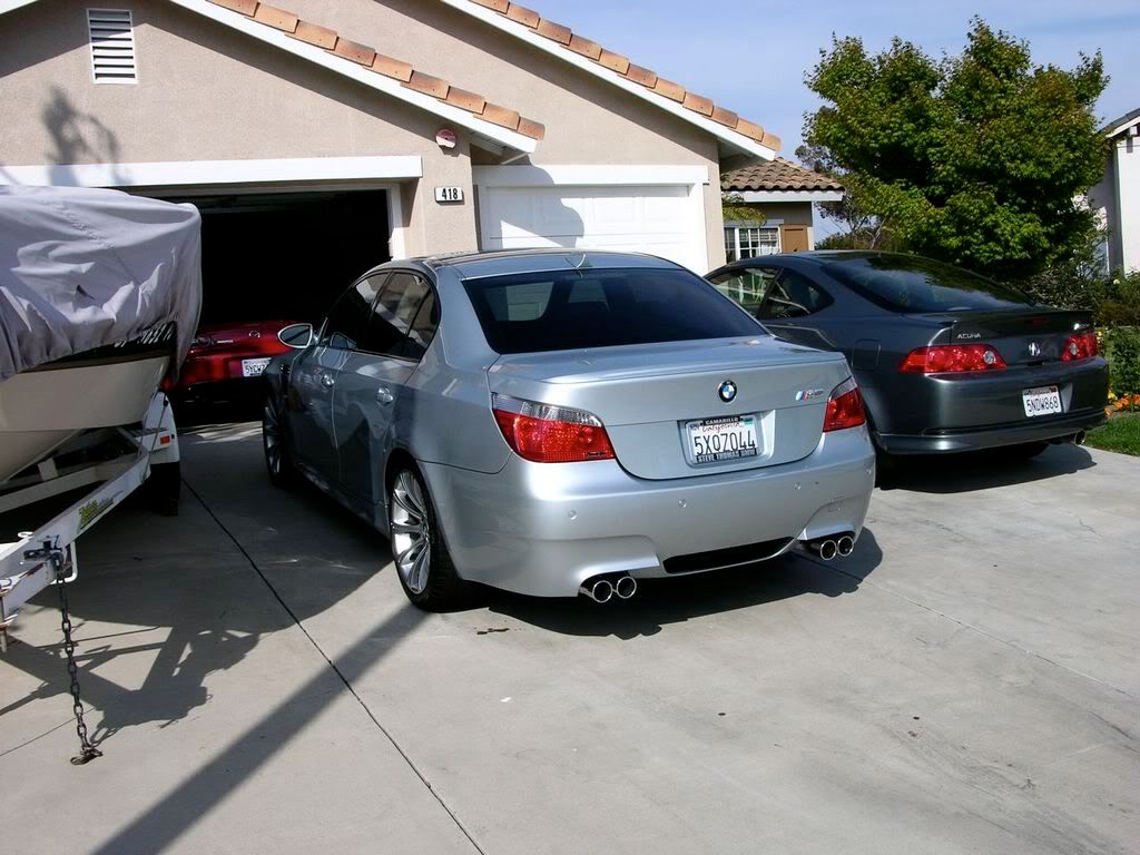

so on sunday a friend of mine heard that I've been really getting into this detailing thing so he asked if I would like to detail his 07 M5....yes a newbie on an M5......
the Process is as follows:
-sprayed car down with water,
-then used a citrus degreaser on the front and lower panels (diluted 30:1.5)
-degreaser on the wheels as well
-washed car with Pinnacle Bodywork shampoo
-scrubbed wheels with brush and soap
-rinsed
-dried with Guzzler (thing is amazing)
-clayed the car (used Meguire's Quick Detail)
-then on a few scuffs and small scratches used XMT 3 and 1 (with PC), all gone!!!
-topped with XMT glaze and gray pad
-sovereign OH YEAH!!!!!
-crystal misted some slight streaks,
-windows done with stoner's aerosol
also used the 2 bucket method, and cobra MF towels,
here are the results after about 6 hours
and on a side note.....I drove it back to him.... (he was working) this thing HAULS!!!!!!!!!!!!! especially in 500 horsepower mode.... :D :righton:
Feed back please
enjoy
