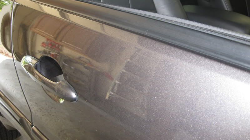

I received some SSR1 @ SSR2 on my last order and my darling wife prompted me to try it on the ugly scuff mark that I created on the Mazda. Yes, she was sure to point out that I did it.
I got up the courage after reading and watching the video and took the challenge. After all, I'm a pro painter so I told myself the worst that can happen is a repaint of the door.
This scuff was a result of a backer board(ceramic tile board) that was leaning against my Mazda without my knowledge. Really, it was. I backed out of garage and...oops
Considering the scuff, I started with the SSR2. Light pressure.

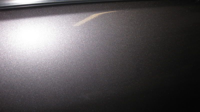

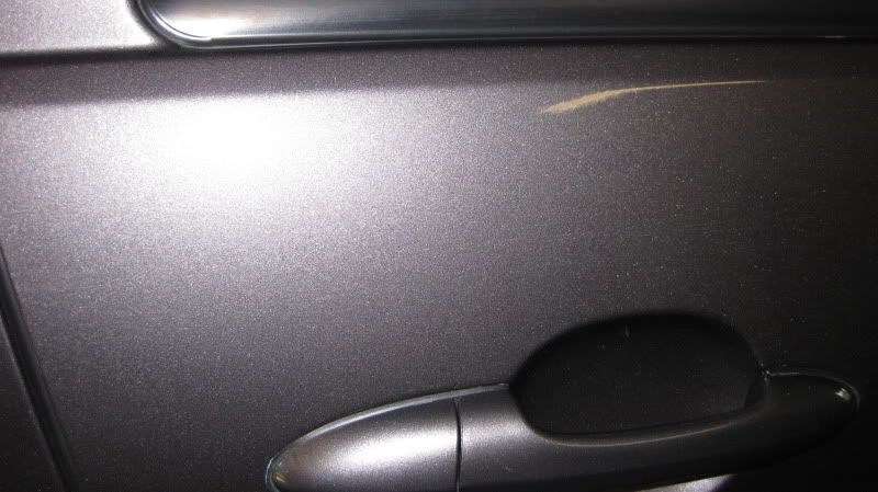

Before

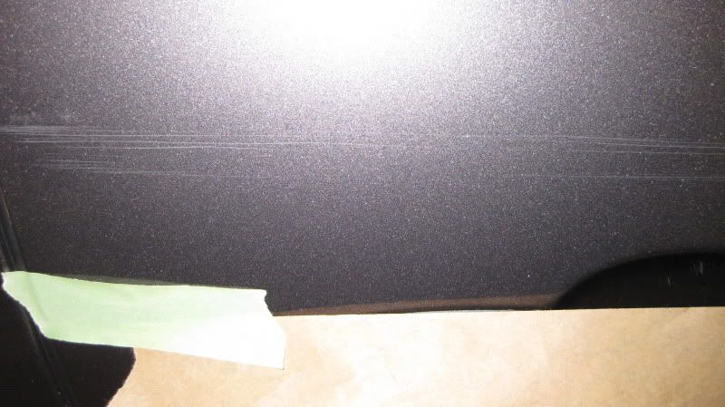

First Try consisted of about 8 very slow horizontal and short vertical passes. SSR2
Scuff is barely visible now.
Second pass same as the first.
