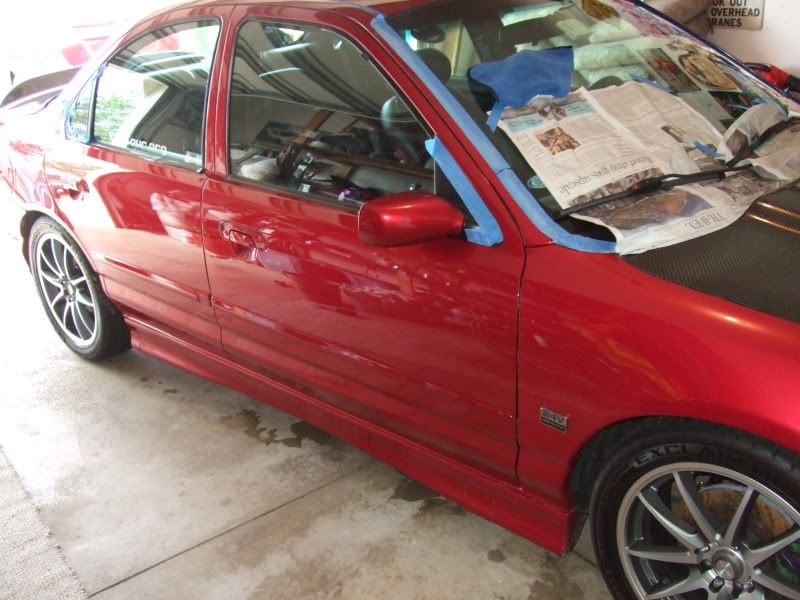

So I started off with Meguiars car wash, 3M Perfect-it III Clay, and Meguiars Hot Rims
Pulled in to the Garage for the rest

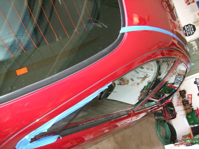

Trying to get rid of some water spots/oxidation
I broke out the PC7424XP, green foam pad, and a polish that will remain nameless and got to work. Speed 2 to spread the product, speed 5 to polish
On the fly pad cleaning

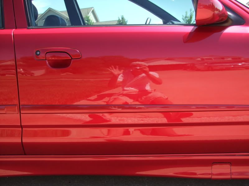

After reading some on Autogeek, I HAD to track down some Meguiars #16!! It was a lot softer than I expected it to be considering it came in a tin. I put it in the fridge to thicken it up a little, as soft as it was I would have wasted a TON of product and probably would have put it on way too thick. I applied the #16 with a black foam pad and speed 3 on the PC. A little goes a long way with this stuff!

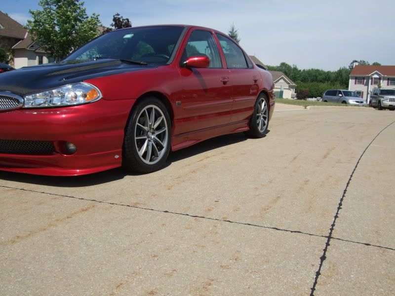

Finished up and ready to show off!
Hello Autogeek!!
water spots GONE
Thoughts, well Im in LOVE with #16!!! I need some different lighting to take better pics, my LED shop light wasn't working very well. I should invest in some smaller pads, currently using all 6.5in. I have used my PC maybe 5 times, still learning new things as I go. My car has 161K miles, paint is orginal except the front bumper.

It was Chemical Guys 3n Nano Polish. It doesnt like humidity, it started getting dusty on me and its work time was cut in half. Once the wind started blowing and the rain was on its way I found it a lot easier to work with. I used it previously on a 2009 Lincoln MKS and a yellow pad, figured I would try my luck with a pad that wasnt as aggressive this time
The paint didnt really have any defects/swirls/etc. So 50/50 shots wouldnt have showed much. I will say the reflections are a lot crisper, and not as blurry as they were before.

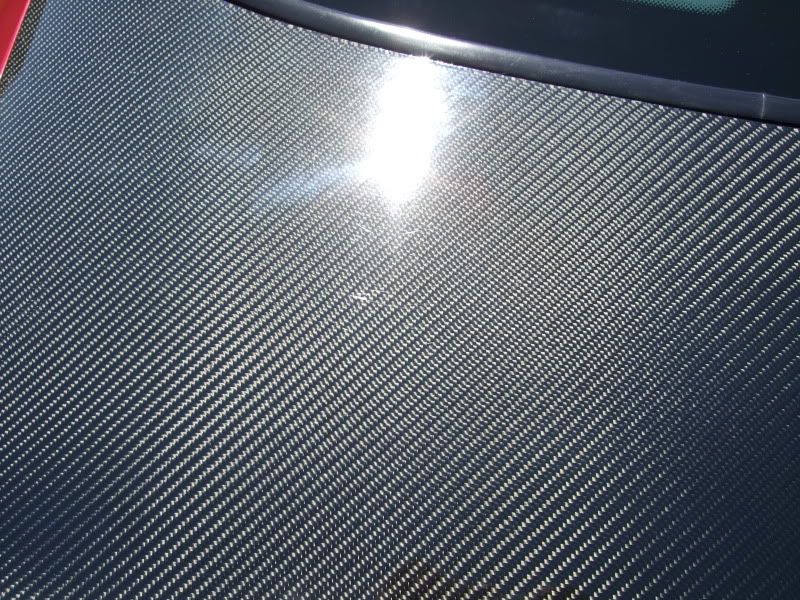

You made that SVT look great. I also love that carbon fiber hood it has. Great work. :props:
