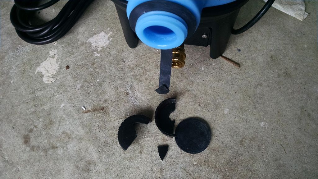

The unit was not purchased through AutoGeek. (I have always received excellent customer service from PBMG in every interaction.) The unit was on sale through another vendor. The timing and price was right. Here is the cap as it arrived to me:
It definitely looked like it could have happened in shipping or even in the original packaging of the unit. I called the distributor immediately. They simply asked me to email a photo of the broken piece and they would send out a replacement. I received it very quickly. It was not Mytee that I dealt with.
The cap does include a thin gasket as seen in the photo but that still doesn't seem to seal it off. I have not spent the time to investigate it closely but I'm pretty sure I can find a solution to this issue. If it was my only problem with the unit I would not have made an issue of it.

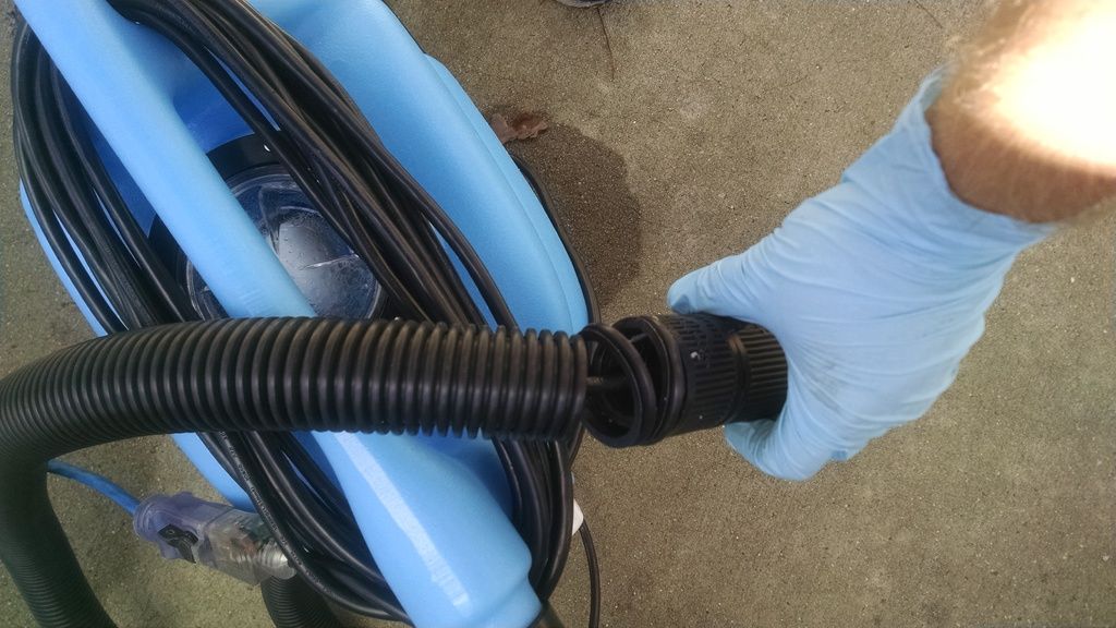

This is the hose as it was the first time it came apart. The same problem has since occurred in other locations on the hose.
As you can see the hose is a single long string of plastic that has an "S" shape that allows it to interlock on itself in a tongue and groove method in a spiral assembly. The plastic material is rather thin and flimsy and relies on the "S" form for structural support. A simple pinch of the hose with just a little pressure can cause the inner groove to slip out and compromise the structural integrity.
My first thought was that I had somehow kinked it and, being near the coupler, caused it to break. I simply used a razor knife and cut the broken end off, reassembled and kept going. I received the unit in winter and tend to avoid doing heavy carpet cleaning when mobile unless I have enough time to ensure the carpets are dry before I leave, which tends to be more problematic when temps are in the 40s. I managed to use the unit a few times before having more issues with the hose. The unit sat unused for a while and then I tried a few things to fix the problems to make it functional. I had the unit for about 3 months before finally contacting Mytee directly through their website.

I have looked at Lowe's and Home Depot for a replacement hose. Neither the shop vac hoses nor the pool hoses are the proper fit. I'm sure I can find a hose of the correct diameter that will fill the need, however I should not have to do so on my own. At this point my issue is as much with the total lack of customer service as with the poor quality of the materials.
