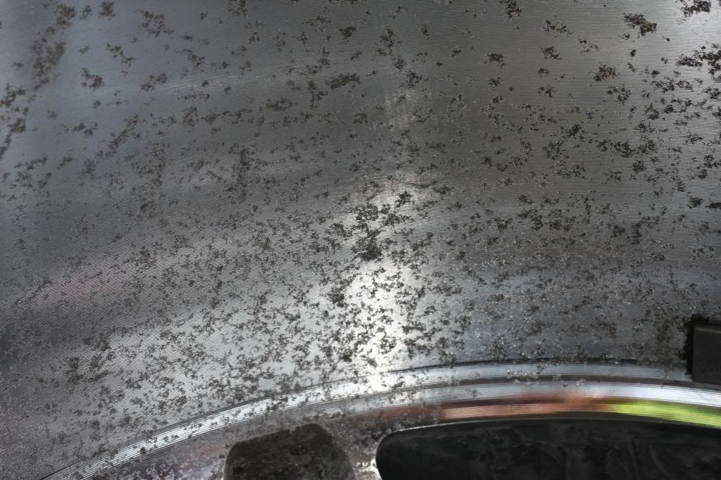

Hey guys, just an update on the wheel barrels. I finally got a chance to work on them again yesterday and went at the fronts which were worse than the rears I did earlier. My goto product combo ending up being steel wool with moistened Comet. The krud cutter was strong enough for the hard dirt but didn't have the extra bite for the stains and rust. I'm pretty sure I have the wheels as "clean" as they're going to get without taking the next step.
What I'm running into now is that all the "dirt" is off but the rust/corrosion pitted the aluminum giving it a very dirty and cheap look.
So when you look at it from the face of the wheel you can clearly see this pitting which annoys me. It doesn't look as bad it does in person due to lighting but you get the idea.

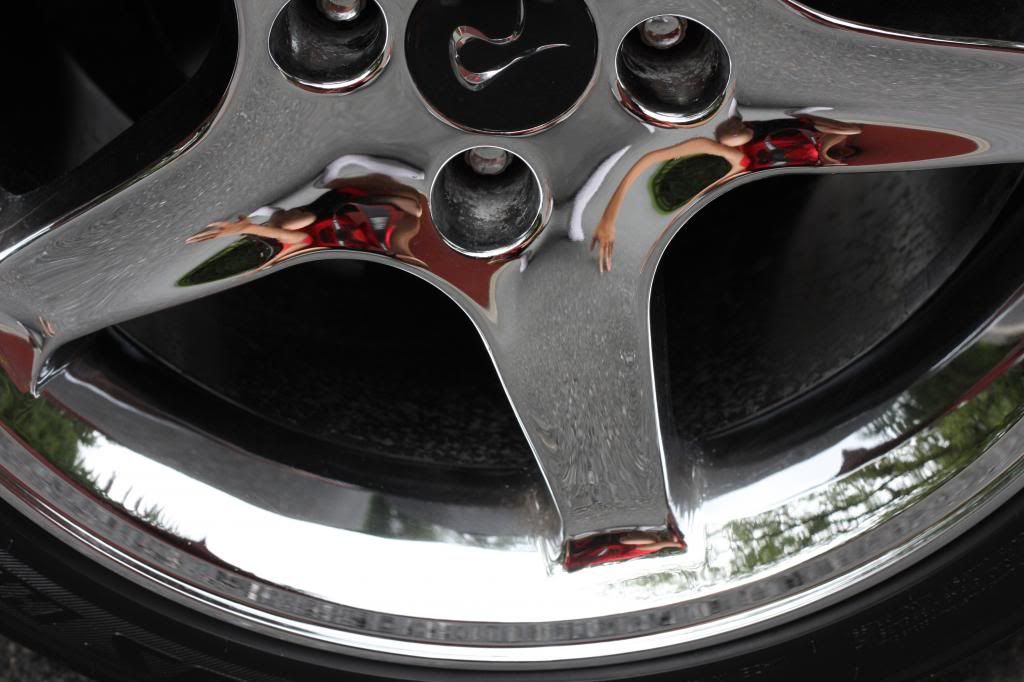

Also, if you notice the rust around the lugs I did not touch those with anything aggressive other than sonax and a brush and that's what I'm left with. Does anybody have any ideas what I can do with that area. The only reason I'm afraid of touching that area is because it is cleared chrome that got rusty and not just polished aluminum like the barrels.

Ok, that's kind of typical IME for the backs not to be painted. You've got corrosion pitting (not rust, iron rusts, aluminum doesn't). Sure you can sand, prime, and paint that, the primer should fill in what's left of the pitting after you sand. Or you can try and sand and polish and hope that gets all of the pits out.
You say the fronts are "cleared chrome" which isn't a usual approach. Usually there is chrome, or the wheels have been polished and then cleared, not both. Is the damage in the lug nut holes the same as the back of the wheels (as shown in your closeup)? Because it looks different.
Okay, the pits just look a little deeper than what paint could fill in from my experience. My guess is they're about 1/16" deep at some places. That's why I mentioned about using a body filler of some sort to smooth out the barrels. And on the "cleared chrome" comment, I just thought by looking at it there is a clear on it for added protection but if you say they generally don't do that mine probably aren't cleared.
As for the lug nuts it appears to be similar corrosion but not as rough/severe but you can clearly see a good amount of scratches and corrosion in the same area. What would you recommend to tackle this? Thanks
Yeah you could use some glazing putty, if it was me I'd prime and sand, and prime again.
As for the lug nuts it appears to be similar corrosion but not as rough/severe but you can clearly see a good amount of scratches in the same area. What would you recommend to tackle this? Thanks
If it's chrome plate, the only thing you can do is metal polish it (which may not fix it). If it's polished/cleared in there...that's going to be a little tougher. If the paint is compromised you'd have to either polish down to the metal and shine it up, and hope the transition line to the fronts isn't too noticeable, or polish and re-clear and hope for the same with the transition.
