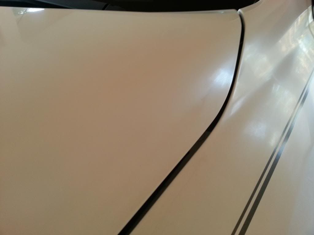

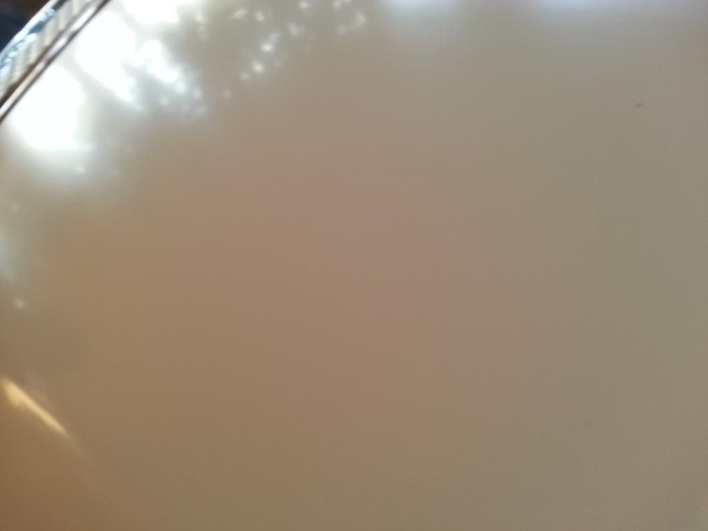

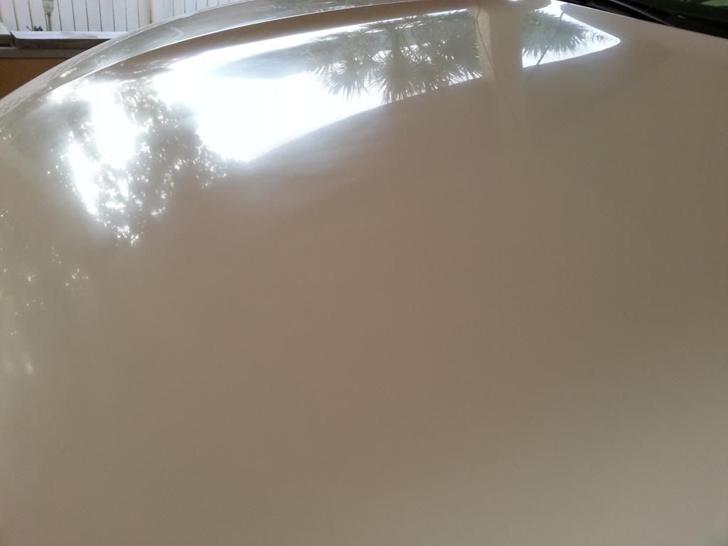

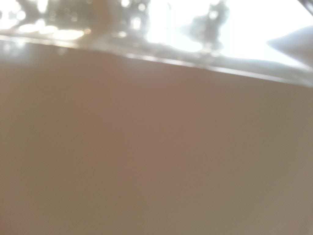

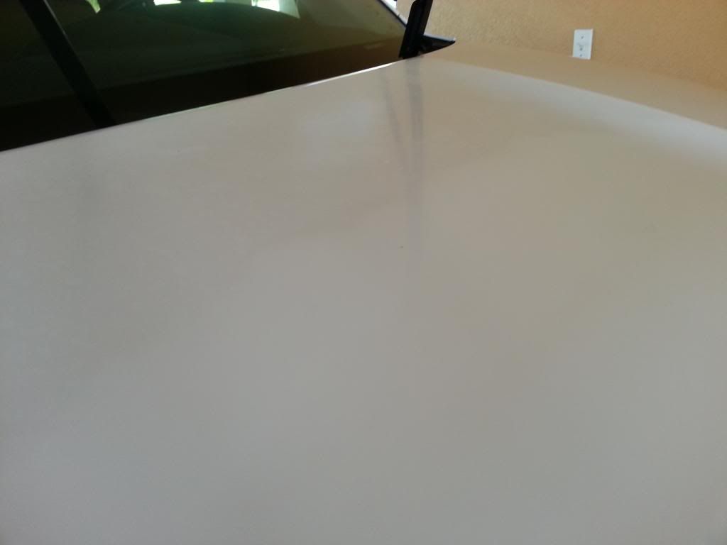

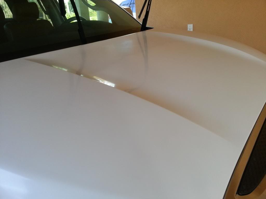

Hey guys I need your help I'll try and make this quick. PICS BELOW
HAZING IS THE PROBLEM
Washed Clients truck
Clayed
Griots Pre wax cleaner wipe down to remove anything possibly left behind after claying
Then used XMT360 AIO w/ a white pad
You can see in a few of the pics where it was cleaning up nice and the up near the hood was still untouched.
When Finished I noticed a bad hazing effect all over.
Now Im not saying this was all me the truck sits outside and they live on the water. So Salt Air from the Gulf has def taken its toll on the paint a lil bit and there was some light oxidiation look and light haze on the hood after washing and claying.
I thought this would clean it up.. It did not.
Yes the pad was primed w/ XMT360 and 2 sprays of water
Client was Understanding Since I had just finished his MINI Vert and Cadillac SRX and they both came out amazing.. Pics up soon
But I told him I would need to check to see the best way to remove this hazing... Do I need a different pad color should I be using ORange or Tangerine?
Should I use Meg's Ultimate Polish Instead?
I really want to remove this hazing but Im not quite sure how.
sorry the pics didnt turn out as great as I wanted them.. You can really notice in pic 1 on the side what the hood is doing.
Thanks for your help... Going to Correct this on Monday
PICS
Almost looks like it get sanded. I've never seen something like that from outside elements. First this is first and do a tests pot with the least aggressive product. You can determine two things, how hard the paint is and or product and pad combination. I'm not too familiar with Meg's uc compound. I can tell you that I am familiar with Meg's 105 and 205. These two products can pretty much correct any paint on the market( w/ combination of the right pad). If your in a time pinch pick some fg400 and use the least aggressive pad and you possible can finish down lsp ready:)

Just be smart and use your judgement. If I was in your position I would be looking for clarity in the paintwork more so then correction ability......on the topic of products, I have not used either Meg's uc or the other products you stated but I can guarantee you will get great results with the 105 205 combo.

The whole truck doesn't look like this. Well a few sections on the side do but not near to this degree and it was already like that.. Nothing I worked on. I simply washed and clayed and did a spray wax on the rest of the truck after noticing the hood. I will include a pic of it finished from 3/4 rear..
Just the Hood and Front Fenders... I honestly figured it was just due to all the salt air and being outside never garage kept for the past 5 years.
The only section I worked on was the hood.. At first it looked as though the xmt360 was cleaning it up nice.. You can tell in the pics from the front of the hood vs the rear closer to the windshield that is still dirty. When Finished I stepped back looked at it and noticed the strange haze that was still there.
