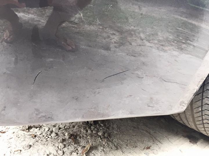

I had two deep scratches on my bumper from a dog jumping on my car (I'll attach a photo) on my brand new 335i (With only 1,200 miles!) and I took it by the BMW dealership so that their touch up guy could fix it for me. I was under the assumption that he would fill it with touch up paint then wet sand and compound/buff. I did NOT want the bumper sprayed.

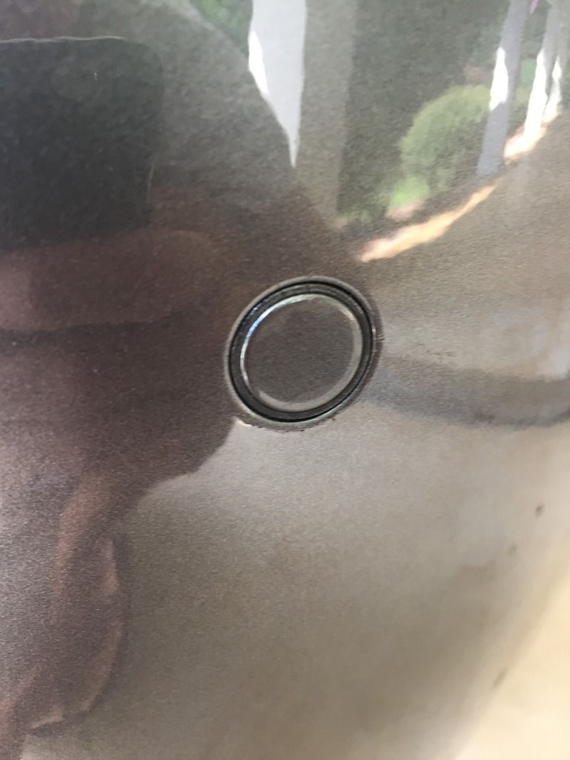

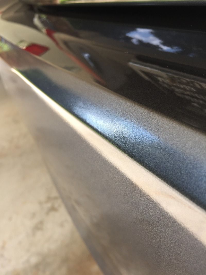

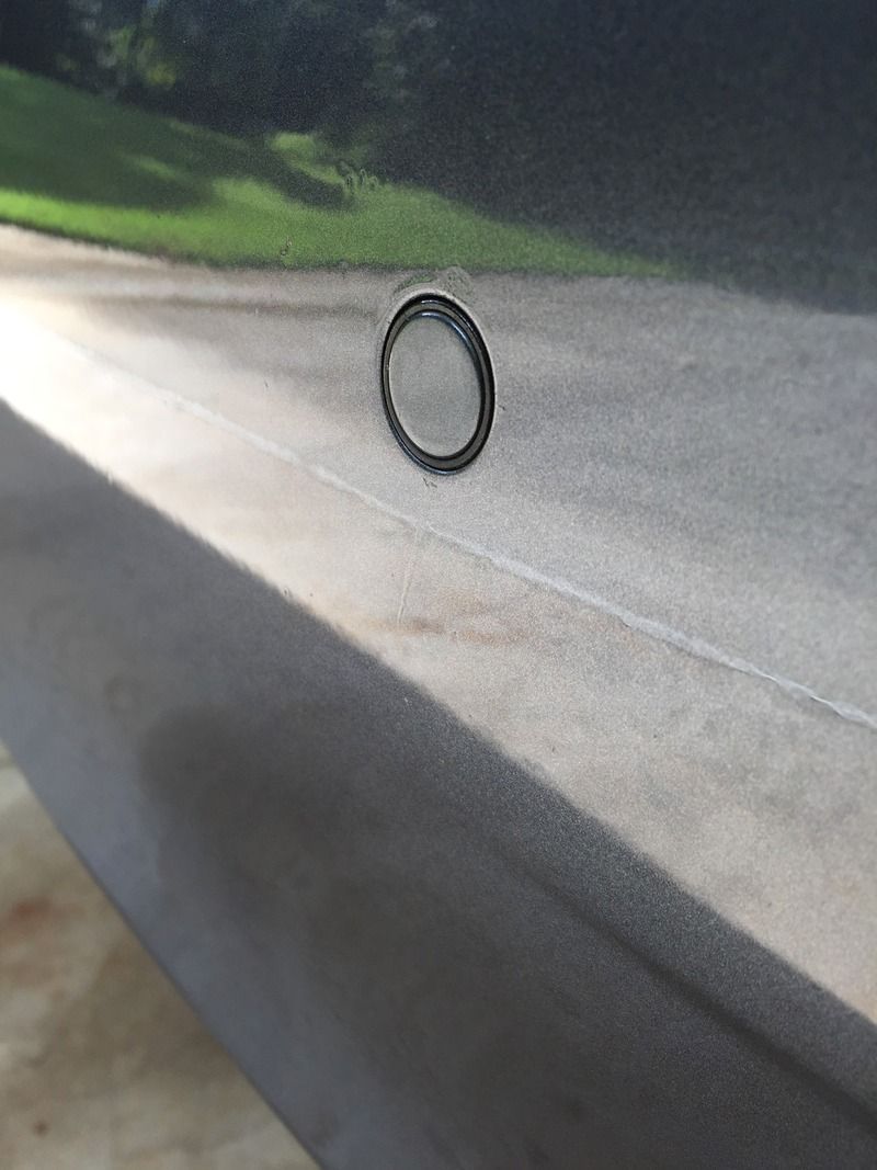

To make a long story short, the clear coat has places that feel like over spray, and one place on the edge of the bumper is very cloudy/orange-peel looking. There are nibs here and there and around the sonic sensors it looks like the clear just needs sanding (not really sure).
My question is, could these clear issues I'm having be addressed with wet sanding? I'm hesitant that it can't be fixed. I just want it to look like nothing was ever done to it!
Photos of the clear after he sprayed:

He did a real quick and sloppy job.
99% of people would never see it.
Looks like now it needs to be stripped and re-done. Just be glad it's new. Find a GOOD body shop.

Someone ELSE should be able to make that look a whole lot better with wet sand and polish. Im not sure its a strip and respray.

From the looks of your pictures the work just looks bad, but I would just wait until he finishes the job and see where you are at.
