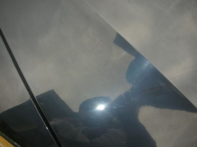

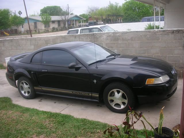

Hey guys, hows it goin. I just recenly bought a used '00 mustang, and the paint on it looks like it wasnt properly cared for. The whole car was pretty dirty when I got it. i noticed after I washed it that the paint's finish or clear coat looked pretty dull, almost matte-like. I washed it and used some meguiar's paint cleaner on it, and I got the car's clearcoat looking shiny again. After I finished, I noticed it has quite a bit of small scratches and swirl marks (as you can see on the last pic). So here's my game plan for next wash.

My question is, should i go through with the above, or is there something that might do the trick better for really bringing back the shine in this used car? I am also doing all this by hand.
Swirl marks
Faded clear coat before paint cleaner
your going to have limited success with hand ... really need to consider a machine.
I personally would suggest washing ... claying ... paint cleaning (to remove oxidation) .... polishing (abrasive polish) .... then protecting.

The PC is a dual action polisher and is very safe. It is the rotary buffer that you have to be careful with. I agree with the rest that you should get a PC to remove those swirls and to keep your car's appearance in like new condition. As Killerwheels likes to say, "the only way you can hurt your paint with a PC is if you threw it at it." I hope this puts your mind at ease. It is extremely safe even for an absolute beginner and it will work wonders on your car's paint finish. :) Good luck to you. :)

absolutely in my humble opinnion get the PC. I too was scared at first, but if I can use one without doing damage, anybody can. I tried by hand first and got nothing compared to using the PC. My paint was worse then yours and I used the XMT line for the polish. Good luck.
