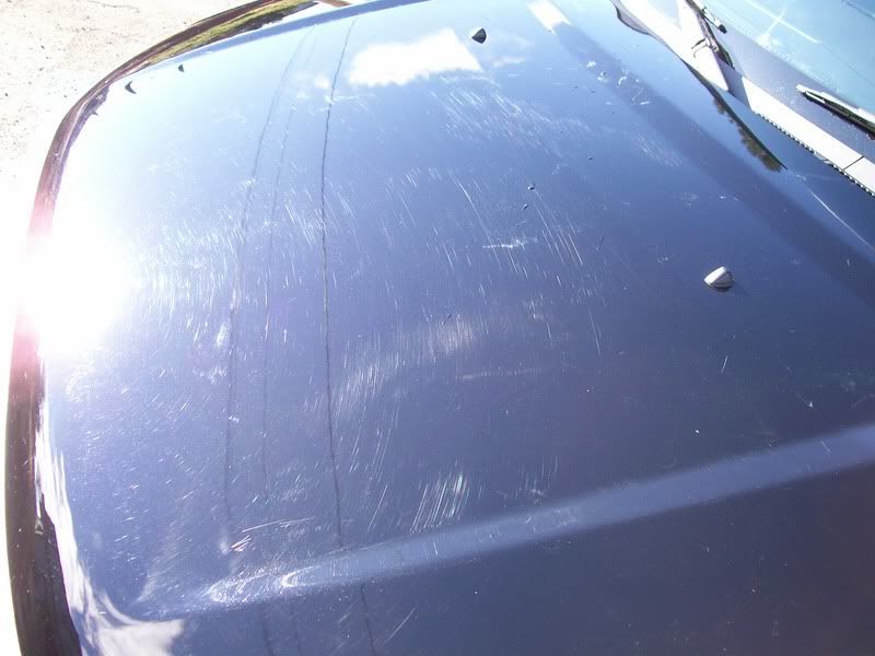

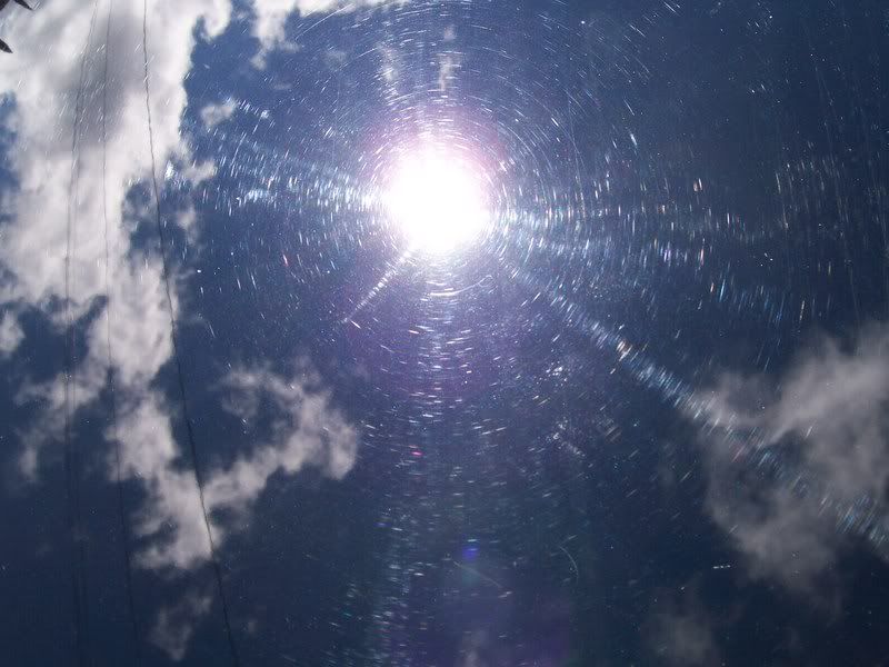

I ended up trading in my Ion Redline for somthing that was much more practical and is it smarter choice in the long run. Altho i do miss the supercharger lol. Its a 04 Honda Element Ex Eternal Blue (only 17k).Seems with these cars, you either love them or hate em. I didnt like them when they first came out but i absolutely love mine. Its insane all the different things you can do with them and how everything moves around. So far iv blacked out the windows. To come is a lowering kit, wheels, paint all the plastic panels, then some mods to the interior.Anyways for the detail end of it. Had some nice buffer trials in it, spider webs, scratches, water spots, overspray, you name it.

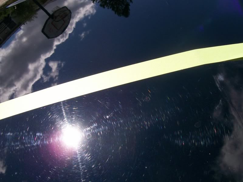

XMT 3 w/ CCS Orange Light Cutting Pad @ 5.5 UDM
XMT 1 w/ CCS Green Polish/Finishing Pad @ 3 UDM
XMT Glaze w/ CCS Grey Finishing Pad @ 2 UDM
XMT 180 x2

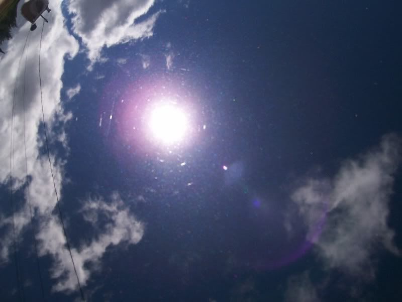

Before and Afters

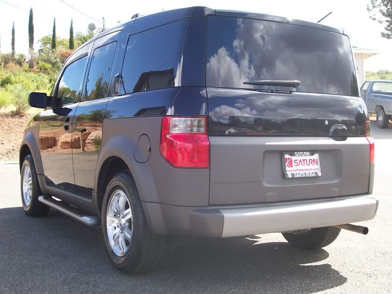

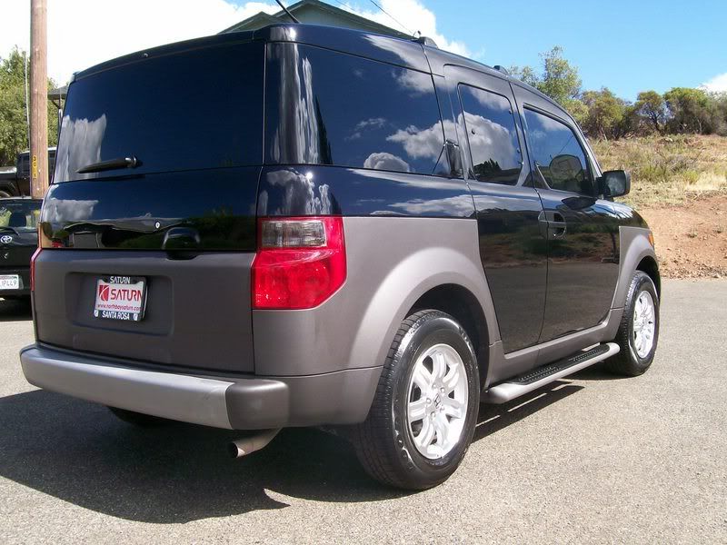

Couple LSP shots and some shots at the lake by my house

Great work!! Don't show the dealer..he'll want it back or think he undercharged you!! LOL I love this shot showcasing your work: Also, the 2nd shot really shows the relection..edit..pics got reversed somehow??
Looks darn good, 180 looks great on it, reflection for miles.

If that car had received the care, time, products, and expertise you put into it before you bought it I bet it would have sold for more. Great job! You made those nasty swirls and scratches a thing of the past. The black finish looks outstanding.

Gary- the fenders are actually just textured plastic, its kinda nice. dont have to worry about rock chips and less paint to take care of lol.

Congratulations on the new car. You did an outstanding job of making it look brand new again. It has a mirror-like finish now.
Any ideas what you might use on the textured plastic...like 303 or similar? My Xterra has the same thing and always looking for some new and product to possibly try on it.
And if you ever figure out a way to get some scratches out of that plastic....well then
Last night i actaully just through on a quik coat of PB Natural look just so see how it looked. It looked really good, a nice satin finish and made it look a little darker. Think next im going to try PB Trim Restorer.
I actaully have a few scratches on the plastic of mine. Im going to try something out this weekend and see how it works. Ill letcha know how it comes out.
