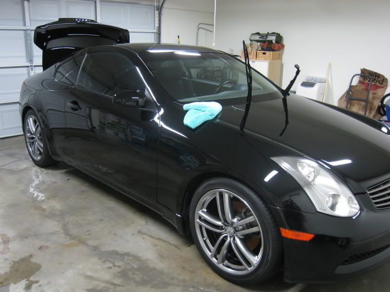

Hello everyone,
Its been about close to year since I last polished my car. The paint was in much better shape than a year ago when I had first tackled correcting it.
The introduction of Opti-Coat and Cquartz really caught my attention because my car has soft paint and black paint always shows everything. I was initially going to use Cquartz on my car but decided to use that for my wifes camry. Instead, I waited for the release of Opti-Coat 2.0.
I also want to mention that I was able to do the whole car with 10cc of Opti-Coat and found the application very easy. I used a buffing MF towel to remove any high spots.
Wash: CG citrus wash and clear (strip paint)
Decontaminate: Iron X
Clay: Mothers Clay and QD on a few panels
Polish: D300 with Meguiars MF Cutting Pad
Finish: PO85rd with LC gray pad (Thanks for the 85rd sample Rsurfer!)
LSP: Opti-Coat 2.0

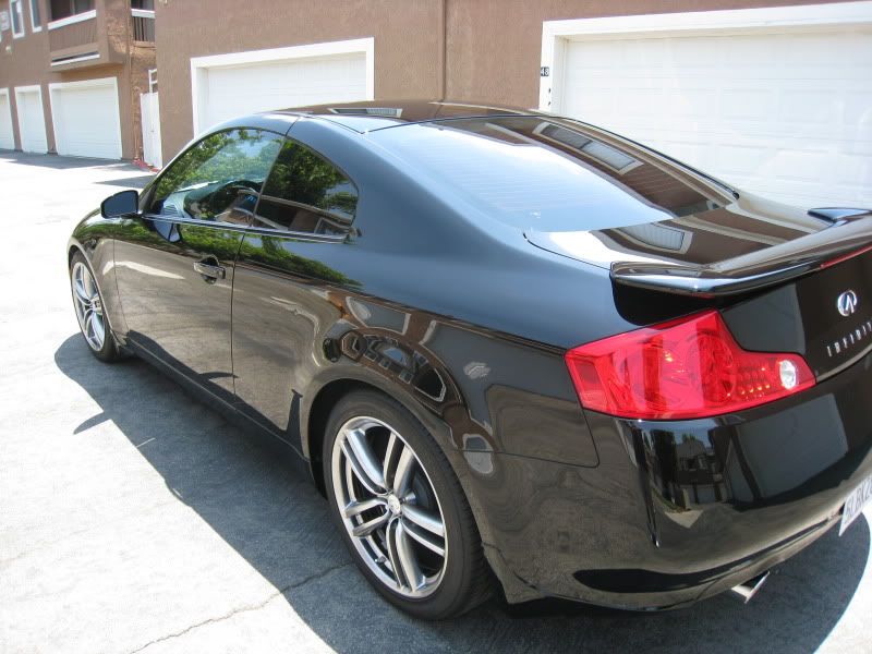

I was surprised that using DI rinses, 2Bucket Method, and Sheepskin wash mitts still marred my paint from when I first polished my car. Here is a 50/50 pic to show that.
50/50
D300 correction

Nothing prettier than a polished out black car. Did you have any smudging issues like I had with the OC?
No smudging issues that I could report. I did leave a high spot near the back quarter panel. I noticed it this morning. I am going to try and polish it out. No big deal.

Thanks Rsurfer, I finally used the PO85rd you sent me almost a year ago. I had also ordered the PO85rd but did not touch it because your sample was enough, I still had some left over. Just curious, have you tried Menzerna 106fa? I was told it finishes down well and has more cut than PO85rd. Curious to know how it finishes on Infiniti paint. I am most likely going to order it as well.

Thanks LuxuryMobile, I tried my best to keep it marr free but the pics show it's close to impossible even with the proper wash techniques applied. Hopefully, Opti-Coat can provide better protection from marring.

I will try and post some updates. I am trying my best not to mar it this time around. I recently purchased the Car Pro Wool Wash Mitt and a cheap electric blower. The blower already made drying the car much easier.
YW, 106 does finish down pretty good, but if I need a little more cut, I use a green pad with 85rd and then finish down with a black pad. IMO Power Finish and 85rd is all you need, except for real bad paint (Meg's 105).
