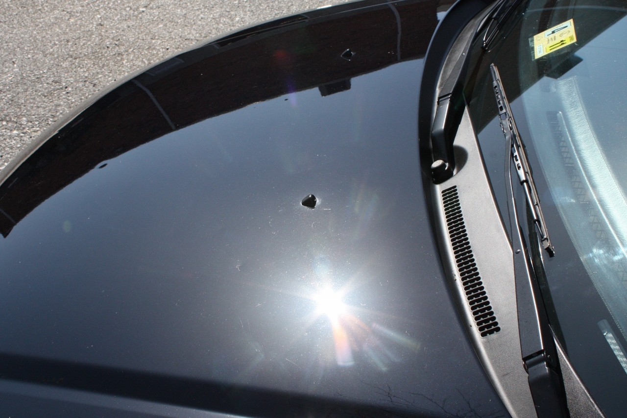

One step or two?
You can see ( not so good in pic) buffer trails/ pig tails.
Meguiars makes some great 1 step compounds that pretty much eliminate 2-3 step process!
I've done two black Mercs with ceramiclear paint, used Menz FG400 with orange cutting pad on both with good results, kept the pad clean, and reduced the pressure on the last 2 passes, results were very good for a 1 step compound!

I would like to get away with a one step. I have the WG twins and LC pads. I know I need to do a few test spots and find the right combo. Could I get away with just a one step or do I need a two?
On that paint? You'd be lucky to get away with two steps. I guess it depends on how you want it to look?
Well there's a lot of variables.
Is it your car or someone else's?
Yours, go very aggressive once, get every defect out, then polish and refine out. Wash it carefully, every year do a quick one step with a finishing polish to get out the love marks
Someone else's? One step as much as you can while being as clear as you can! It's never worth chasing everything unless you are getting paid for it or told to do it.

It's mine. And I would like to have it 85% to 90% it's my DD I don't think 100% would be a good goal.
Black too. Nice! I think 90% is good goal. A yellow pad and a good compound will really do you well. Then do a fast second step with a nice finishing polish to refine it. If it's your car and it's black, take the time and do a second step!

Agree , that's what I'm going to do . Going to do a few test spots with WG twins and WG uber if needed. Pads will be LC org/white/black. Start at the lest and work up if I need too. This is the first ceramic clear coat I've worked on. :buffing:
