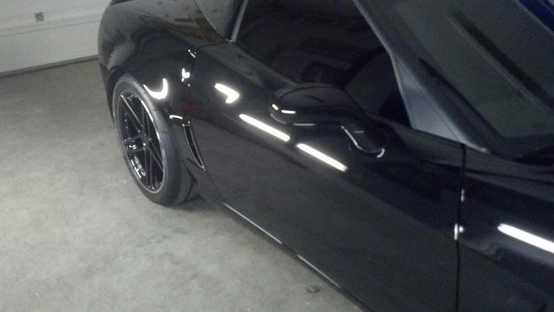

Luckily I got everything cleaned up today. The marring cleaned up rather quickly via M205 and a crimson LC Hydro pad, via Makita 9227c. I redid the hood, top, and hatch all in less than 2 hours time, got the car coated, and it's now curing. Thanks for the tips, advice, and sympathy lol. I def learned my lesson here, the hard way, and the end result is still a bad to the bone, dripping wet Black C6 that will be protected for years to come.
Not to mention the car made 748rwhp, 798 ft lbs. It's a built LS3 with a Vortech V3 and I think methanol as well. I'll do a separate thread for the car once I get it out for finished pics tomorrow.
Yea I am really glad you got it all sorted out man! Looks great in the garage, can't wait to see the outside pics tomorrow!
