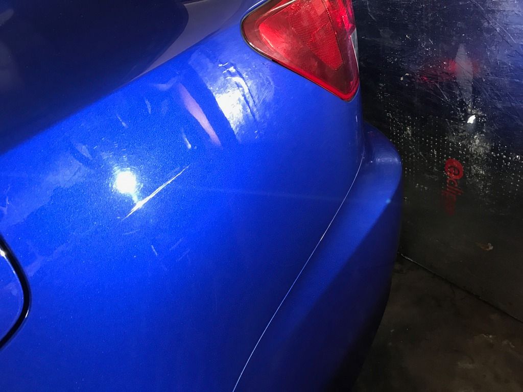

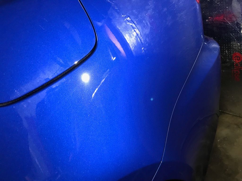

Once the vehicle was cleaned, I started a thorough decon process using meguiars clay (gray), nanoskin clay sponge (blue), and Meguiars final inspection as the lubricant. Not much decon was needed as the car was well maintained with solid protection. I split the clay bar into two pieces, one for the windows and one of the paint. The windows also had a lot of contamination around the edges which the clay bar picked up with ease. The rest of the car was in good shape except for the rear end of the car where lots of bonded contamination was uncovered with the clay bar.

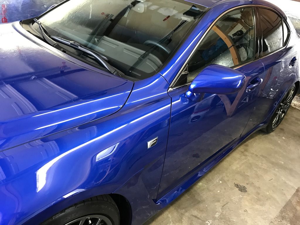

Once the car was thoroughly decontaminated the car was thoroughly inspected using the scangrip lighting system, the upper parts i.e. hood top and trunk were still swirl free from the previous correction so I left those parts alone, the rest of the panels needed some serious tlc as the car was purchased used and did not receive attention it needed.

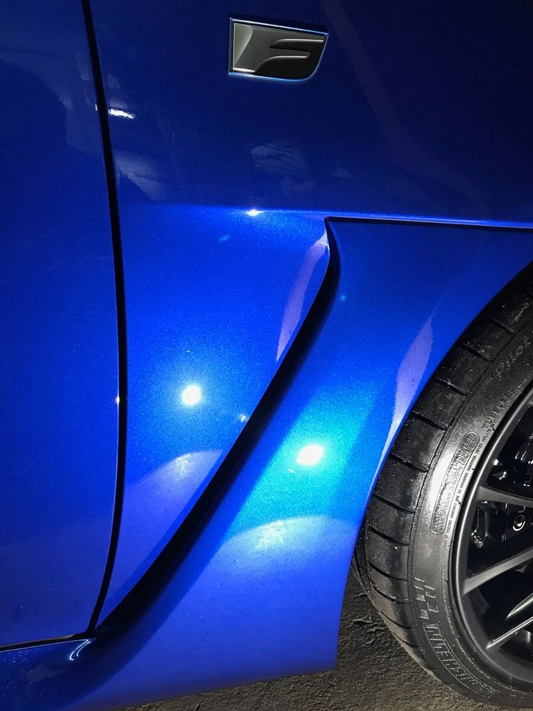

Several test spots using orange/white pad with fast correcting cream, correcting cream, and perfecting cream were used. Initially correcting cream was only taking out minor defects then the product was bumped up to fast correcting cream with white/orange pad, the orange pad was used in the end. I did try one last step using 205 and white pad, however felt that the need that the additional roi on this setup for this daily wasn't worth it for me, maybe in the future however. One of the things I noticed about this compound was that it was very easy to use. Dust free, fast defect removal, and most importantly left the finish lsp ready. I still tried perfecting cream on a few panels then concluded that this step was not worth it for me as this is a daily driver. I adjusted my technique and used the fcc and finished out literally lsp ready. I also re-read the bottle and noticed how Griots claims this product preps for lsp or perfecting cream. I could see why many professionals bump up to microfiber pads, however I wasn't chasing every rid out there. I just wanted to enhance and this product certainly exceeded my expectations and left me with a better finish with less work to follow up with in the end. Another thing to note was that the scan grip lighting reveals a lot more than what the sun can reveal. After the test spots were performed, I was able to bring it out into the sun to inspect the results.

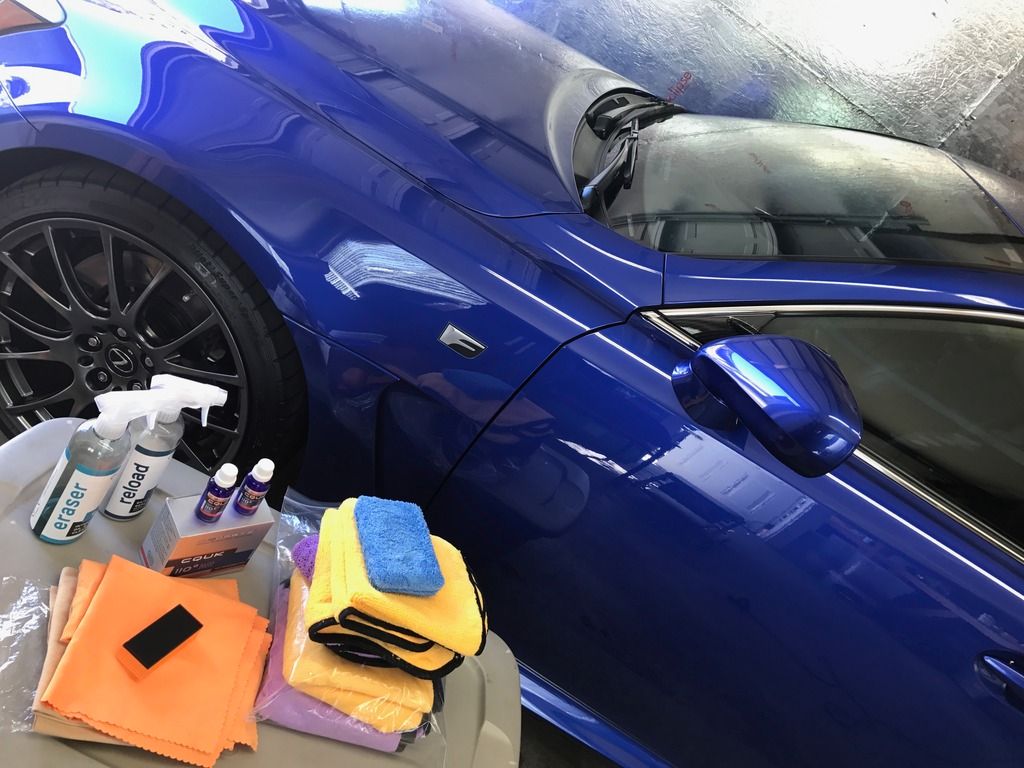

This was the first time trying out the coatings, it was fairly straight forward however I did incur one high spot, however it was because I was working panel by panel and while wiping the off the product on the applied fender, the microfiber slid across the hood and left a spot which was noticed at a later time. This may be something you should look out for if your working panel to panel like I was.
