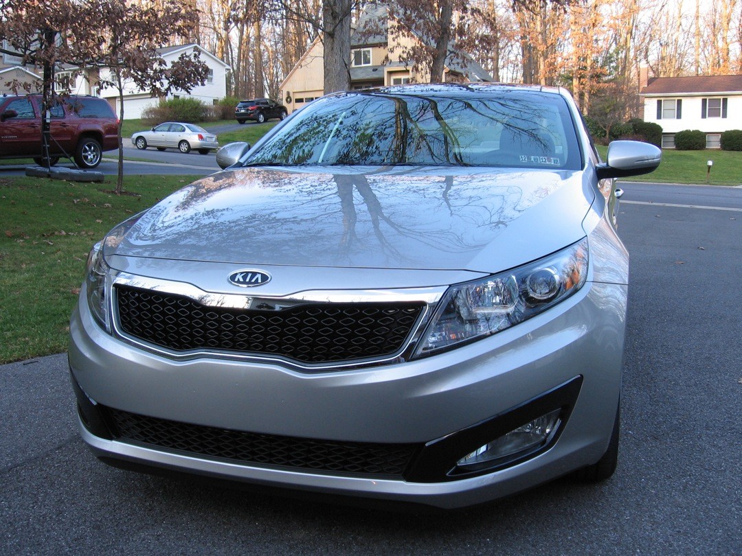

View attachment 37143 this is how the car beaded in this mornings shower..

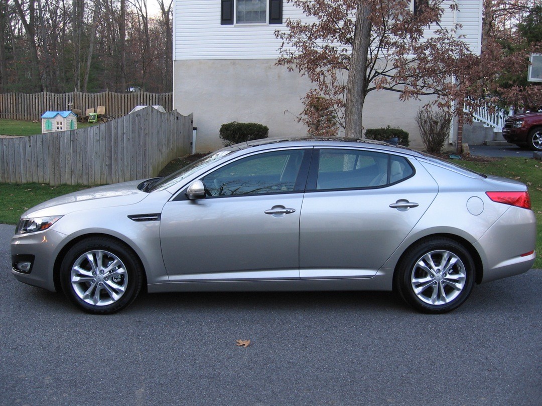

View attachment 37144 here's an afternoon shot of how it looks with a one pad per step correction on the initial try.
