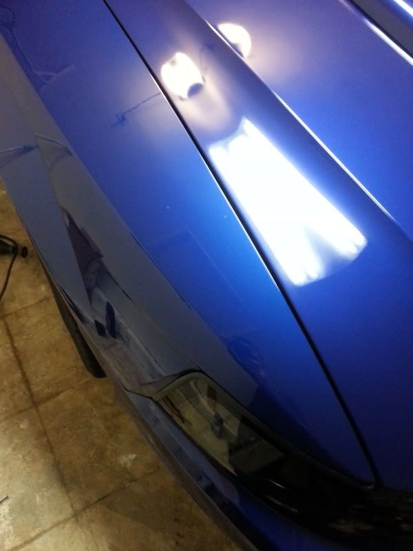

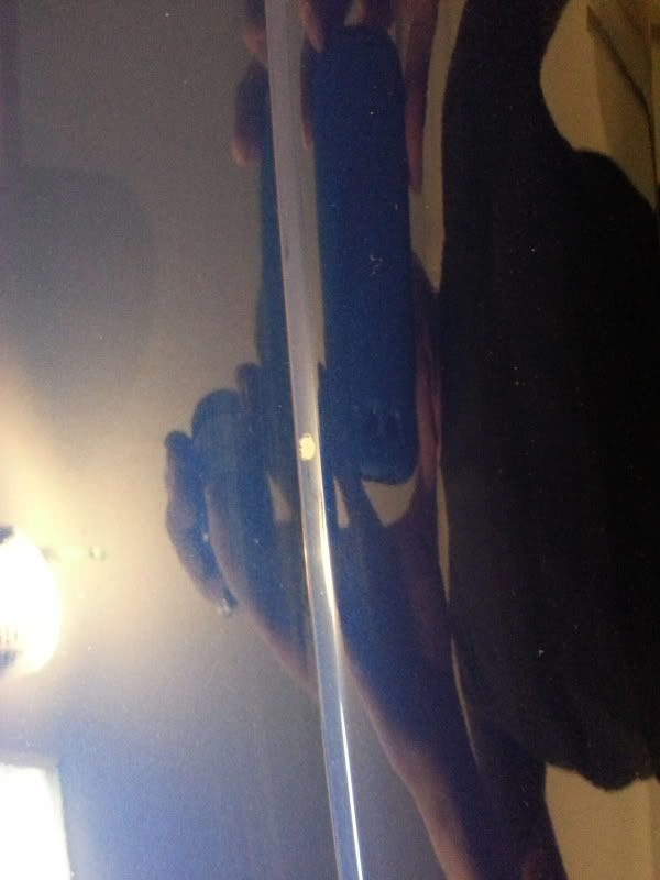

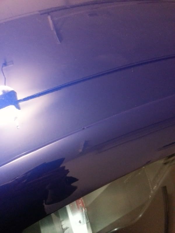

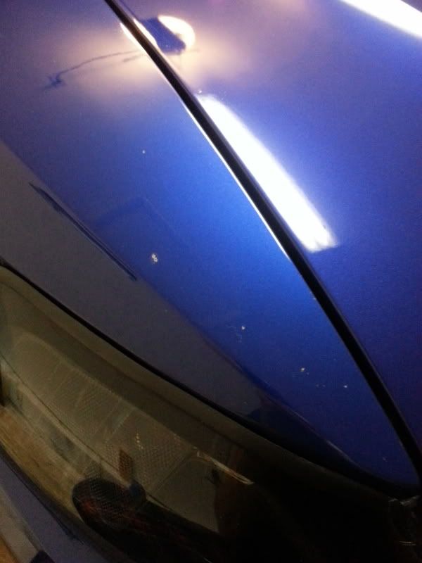

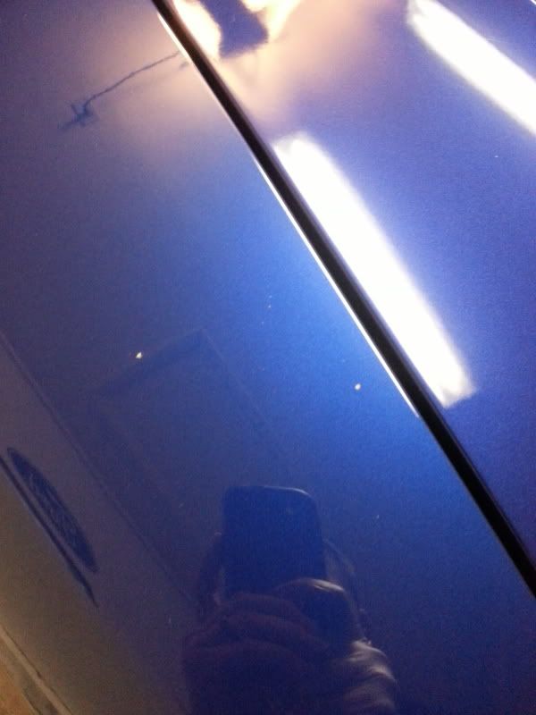

I am overall pretty satisfied with the kit. I think my expectaitions were a little to high, but it did make my chips look significantly better. There is a bit of a learning curve to this product. Some of them I can no longer find while others I still can. I am going to have to apply multiple coats to some to build up the paint. I may also purchase one of there rubber spreaders that isnt included in the kit to help level and spread the paint better over the larger chips. I will update my results once I purchase that and re-attempt. Ill let the pics speak for themselves.
Before:
After:

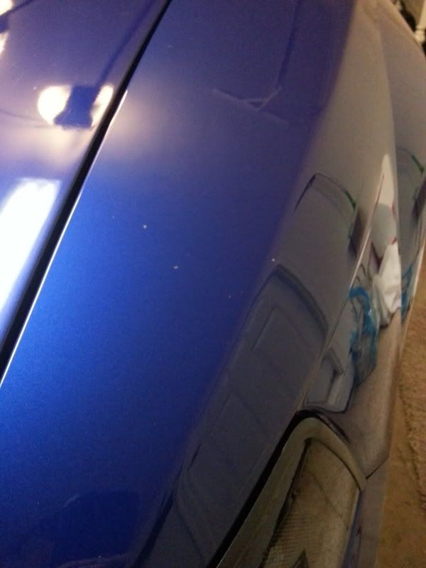

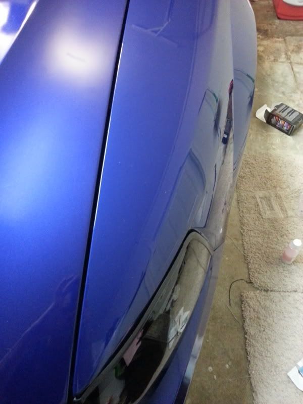

Much improved, however 2 of the larger chips can still be seen. Need to readdress these
As you can see there was a large improvement. I would recomend this kit to everyone :dblthumb2:. Patience is key and just remember that you might have to reapply to more severe areas. It beats getting a respray. I hope you all enjoyed this review :xyxthumbs:.
