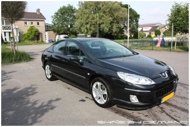

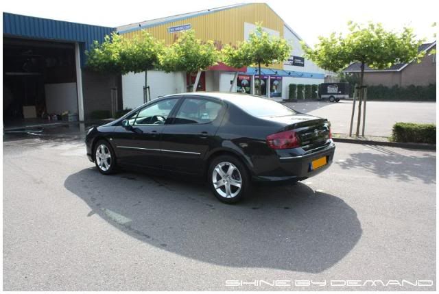

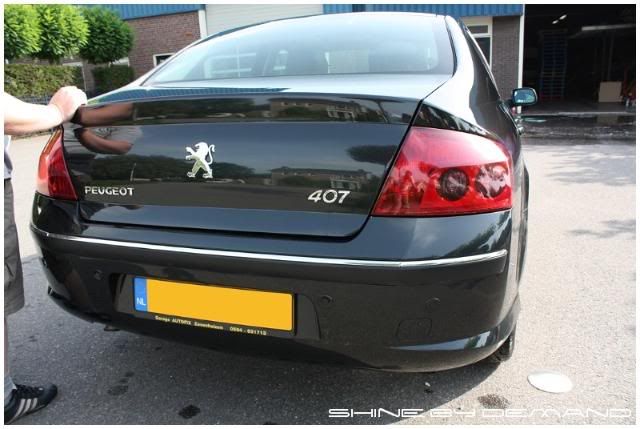

I detail cars with my Friend Adrie. It's more fun than doing a car on your own and we simpy don't get a car done in one day if we would do it by ourselves.
This Peugeot 407 was always a very good friend with the local carwash ;)
We never give any guarantees on results or if scratches can be removed or not.
After readings with a PTG we discovered only the trunk was resprayed. The thickness was about 250-300 with some spots around 1200micron.
The rest of the car was around 140-160 microns. Pretty safe for heavy polishinging if it was needed.
The paint itself wasn't that hard only the deeper swirls and scratches were quite deep so after a few tests we began polishing with the Heavy So1o Wool pad and Menzerna Intensive Polish. The finish it left was so good we only needed to refine it with a Kompressor finishing pad and Menzerna Final Finish.
2 Hits of heavy wool and Menz IP took the thinks from 144 to 132 microns.

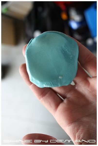

-Calyed with Last Touch/Born Slippy + Meg's pro mild clay

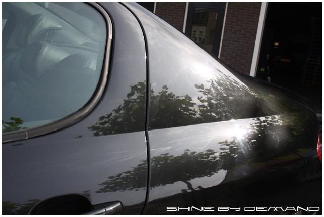

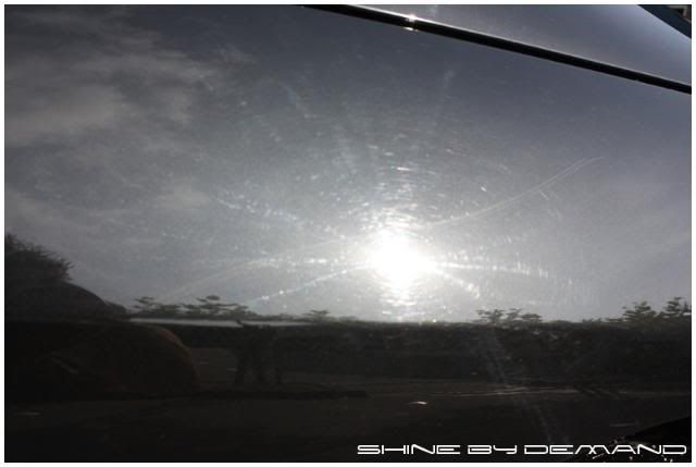

Before shots:

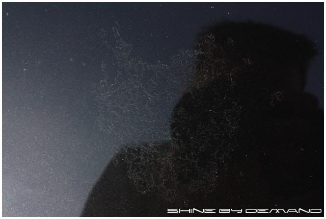

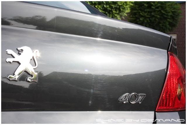

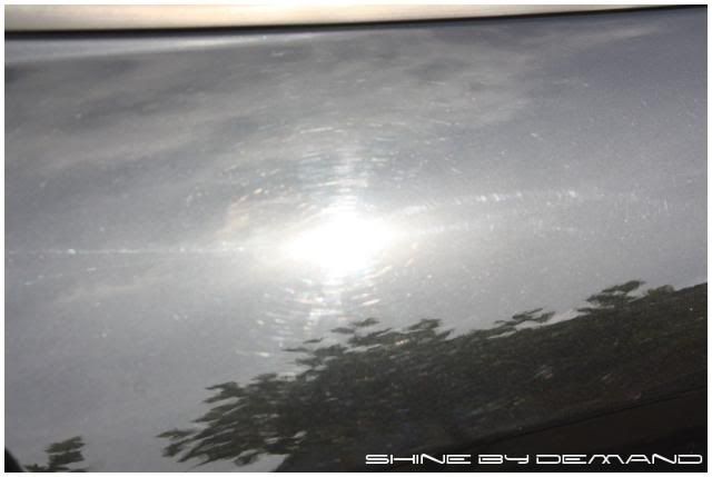

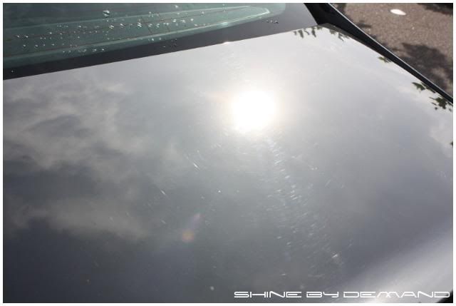

Birds have done their thing they do best on the hood:

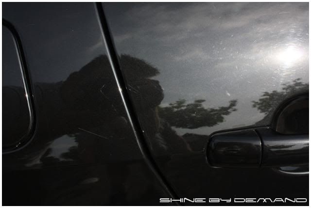

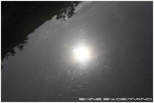

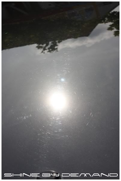

Got swirls?

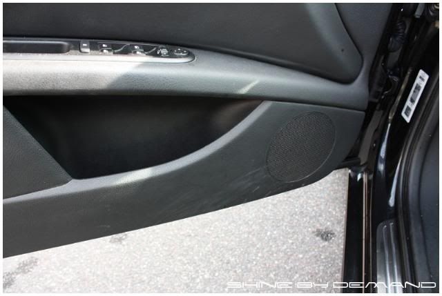

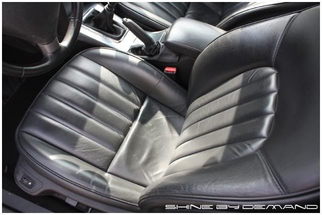

Interior before:

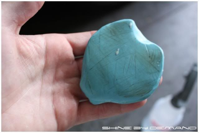

Claying results:

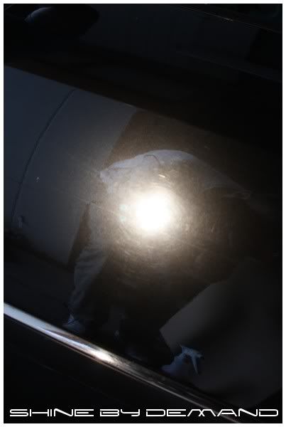

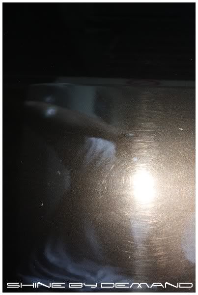

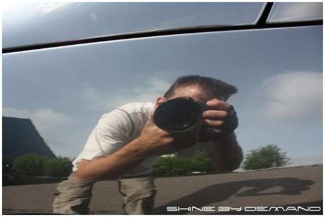

Brinkmann shots:

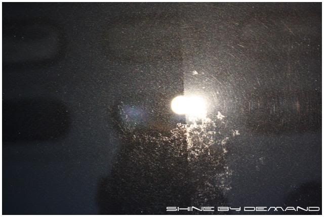

Not completly removed but a very big improvement:

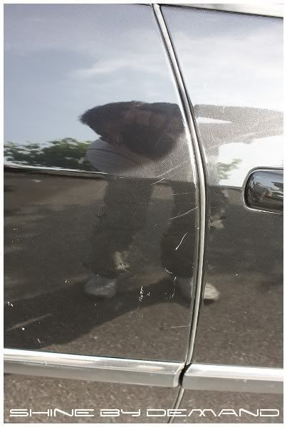

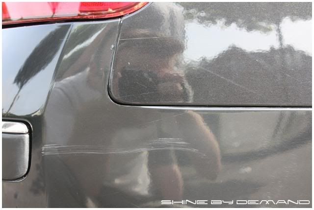

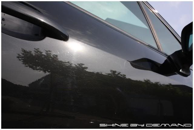

Scratch before:
And after:
Nice 50/50:

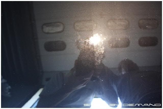

Before:
50/50:
After:

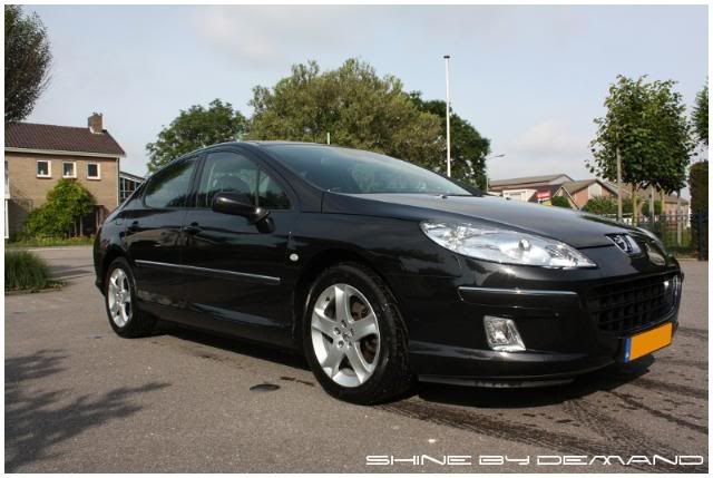

Final after shots:
You think eeeeeek holograms!
But they were stripings for aircraft lol!
