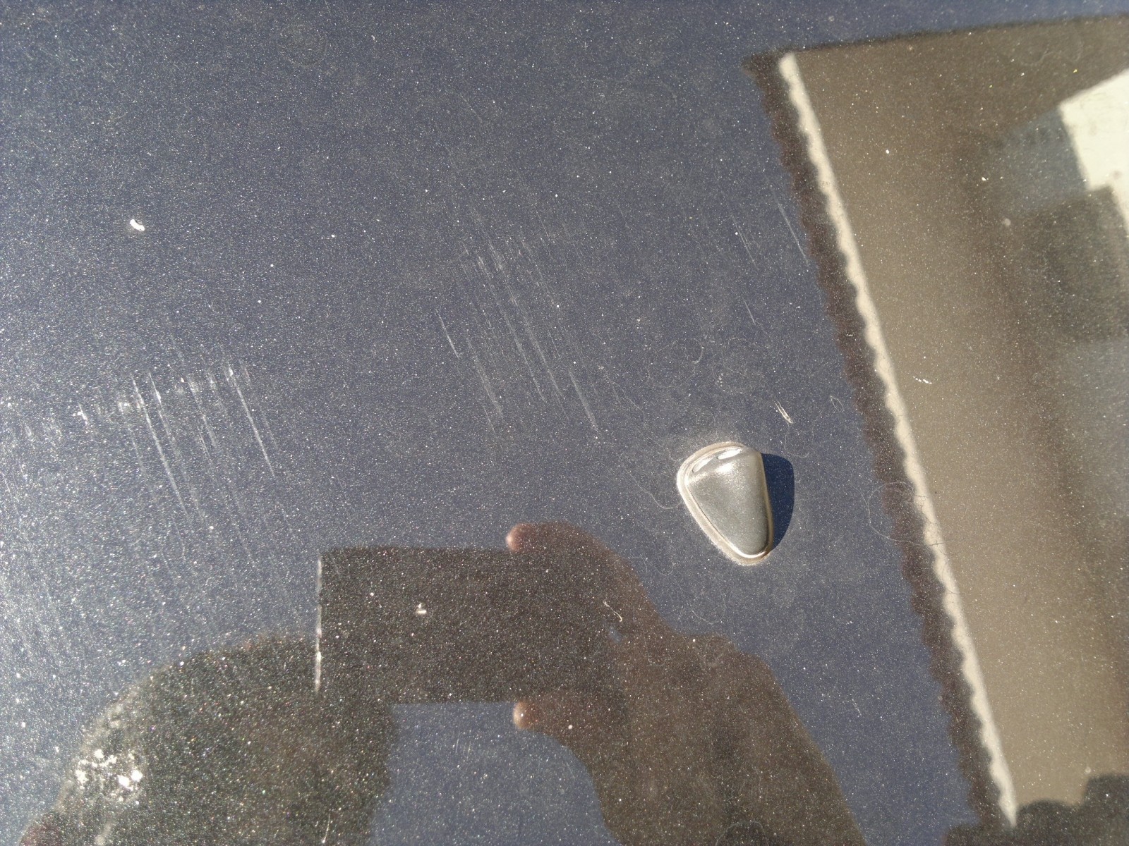

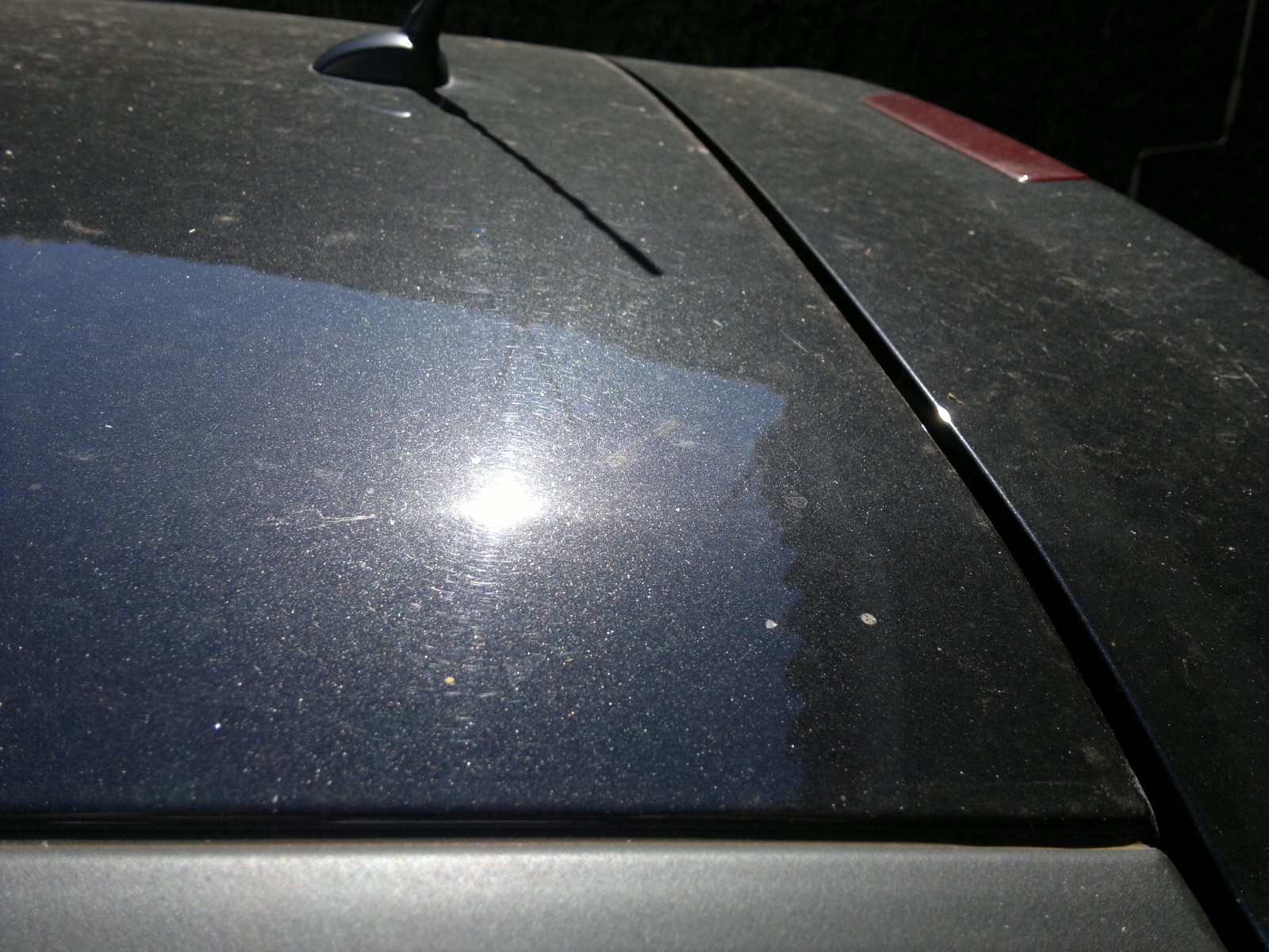

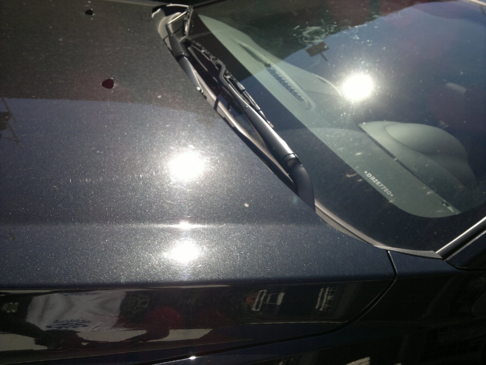

Hello Autogeek!! It has been a long time since I have posted, but I wanted to get back into doing some write ups, so here we are.
So lets start out with what we have.
Vehicle: Porsche Boxster (Silver with Burgundy Convertible Top)
Service: Complete Onsite detail
Products used: Wheels were cleaned using GTECHNIQ Citrus Cleaner to clean the tires, Shine Supply Solution 10:1 to clean the wheels and then GTECHNIQ Iron and Fallout to remove the embedded brake dust.
Body was foamed using GTECHNIQ Citrus Foam and allowed to dwell. Two bucket hand wash and then Iron removal. Clayed using a clay mitt.
Polishing was performed using the Rupes 21, with a Lake Country Orange HDO pad and Optimum Hyper Polish.
This vehicle was being delivered from New Jersey to a new owner in Florida. It was dropped off at GTM & Sons in Spartanburg County, SC where it would then be taken to Florida. We were called to take care of the detail before delivery.
The car had general signs of use. The inner wheel barrels appeared to not have been cleaned that often, so our first task as always is to make sure the wheels are really deep cleaned. We then moved on to getting the paint prepped for polishing. Our Complete detail service has a light enhancement polish included. This is not to go crazy and correct major issues, but more to clean and bring the gloss of the paint up. Our preferred method in this scenario is something we picked up watching Yvan in the DeTalks Youtube videos. Using Hyper Polish on a medium polish pad, we polish a section, and then wipe the excess with Optimum No Rinse (We usually keep some on-hand). We then spray Optimum Car Wax and buff clean. It allows us to cut our time down while onsite and provides exactly what our customers need at the price point.
The interior was in great shape, but we still did a thorough vacuum of the carpets, and dust removal on all surfaces. We then shampooed the carpets to bring the fibers up and make those look fresh and new.
Windows were cleaned to a streak free shine and tires were moderately dressed two give them a nice natural look.
Here are some pics!
