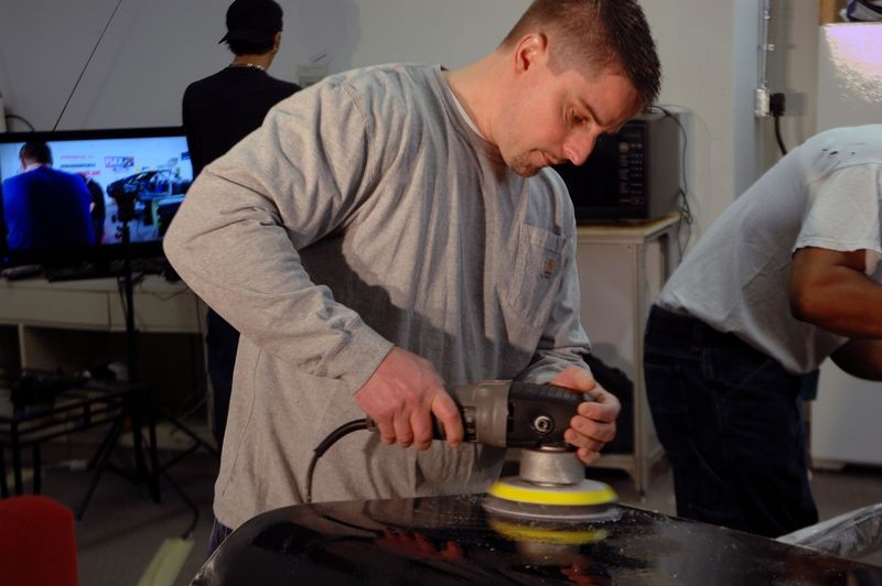

I used Menzerna 400, 2500 and 3800 and on some parts I had to go over with HC 300. After paint correction I did a 2-Step Polish and finished it off with a ceramic coating (ServFaces Ultima and Suave). The whole interior (carpet, leather) was cleaned and leather sealed with Colourlock.
Paint was beat! Good job on that man. What pad combinations were you using?
HC 300/400 with Lambswool, 2500/3800 with medium LC Pad. A strong combination I know but did the best work.
