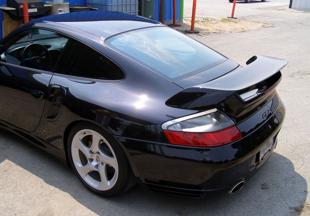

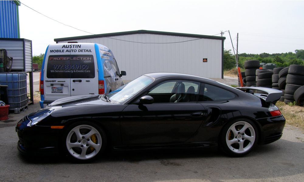

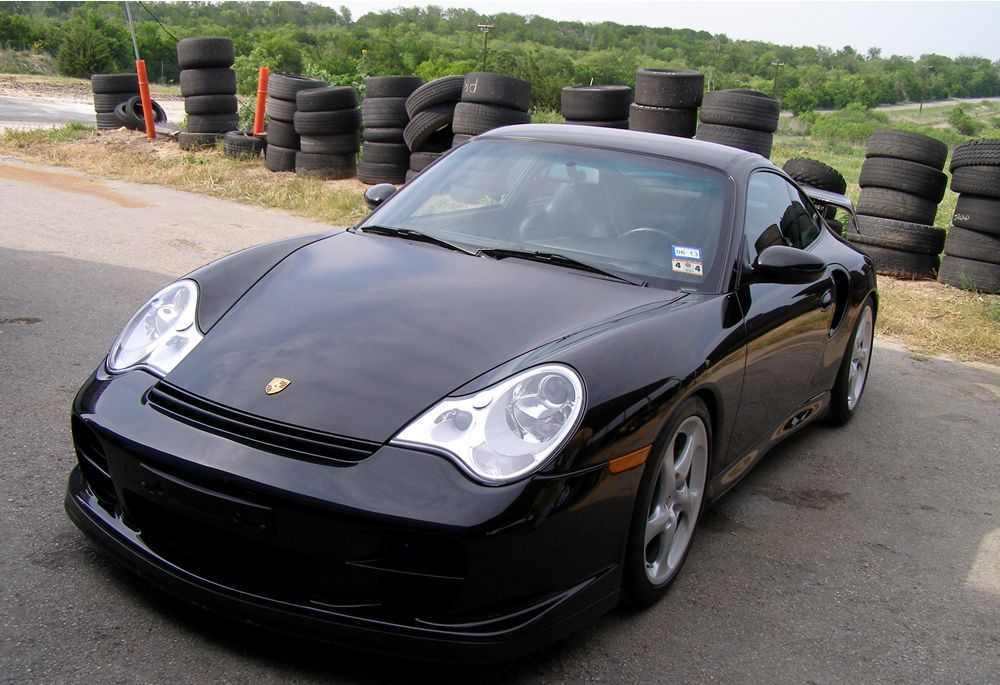

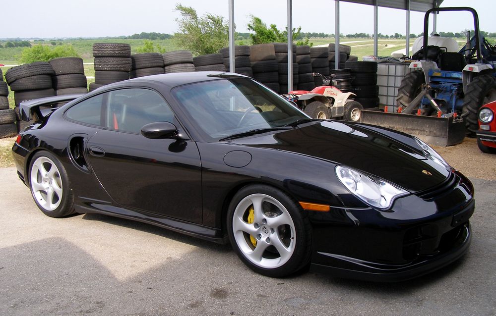

this car was done at race track in case you wonder of all the tires ...
the car will be covered and garaged , not for track use.
this project was booked for 2step correction and dog scratch removal , exterior detail only with c-quartz as protection.
correction: flex da with green lc pad and mezerna sip , polish da with hex polish pad and 205. c-quartz. project finished in 8 hours , but can be done in 6h - 6.30max

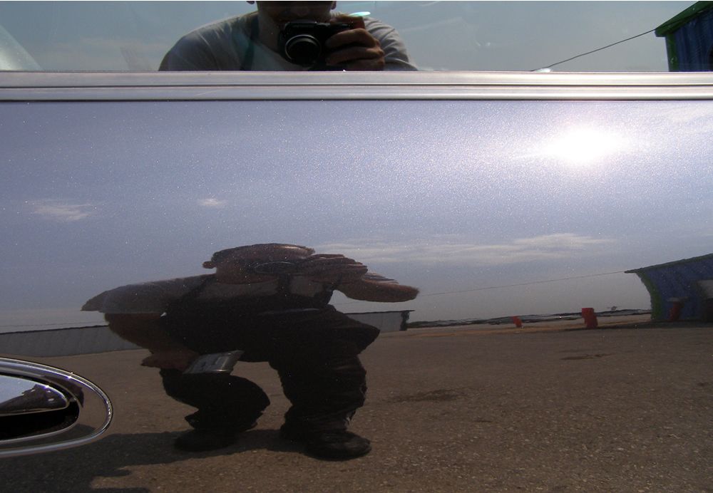

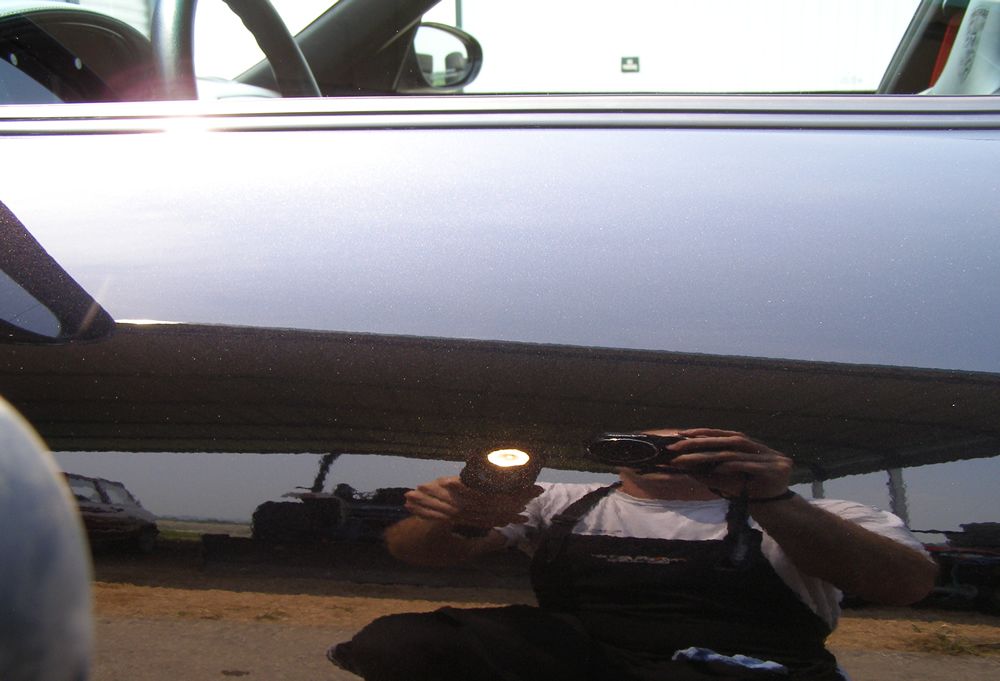

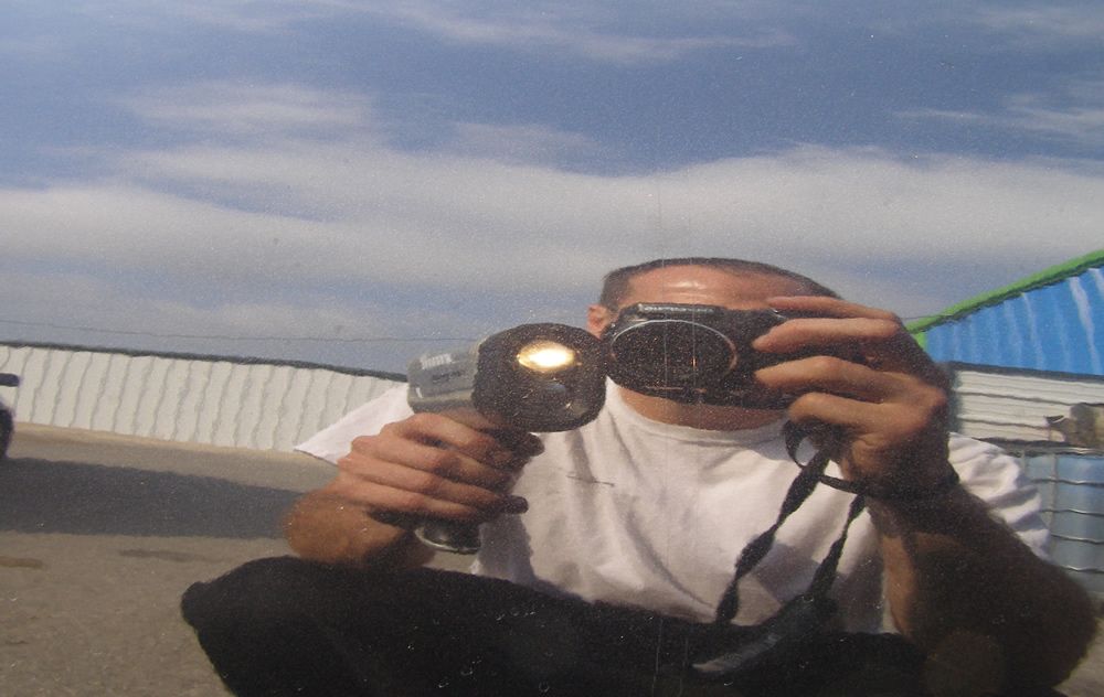

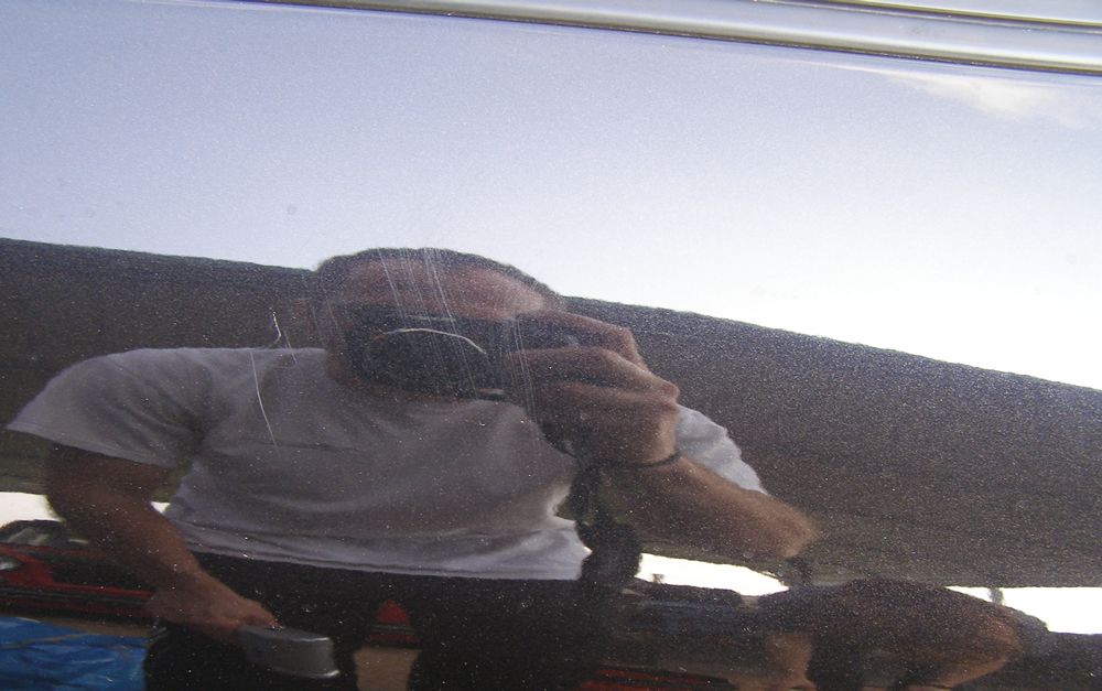

dog scratches on both doors , before shots:
After:
Nice work Cosmin. The reflections shots are amazing.
