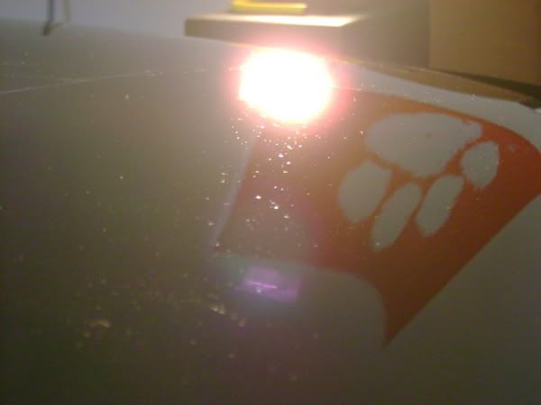

I'm having problems removing what appears to be small water spots on the hood of my 2004 2500HD. I wash and dry weekly so I assume its from rain water since the truck isn't garaged. I am new with the PC and I'm just wondering what I can do to remove these spots. This is a picture after one pass with Meg #83. Sorry for the bad picture but it was the best angle to see how bad the spots are.
Megs #83 is very good polish (hate the dust). I have seen it get out some bad paint damage. Sometimes the damage is too deep. You might try a stronger polish. What pads are you using?

could also be acid rain etchings, and is likely already well into the clearcoat. You can try polishing, wet-sanding, but likely will have to live with them or repair thru repaint.
I used an orange pad. I may try another pass with #83 and see if it helps any. Guess it's just one of those things I'll have to deal with. Thanks for the info!

I love the HD. It's an '04 and I've had no problems at all! It's a work in progress with the PC. As soon as I finish I'll post some pictures! I tried another pass on the hood with some 3M swirl remover and it's still no better. I can't feel it with my hand so I'm assuming its beyond repair without painting. The only good thing is you can't see it outside so just have to live with it under the lights!
