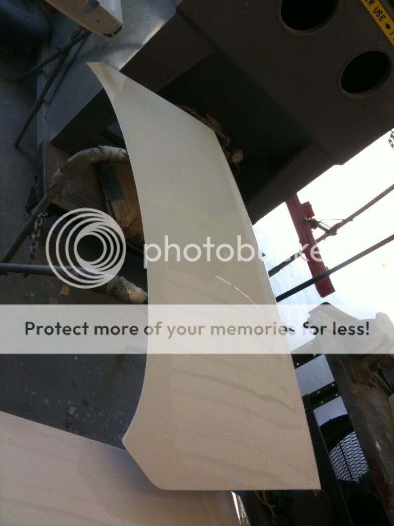

So today i saw an opportunity to refinish my hood and trunk and its exactly what i did. Even tough i still did get a few dirt nibs here and there is nothing major so when i wetsand it and buff it, it will all be taken care of. Onto the pics:
Believe it or not. It has very little orange peel. Its my 4th time painting and entire car and compared to the others ive done... this really showed my progress!
Trunk!
Take a look at the lights in the roof. We all know that these florescent lights are completely straight. So we all know that orange peel distorts images and reflections so as you can see they dont look perfectly straight due to the orange peel. But trust me guys, compared to the other things ive done before...this looks very good! :dblthumb2:
This is a shot from the middle of the trunk. As you can see, the orange peel is very slight here. I was amazed at how very little orange peel i got! But for some reason i layed it on nicer in the middle that towards the edges (you will see in the next picture) My guess is that i shot it a little too fast towards the edges and slowed it down once i was in towards the middle.
See what i mean? towards the edges in went on really pealy (is that even a word? :dunno:) even tough the orange peel is worst towards the edges its all good. I will be wetsanding the entire car to completely remove all the orange peel. Since you all know, that i hate orange peel! :xyxthumbs: Hopefully once its all wet sanded i and polished to perfection... i will have show car quality paint! :dblthumb2:
