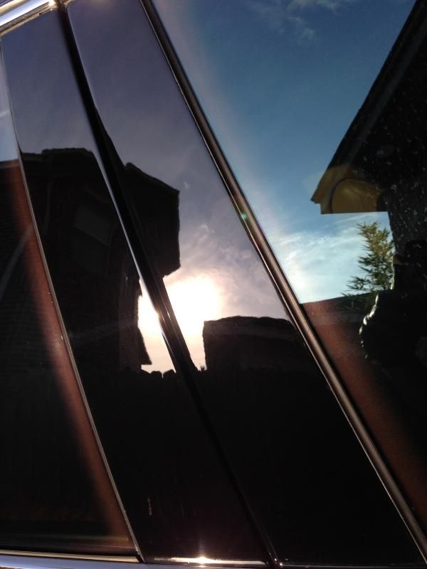

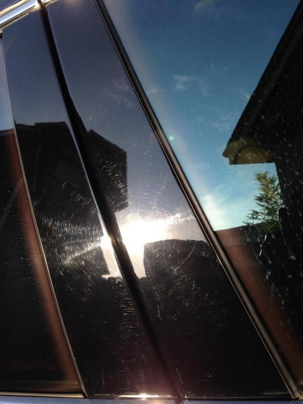

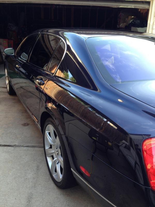

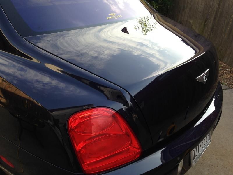

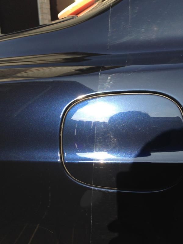

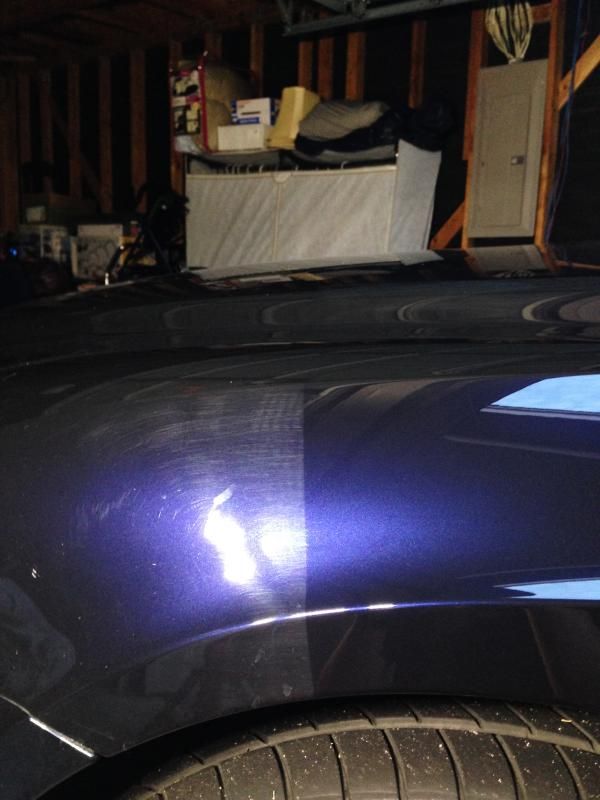

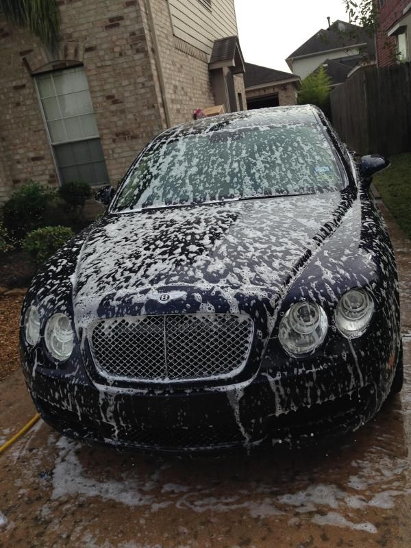

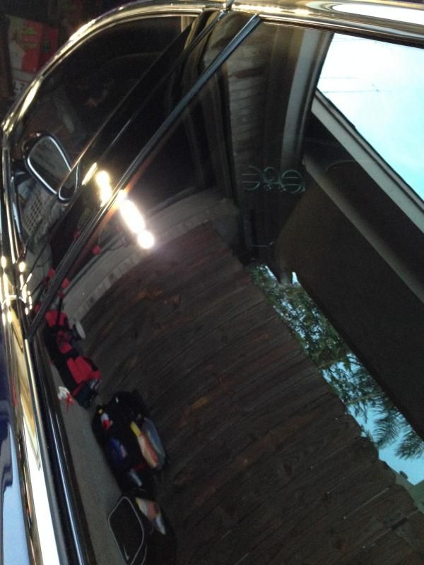

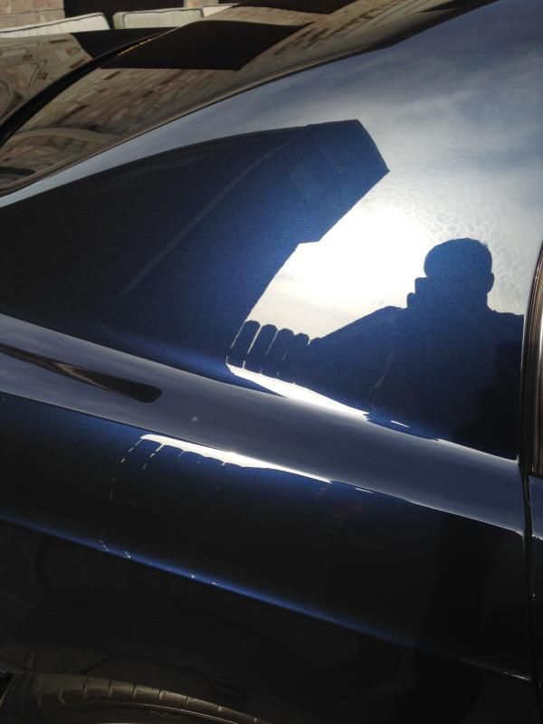

Got a chance to bring some life back to this Bentley Flying Spur for a good customer of mine.
Vehicle received the following.
  • Washed with Gilmour foam gun and Citrus Wash
  • Chemical decontamination with Iron X
  • Mechanical decontamination with Nanoskin Autoscrub mitt
  • Dried with Dry Me a River microfiber towel
  • Optimum Hyper Compound with orange Lake Country Hybrids
  • Optimum Hyper Polish with white Lake Country Hybrids
  • Detailer’s Pro Poli-Coat paint sealant machine applied

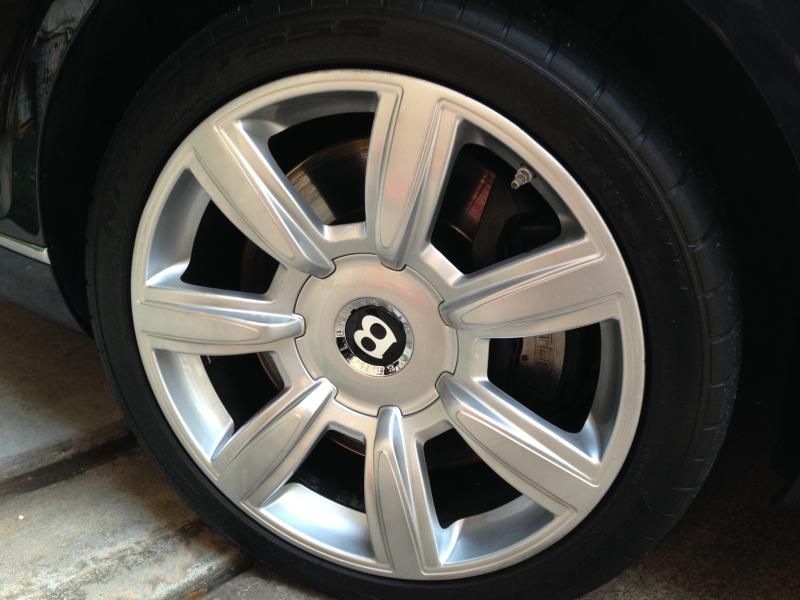

  • Wheels and glass coated with Pinnacle Black Label Diamond Surface Coating
  • Tires dressed with Ultima Tire & Trim Guard
Well that's all I got. The sun started going down when I was applying the sealant so I didn't snag any more photos. I completely forgot to take shots of the front, but it came out looking just as nice as the rest of the car. Besides a few little rids that I couldn't take out, I'd say it was a job well done. Paint was pretty soft but fun to correct. Owner was very happy.
Next detail I'll start using my GoPro so you guys don't have to look at awful cell phone photos :laughing:

Thanks, took me just over 9 hours with only short breaks to eat snacks and drink water. It actually went surprisingly faster than I thought since the paint was a breeze to correct. Usually sedans take me around 10 hours.

I like them. It takes some time to get used to the sprayer, but they cut nicely and don't dust like crazy. I like using the hyper polish a little more than the compound. It's a lot easier to use and wipes away effortlessly. Both work well though.

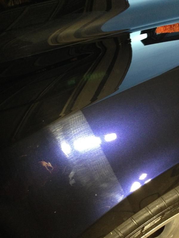

One thing I forgot to post.
I did a test spot on the passenger front fender with Wolfgang's Uber AIO and a Lake Country orange Hybrid. Here are the results from 5 passes at speed 4 on my Flex 3401. Sorry the picture quality isn't the greatest.
If you look closely you can see some very minor leftover scratches near the light on the left. It wasn't 100% perfect, but I'd say that's a pretty good result for an AIO.
