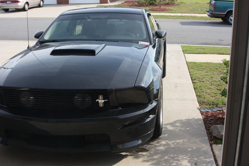

I have to say first that I will never own a black car again. After a week of a minor detail on the paint I still had scratches so I set out to do some research. I decided to pick up a lot of Chemical Guys products to fully renew my paint and interior. There is more products that are not in the picture also. I will update as I go.

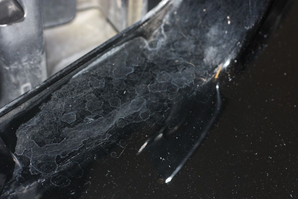

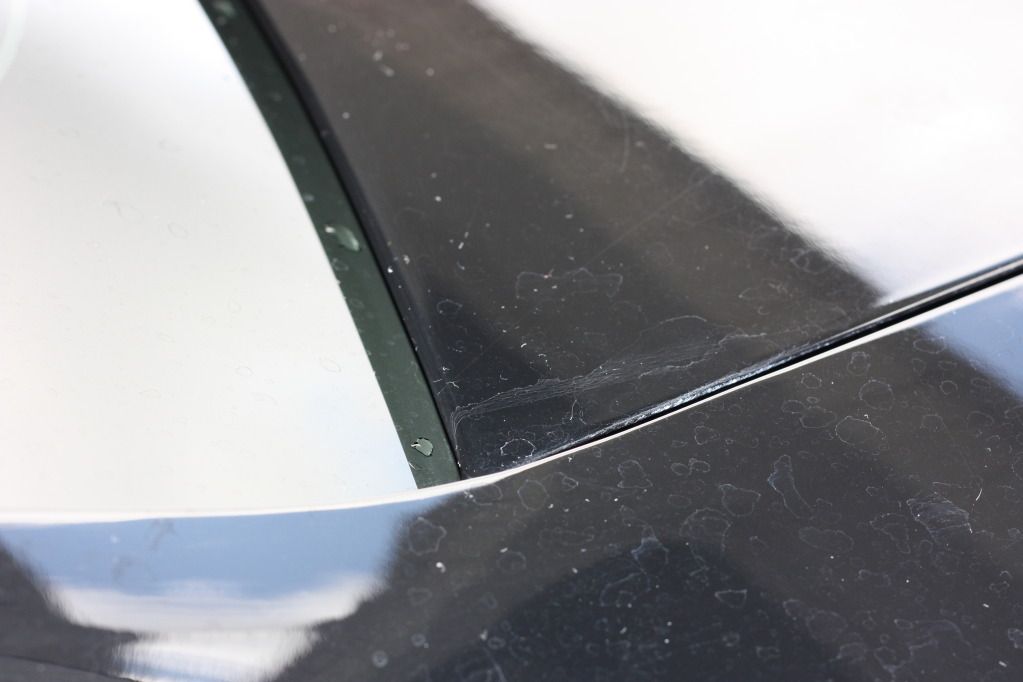

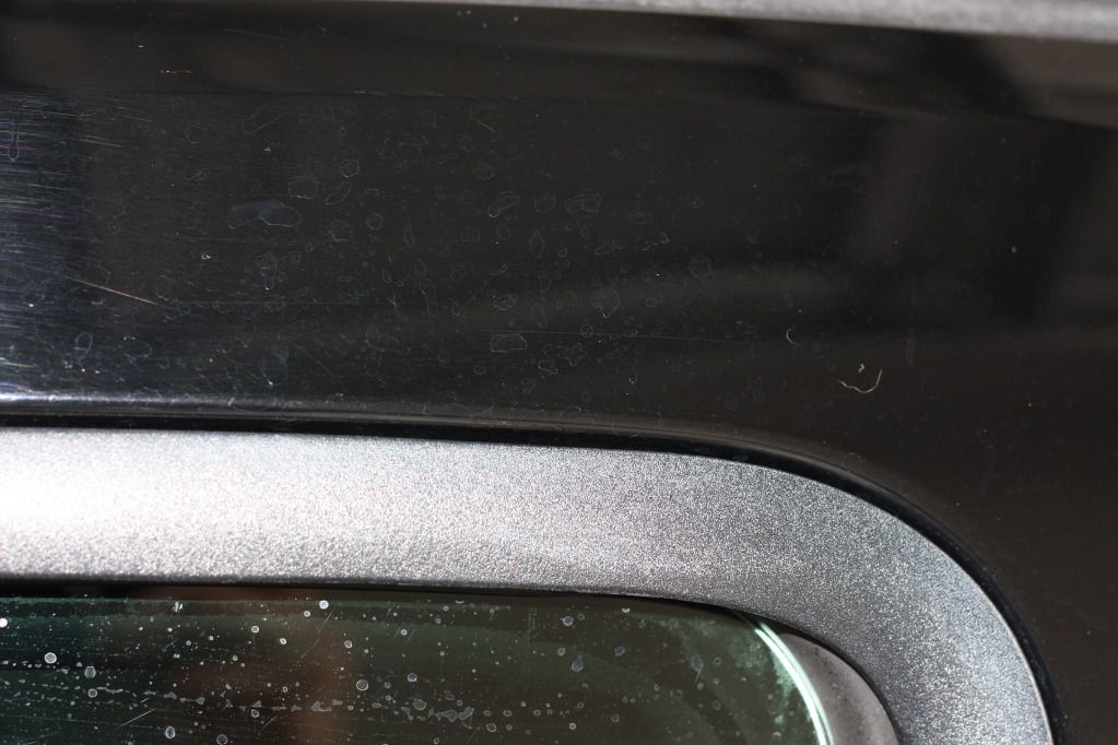

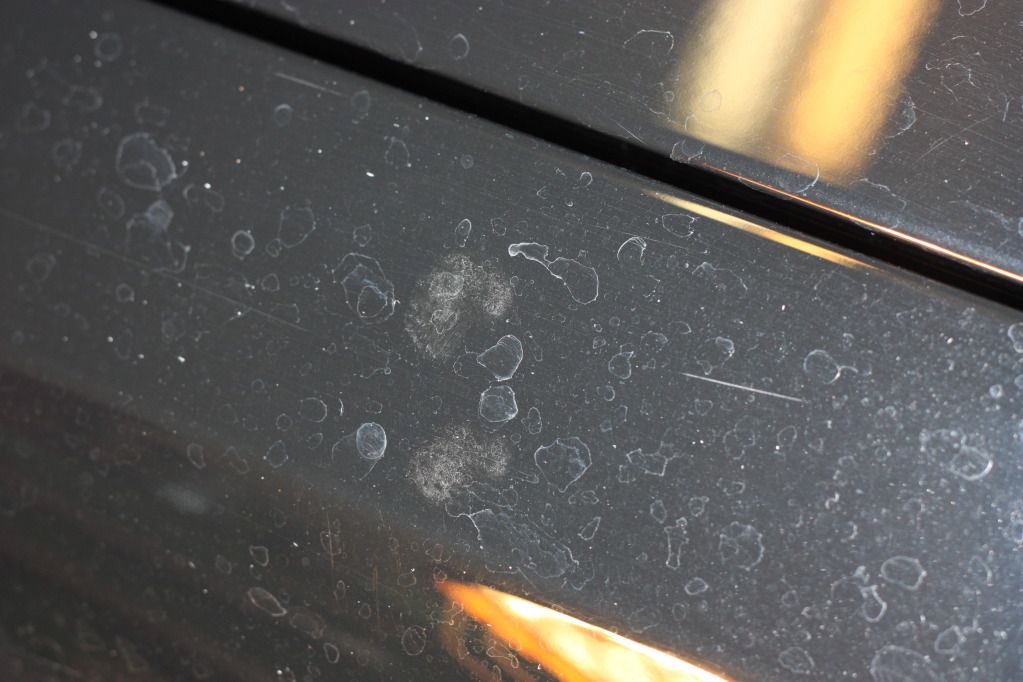

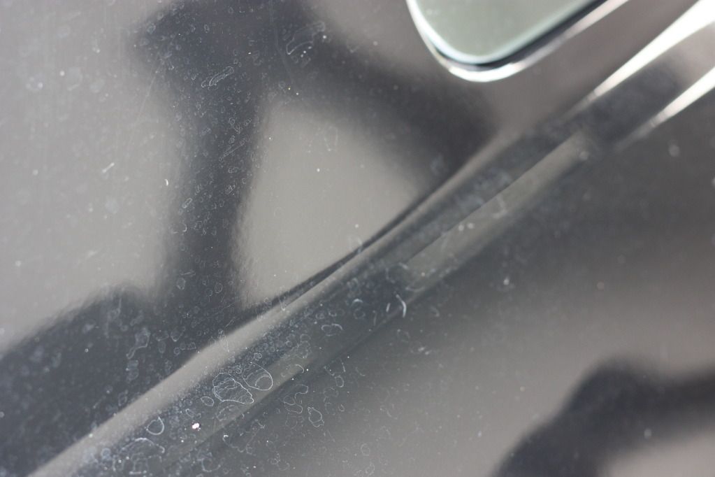

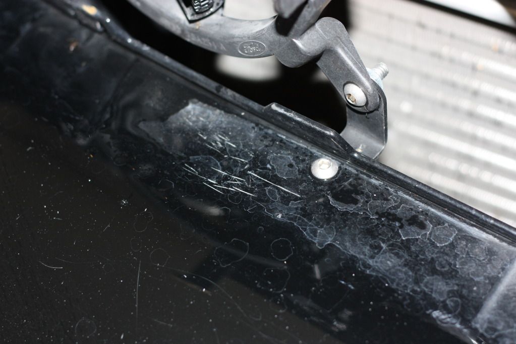

Just getting started. Hard to get the photos to show the swirls but my paint is pretty bad. These are the before pics. I will post after when the car is finished. And georgia is horrible about water spots btw. The grill and spoiler are coming off for this and whole car getting taped off.
Behind the grill
Above the driver window
Trunk drivers side
Passenger side
Passenger fender
Whole car
