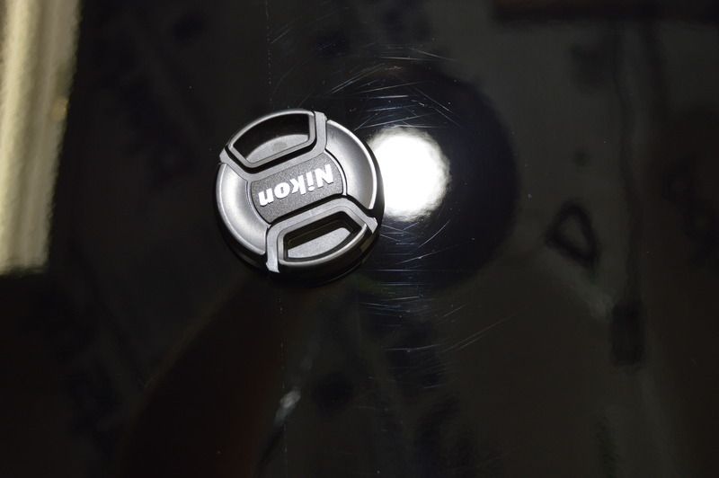

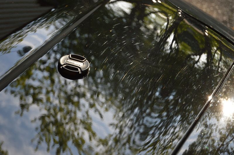

Hood:
Trunk area:

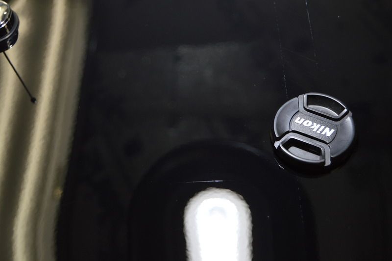

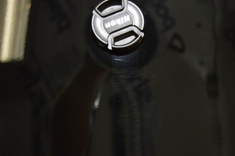

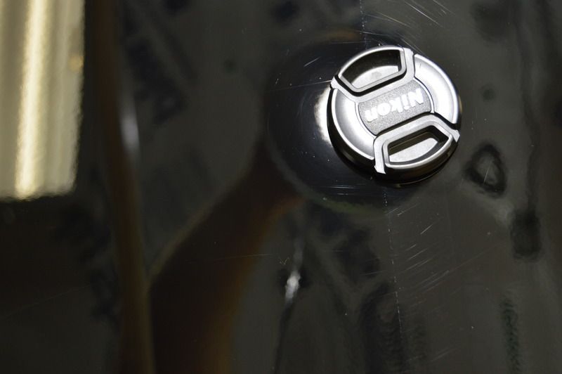

The trunk area would be my testing ground. Typically on the Dodge paints I use Menz 2500 on a white hybrid pad with the Flex set to a tad under 5. I run about 4 passes with good results. Same held true with this. I also tested the RED Uro-tech pad on a rupes, speed 4 same compound and passes:

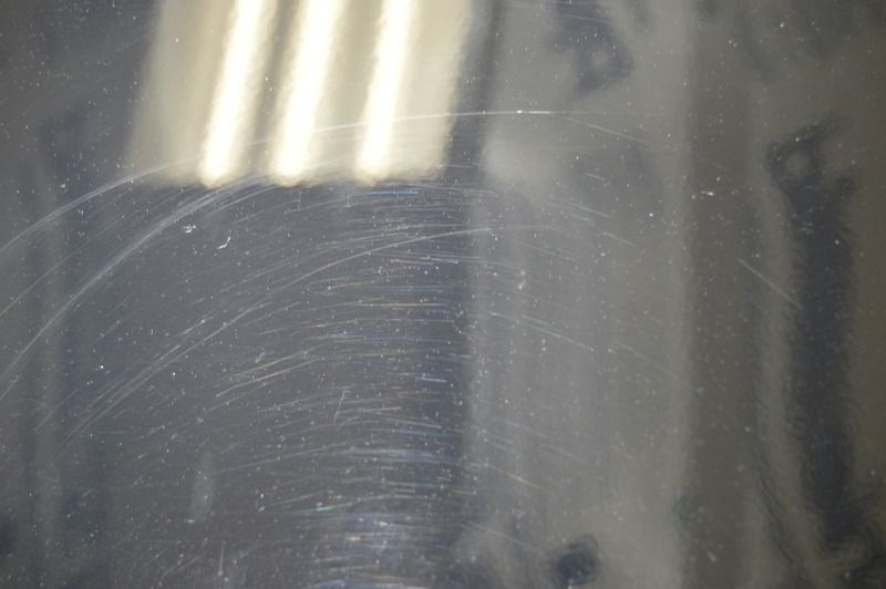

It DID clean defects up, not as well as the white hybrid pad. The pad never stopped rotating on the trunk edge or any other areas I typically saw with the Rupes and other pads. The red pad is marketed as a heavy polishing pad. The white hybrid is marketed as a polishing pad. I did like how well the Rupes ran with the red pad, just wish it cleaned up more than it did considering how it was labelled.
White pad side is top, red is the bottom:
White to the left, red to the right:
White to the left:
Red to the right:

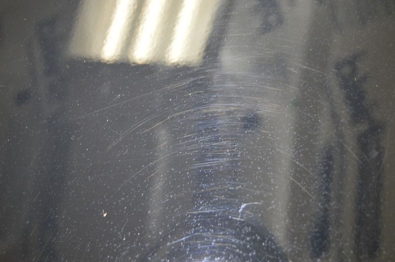

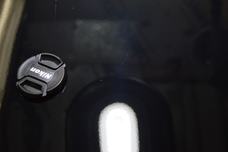

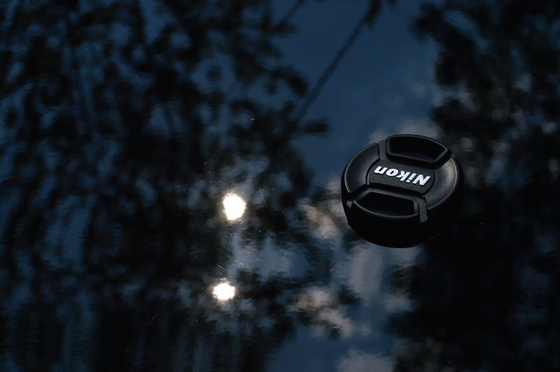

Next I fired up the blue pad looking for more cut, which it sure did. However it did it with the typical Rupes blue pad of slinging product. It did a FANTASTIC job of cleaning up defects. No haze left behind either:
For comparison, here is the white hybrid side:
Pretty much on par! I will say I went back to using my Flex for the rest of the car, one blue pad was not going to get the whole car done. However I will say they are a great alternative to the Rupes pads but I do find they may not be listed as having the correct cutting power. Had I not tested and just ordered a dozen red pads expecting them to cut like my white's I would have been disappointed! That's not to say I won't be ordering some blues to keep for use with my underused Rupes.

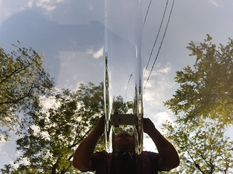

Here is the car getting baked under IR lights:

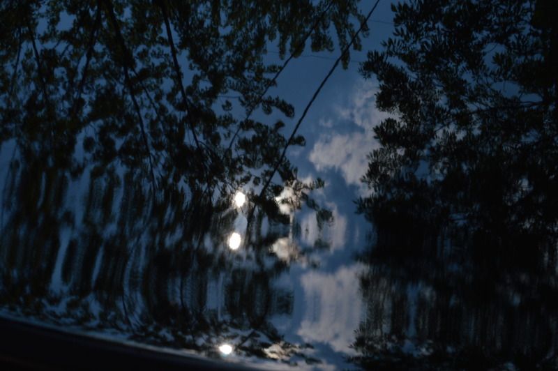

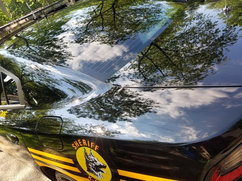

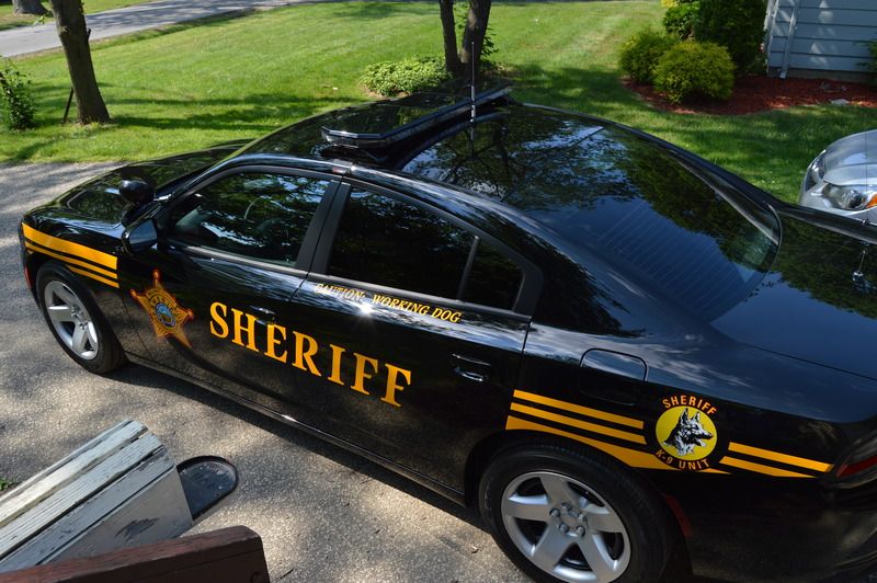

Job all done:
That trunk!

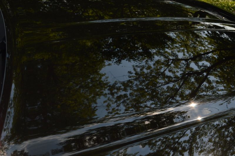

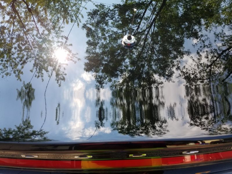

Hood:

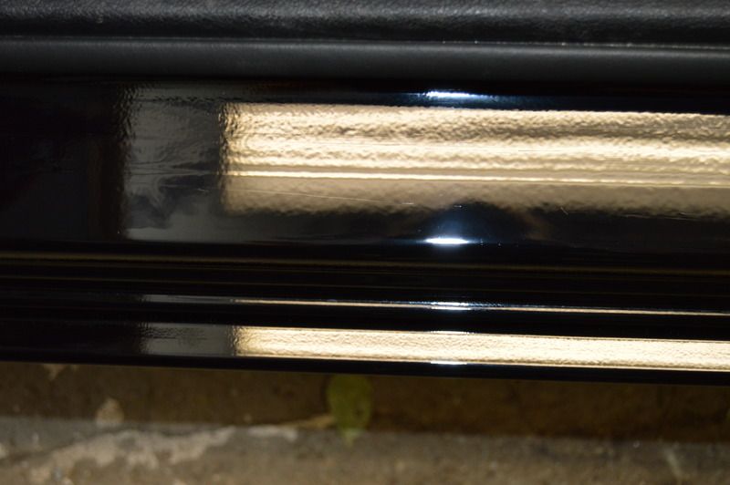

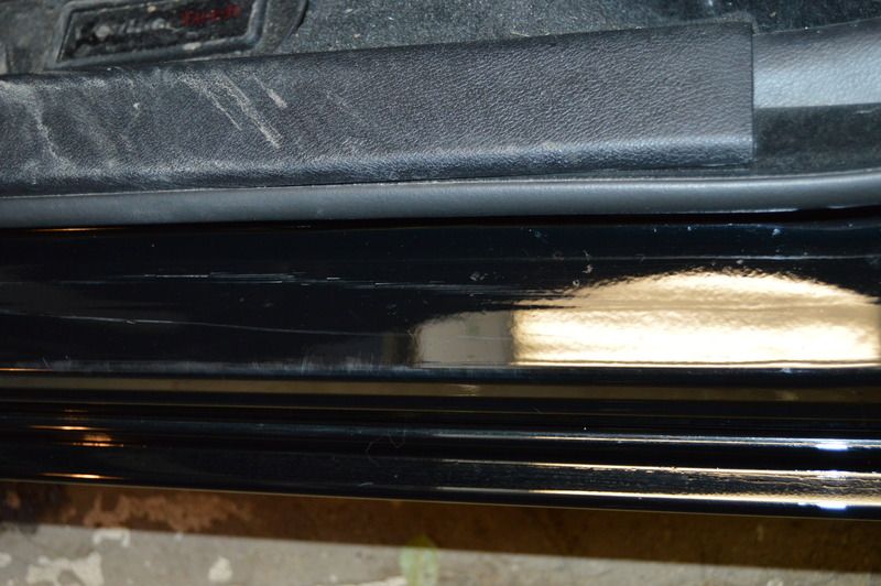

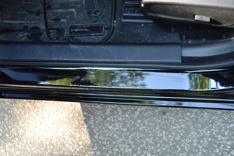

Driver side door sill was also treated with Expel door sill protection:
Pre polish:
Polish
Covered:
