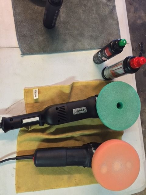

I decided to try out my new Rupes system and what better way then to put it up against my tried and tested products that I use often on my details. The results were completely unexpected.

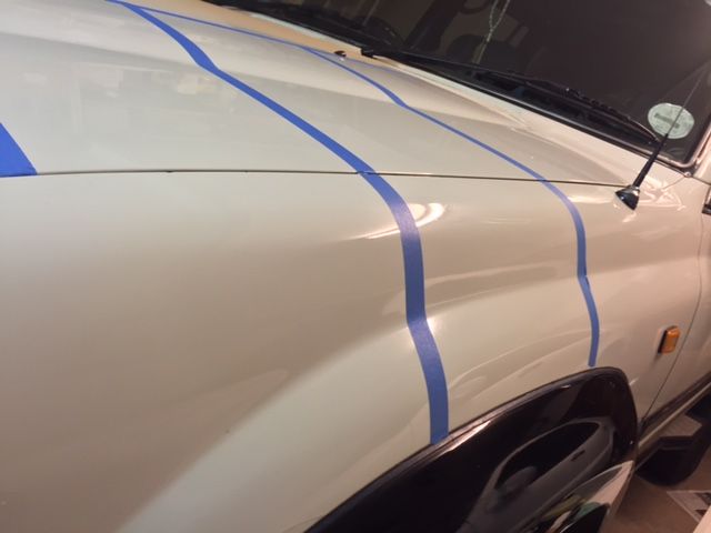

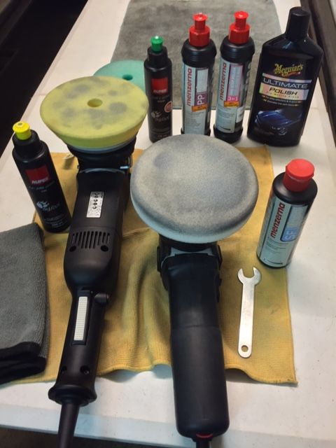

*First I tried the Rupes Yellow Keramik Gloss Fine Gel Polish(Cut of 3 or 4 out of 10 and Gloss 10/10) on my BigFoot LHR15ES as the system intended with the fine yellow pad against my Menzerna Power Protect Ultra(Cut 2/10 Gloss 10/10) with my DAS 500W DA using the Lake Country 5.5 " Flat Orange Cutting pad.
Winner in cut/correction and gloss: Rupes Keramik
*Next I decided to step up the competition and used Menzerna One-Step 3 IN 1(Cut 5/10 Gloss 9/10) also on my DAS 500W DA using the Lake Country 5.5 " Flat Orange Cutting pad.
I was completely blown away, this is Rupes Fine/Finishing polish!
*I then decided why am I testing the Rupes mild polish against Menzerna AIO's, a fair comparison would be the Menzerna SF4000(Cut of 3 or 4 out of 10 and Gloss 10/10) which I swear by and make this a fair fight! Same machine but this time used the Lake Country 5.5" Flat White Polishing pad.
*Next, same step as above I used Meguiars Ultimate Polish(Cut of 2 or 3 out of 10 and Gloss 10/10)
Whilst the Keramik repeatedly beat the competition in correcting and finish, it, like the others above didn't remove all the swirls which wasn't my intention of the test anyways as I was certain before this I was gona have to hit the car with Menzerna FG400 as being an offroader and used as such had bush rash, tons of rids and swirls etc.
So, I then decided what the heck, lets try the Rupes Green Quarz Gloss Medium Gel compound(Cut of 5 or 7 out of 10 and Gloss 8/10) on its intended Green pad. The results? Blew me away! It behaved like a compound, got rid of 99% of the swirls and finished LSP ready!
I tried my best taking pics with my iPhone 6 but in the pics I could not show the improvement on swirls and the differences which were very apparent in real.
