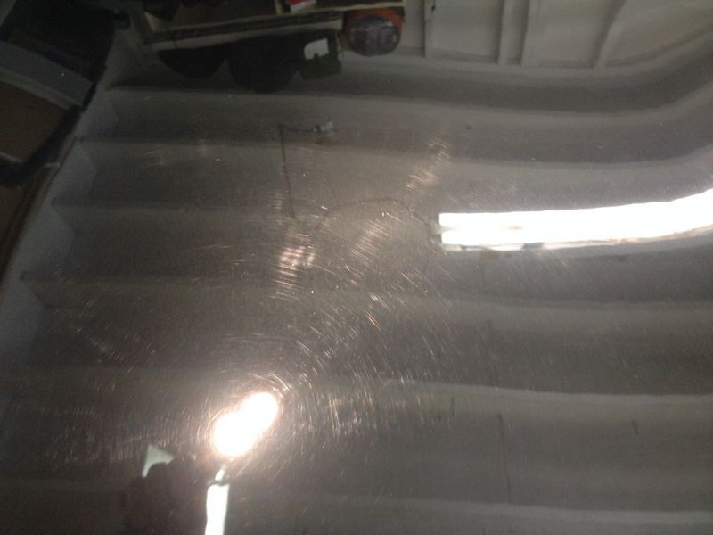

Sanded off clear coat
Here's the best of the two pictures you posted.
73420d1620943412-sanded-off-clear-coat-car-pic-mod-1-jp-jpg
My advice on scratches like that are not to touch the paint unless you have a thickness guage that will give you a starting point and progress along the way can be seen. Depending on thickness, I would recommend chasing RIDS like that much at all. One never "removes" a scratch, the process of polishing and sanding simply levels the surrounding area to lesson or hide the appearance of the scratch but at a cost of the surrounding clear coat.
Think of it as the lowest point and you're creating a larger "lowest point" to simply hide it. IMO, on a stock factory paint job, not always worth it.
The bottom sanding scratches don't look like you went through and just need buffed out but the top circle of scratches looks like you went through in the middle where it is white.
Thanks for all replies. I will try one of the mentioned compounds and orange pad on speed 6. Yes the white part is on the fender bottom area where it is even thinner due to the curvature. I live in Central California in the San Joaquin Valley.
I found Griots Complete Polish. Would that be the one. I don't see a correcting version.
Sorry. Actually says Griots Complete Compound.

So Monday morning, checking on the forum since the weekend is over and I find this thread, and this last post in this thread from the guy that was looking for help removing sanding marks and "HOPEFULLY" not sanding and then buffing through the clearcoat.
fjhrmg,
The product you found is the entry level compound in the Griot's line. It works. It's not great and wipe-off is s tick on the difficult side. The product others were talking about in this thread is the BOSS line in the Griot's brand.
