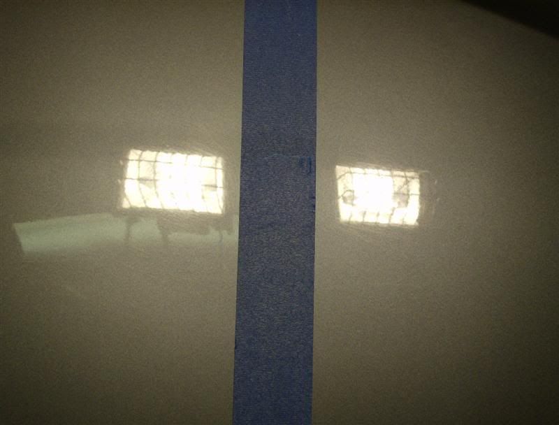

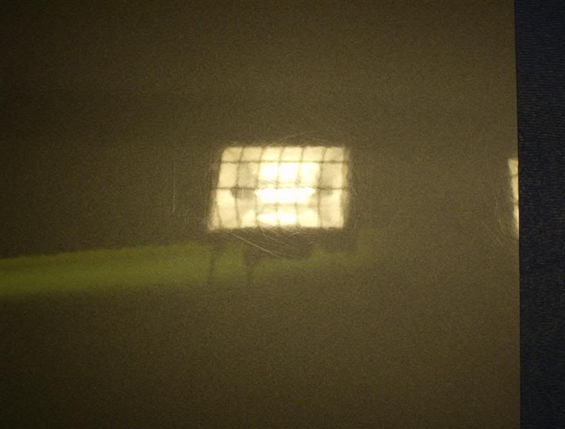

I have a strong belief that the spinning action of the PC adds to the correction of paint. Since the spinning action is result of the orbiting of the machine it seems like the spinning is 'just for looks', as others say. So to find out the truth to this PC Myth, I went into the basement and did another test. The hood isn't in good shape anymore... I have added a lot of marks in the paint that are nearly impossible to remove, as you can see in the before and after pictures...

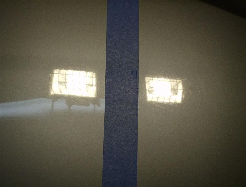

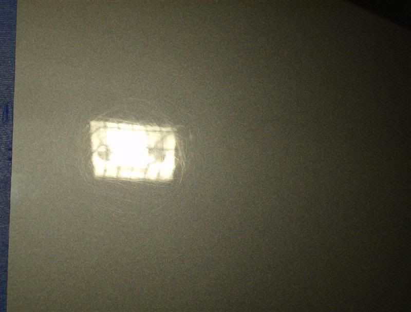

I added some swirls into the paint with dry 2000 grit sandpaper. I used the PC 7424, LC white 7.5" VC polishing pad and SSR2.5. I used the same amount of product (6-8 dabs or a thin bead around the middle of the pad) for the 1'X2' area and worked it in for 1 minute and 30 seconds. The right side is the PC untouches, ie spinning and juggling = dual action. The left side I held a microfiber onto the pad and backing plate to prevent the pad from spinning. I don't recommend to intentionally stop the pad from spinning because the MF actually melted...
The results are very similar... more testing and I would be able to close this myth :).
Before swilrs (ones present are deep)
Right side done- spinning
Both sides finished
Right side (spinning)
Left side- orbiting
