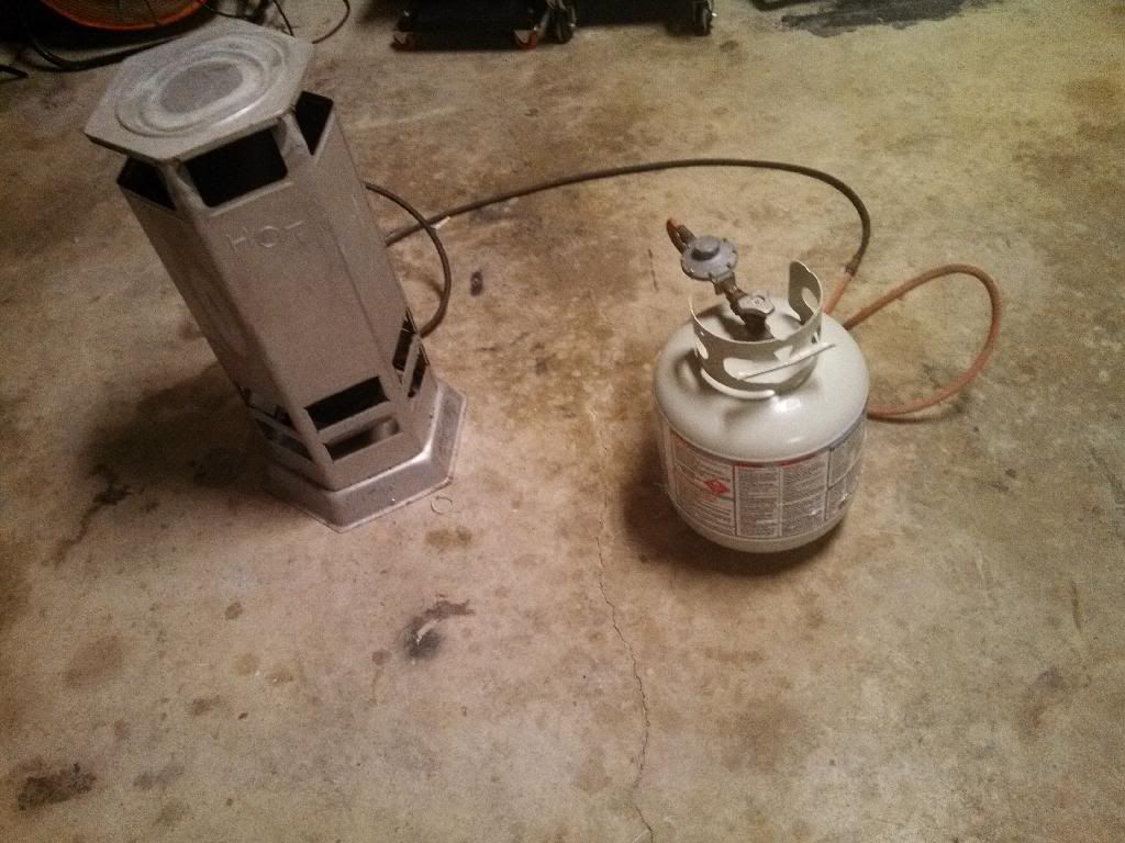

Couple days late on the picture, but nontheless here it is.
100,000-200,000 BTU Propane Heater- Works great.
That bottle won't last long with that thing running! I have a smaller heater like that also, and a small 20# bottle will last a day or two if being used most of the day. I see your in TX though so you probably don't need to run it all that much like us up north.
with either propane or kerosene ventless heater you have to be careful with the CO that they generate. some people are more sensitve to it than other (I get headaches at 5ppm when most will have no effect before 25ppm) you need to have some fresh air circulation or you will get CO buildup. the bigger the BTUs, the bigger the fresh air opening you need, and get a good CO detector if you go ventless!
