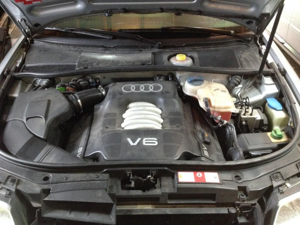

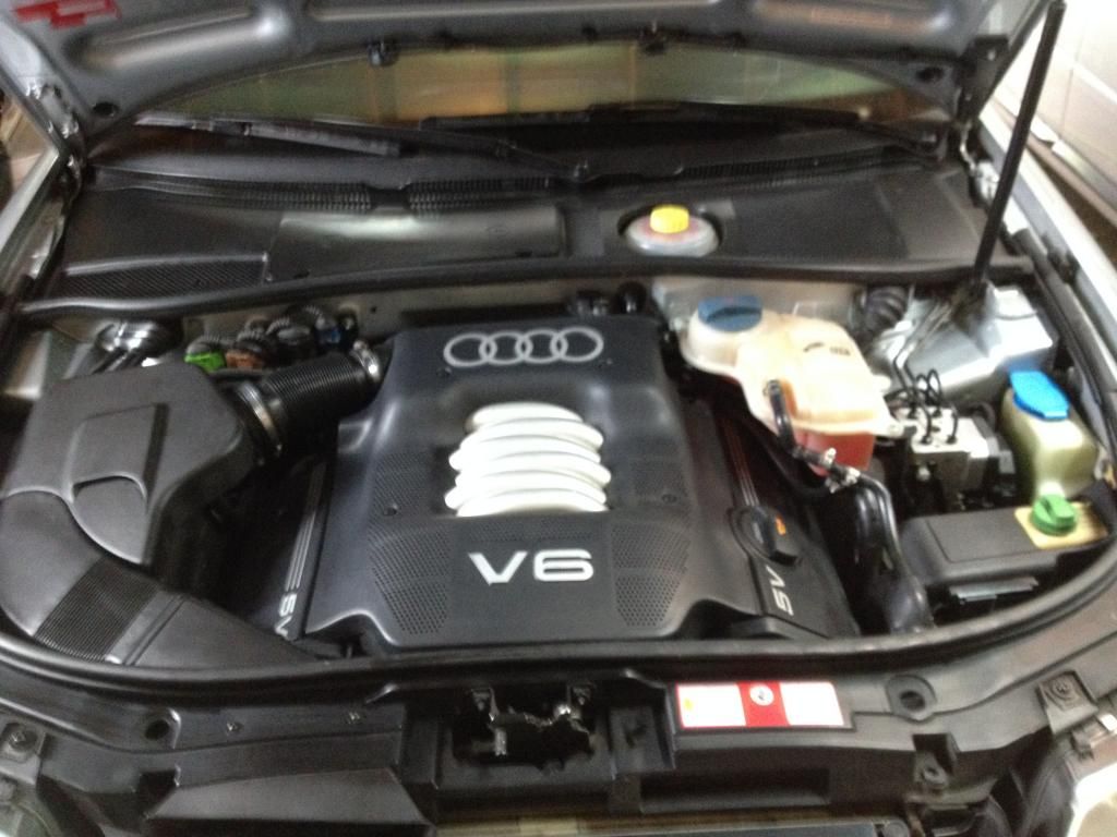

Case in point: My engine bay. It's not filthy, no oil spewed all over, but it's not pretty and it's going to take some time to clean....or is it?
To do the engine bay and underside of the hood took 10 minutes including set up to tear down. I was done before my steamer would have been ready to start. I usually expect 30 minutes to do this job with a sprayer, brushes and rinse water. I only used about 6 oz of RTU product; with a garden sprayer I expect closer to a gallon of rinse water plus chemicals. Is it showcar clean? No, but good enough to pass muster of a typical engine detailing and almost no water used so I'm not worried about water getting where it shouldn't be, same big advantage as the steamer.
