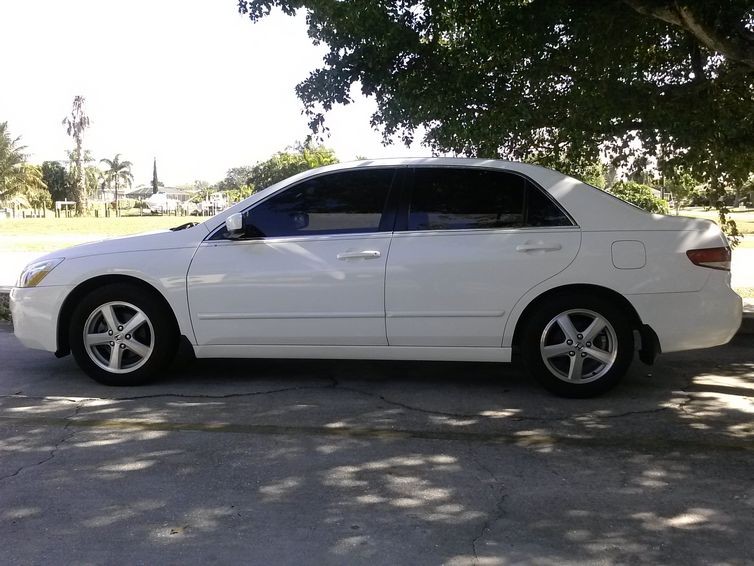

Done so many here in south fla,camrys and accords sequoia.
