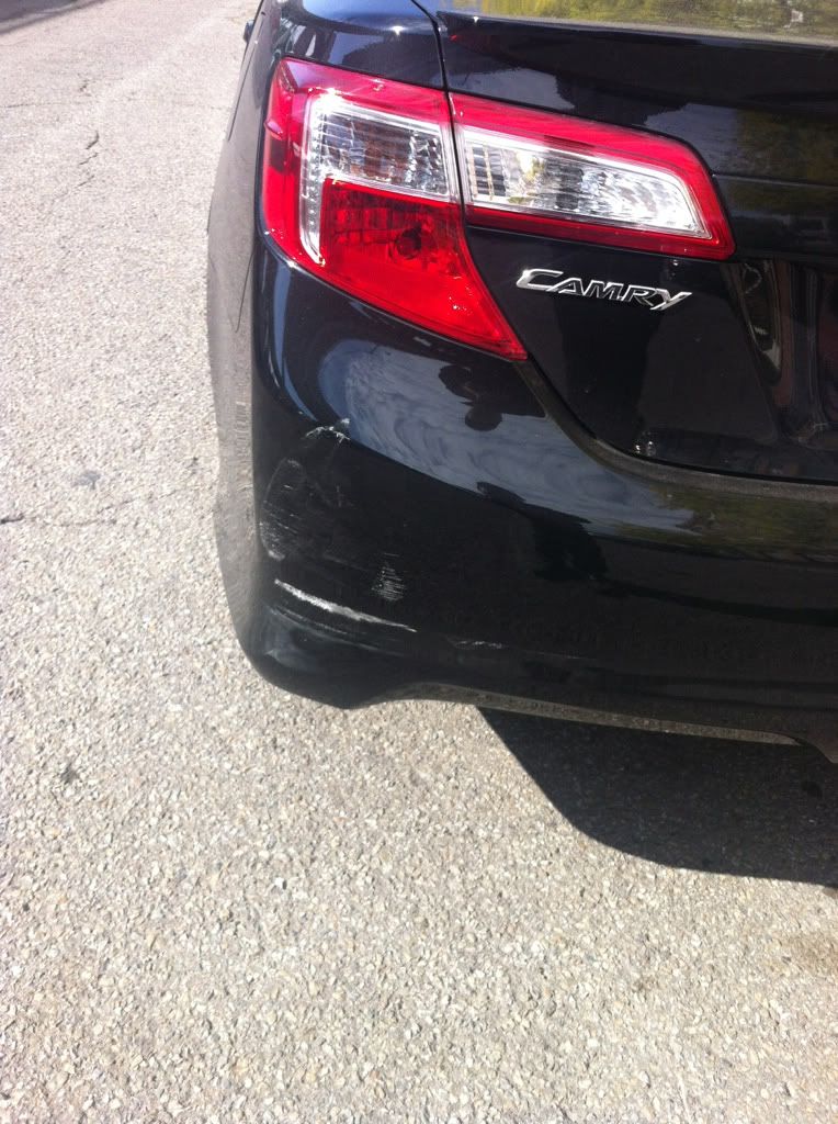

came back to find this:

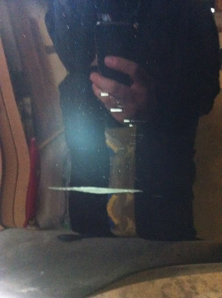

Went home and used Meguiar's rubbing compound to take off paint transfer from other car. That worked fine, but there are areas where the other car took the paint completely off. See picture below. How should I go about fixing this? I am new to detailing. I read that I can use touch up paint - wetsand and then buff/polish it. Never wetsanded before and honestly kinda scared to even attempt it.
I would recommend using Dr. Colorchip. The company will use the paint code for your car's color. You simply dab, smear, and wipe off with their solvent. You can build it up to fill the scratch and wipe away the excess. Wetsand only if needed.

if its only a scratch your worried about wet sand it with 1500 6inches out of the scratched area all around the scratch use a soft foam sanding block then go to a local bodyshop and ask them to sell you 1oz of paint and 2oz of clear go home clean the area with thinner get a prevail sprayer and mix your paint in it only cover/paper up the tail light area then spray your base 4to6 inches away just on the scratches let it dry 10to15mins now you may need to do that multiple times then when they look filled in enough step back and mist it 12to15inches away to balance out the metalics,next mix your clear in another prevail clear the whole area sanded leaving 1inch of 1500grit scratch left let it dry 8hrs then lightly sand your new clear with 1500 then buff the whole bumper..
in my system it show min mix 2.oz $2.67 cents is my cost so base and clear should be no more then 20bucks..

It always seems like the camry's get hit...someone scraped my front bumper because I backed into the parking spot at Walmart (I hate Walmart with a burning passion, so many careless people) looks like they backed out and hit it, and ran. the car's white so there's a nice big black scrape there. But anyway, just shop around some body shops and see what quotes you get. MAKE SURE THEY'RE REPUTABLE. You should go to where you bought it at, because that's your best bet. Just my .02
