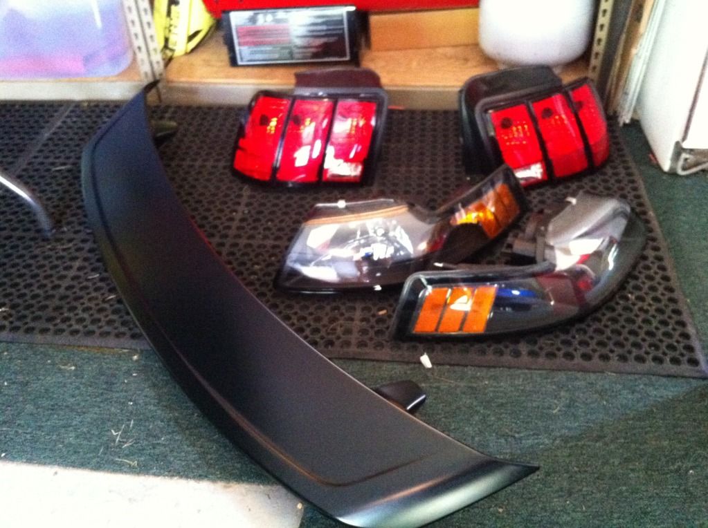

remove headlights tails spoiler tape emblems

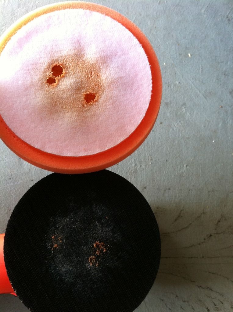

pad prep..

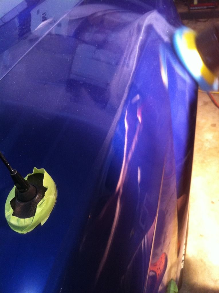

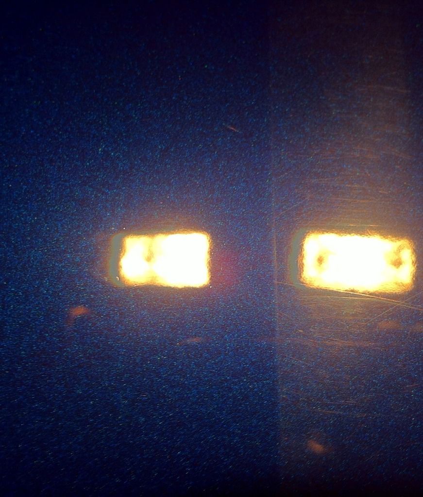

m105 correction begins.. incredible improvement

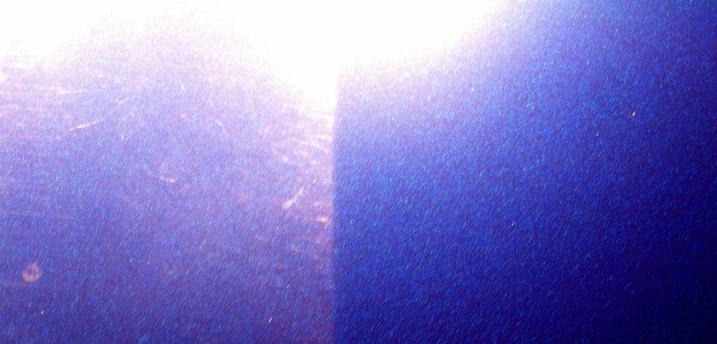

side by side comparison taped off both sides clean / ipa wiped
awful m105 dusting
another side by side of just 105

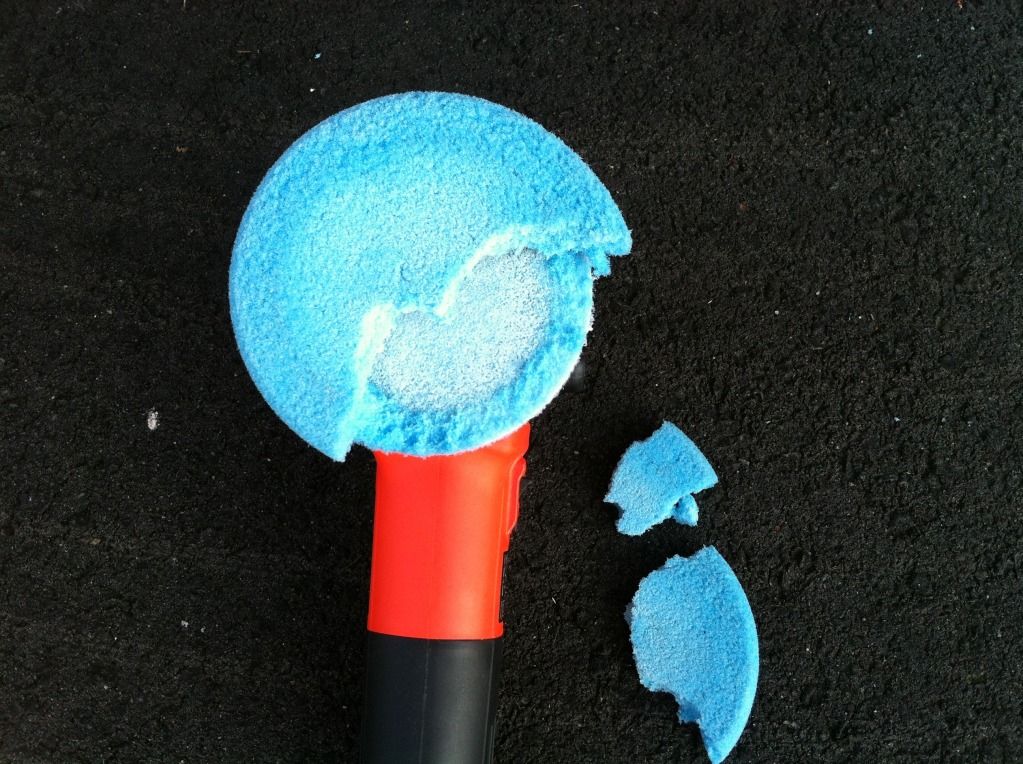

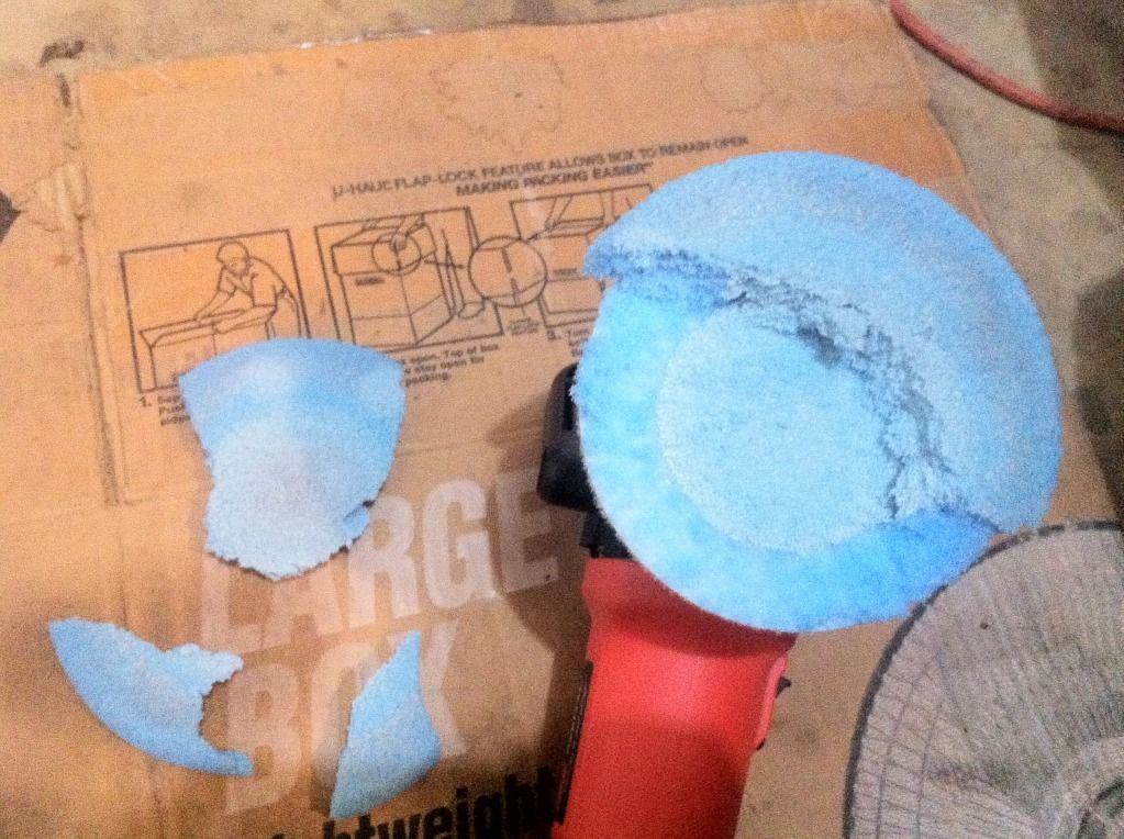

pad failure
the cyans ripped apart while polishing, just exploded

sitting dirty after just 105, no editing, great improvement already..

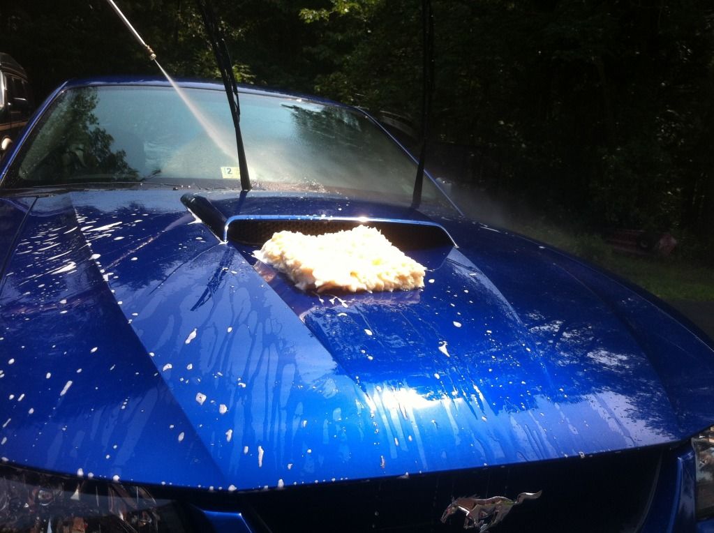

different location, foaming session, quick wash

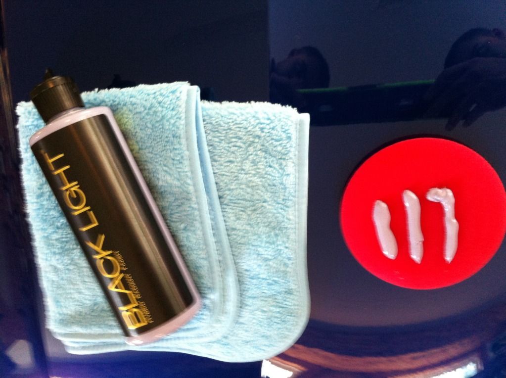

hand apply black light entire car.. twice
hand apply jetseal109 entire car.. twice

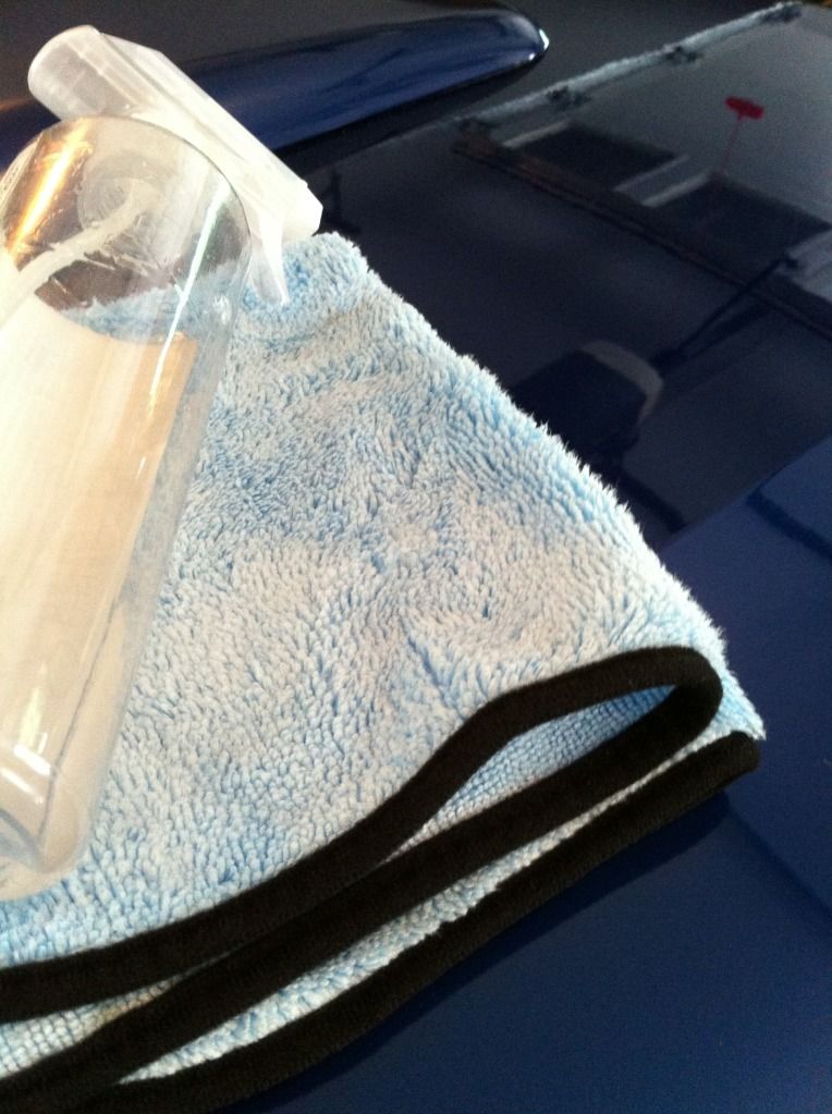

mothers microfiber, wow! under rated, much better than my over priced cobras and better than some of the cg towels, this towel is great, if you want a sample of it pickup a mothers claybar kit

little bit of pad cleaning, carpro paint cleaner.. yeah its not supposed to soften your clearcoat like apparently ipa will (which I used 70% 1:1) I used the paint cleaner, it acted pretty much the same, maybe a little less potent, way over priced its something like 1000x more expensive because I pickedup a couple 32 oz of ipa for cheap from wegmans, won't be buying paint cleaner again

Nice write up. I wonder what caused the blue pad failure?

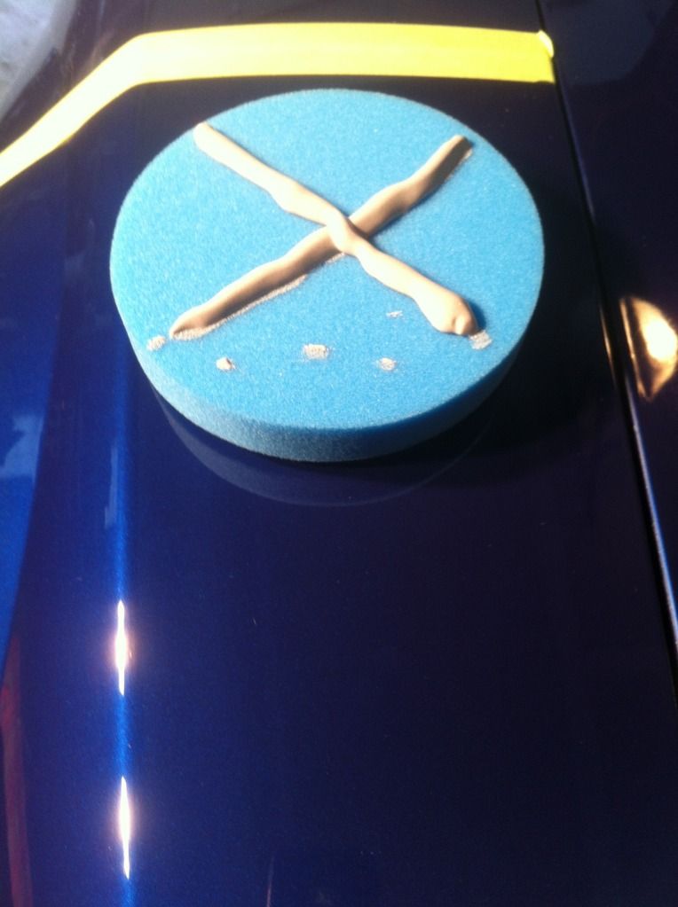

Pad Failure
More often than not, I've discovered that my pad failures are due to two things in particular; too much product and downward force.
When a pad becomes saturated, the motion of the pad combined with downward force causes the liquid to heat and degrades both the foam and Velcro adhesive which leads to the failure.
I guess between a little too much product, not switching pads often enough working in 90-100 humid heat too much pressure, poor quality pads, probably a mixture of all of the above, but thank you

Nice job. 105 is a pain, but less product is better. I would guess thats what happened to the pad, to much product. Even if you were priming the pad, like in the one picture, that would be to much for me. With my experience, use less of 105 and work smaller areas. Keep playing around with those 2 things. You will eventually dial it in. I always use many pads when using 105 also. Have fun
poor quality pads
Spent hours upon hours researching techniques
I don’t really wish to sound negative, because the outcome of your effort seems to have certainly satisfied you. However for the sake of new comers here I think this type of post should be corrected for their benefit and hopefully yours as well.
You claim poor quality pads for the failure of the cyan and the tangerine pad. That could not be further from the truth because those pads happen to be very good quality pads if used correctly.
Your obvious mistake was the ridiculous amount of product (M105) you used on the cyan pad. I’d suggest before you blame the quality of the pads that you should have done even more research and learnt how to properly prime a cyan pad. My suggestion to you and anyone else reading, who wishes to use M105 would be to read up on the Kevin Brown method (KBM). It is more than likely that you would have experienced exactly the same problem if you were using the conventional orange and white pads from LC using the same product(s) and technique.
Obviously switching out pads and using the correct pressure and speed are other important considerations. A vehicle of that size (an average size vehicle) would require at least 4 cyan pads to complete a major correction with M105. However if a set of pads is used correctly and cared for after use, then there is no reason for them not to be used on many vehicle corrections. Premature pad failure is almost always user error not manufacturer error.
You will also find as you correct more vehicles in different weather extremes, that temperature and humidity is only a minor consideration. As long as the panel is cool to touch, it shouldn't matter what the temperature is.
