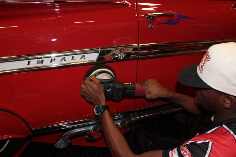

Defects are either topical, that is on the surface or sub-surface, or sub-clearcoat. What I do for things like this is what I call troubleshooting. The way I troubleshoot paint problems is place a tape line over the affected area and then ONLY buff on one side of the tape line. After buffing (compound and/or polish), wipe off the residue and inspect.
If you see no difference at all, then the paint defects are like you guess, they are likely under the clearcoat or "in" the clearcoat but they go "throughout" the clearcoat thus more and more buffing just reveals more and more of the defects. And if you buff to far, you'll buff through the clear layer and expose the basecoat layer and then it's game over.
