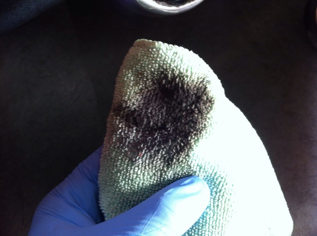

6. Dip one of the microfiber towels into the Mother's Mag and Aluminum and start
working it in and polishing. Always use the dirty microfiber for rubbing it in and polishing and use the cleaner one as a buffer. If you are doing it right, quite a bit of black should be coming off.

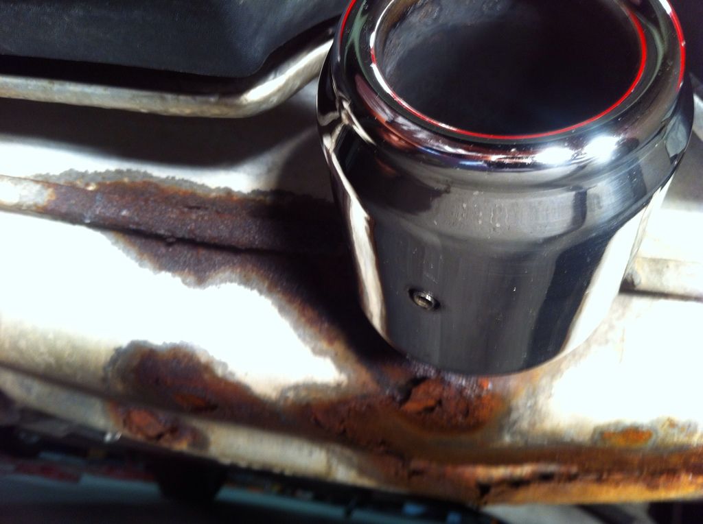

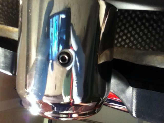

7. Do this for about a minute per tip and you are good go. The pix is of previously soot-black tips.

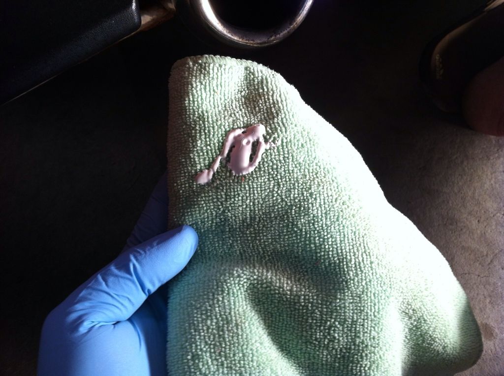

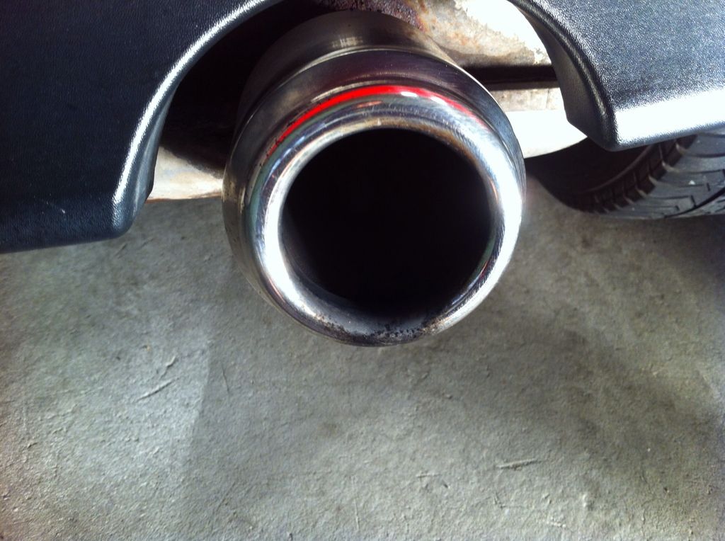

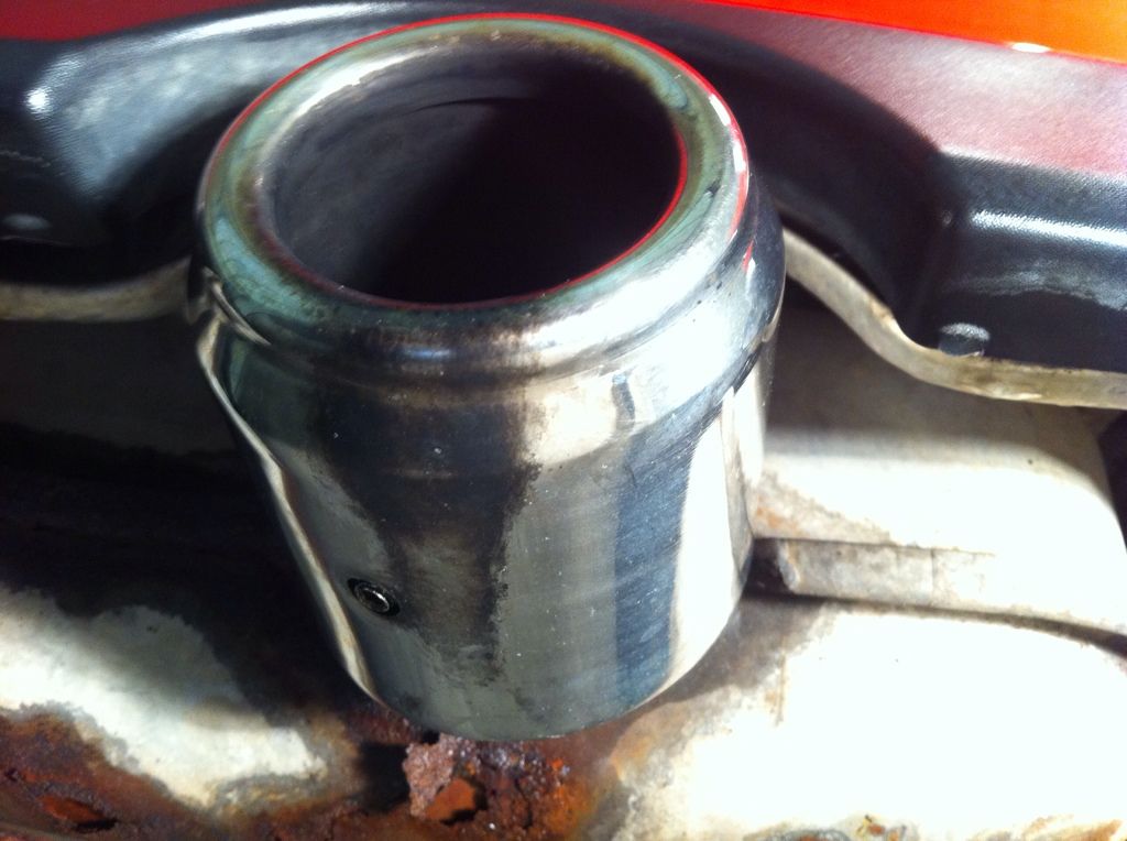

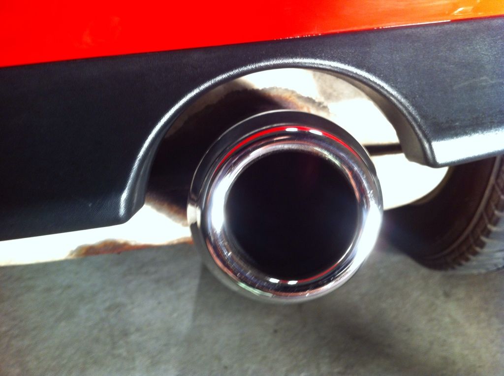

I use CG Metal Shine with good results. Heres a few pics I took once of the exhaust tip on mi MINI when I got it. Not much time spent either, just a micro and a few minutes polishing it.
Before with Carbon Deposits
Product Used
After Working it in for a couple of minutes
After
