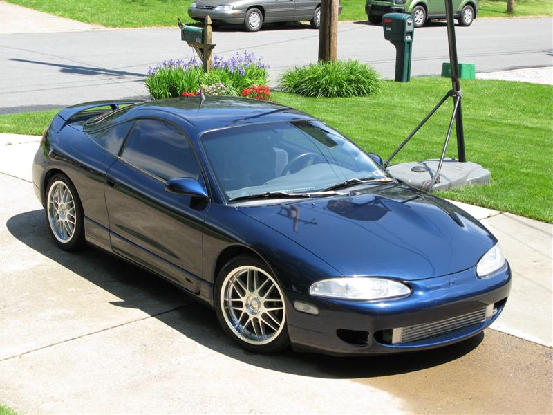

And here are some of the vehicles that will be detailed.
My Eclipse (same paint as the Dodge Ram - not sure how it was applied though)
My Ram (factory paint)
102673d1257829496-plans-projects-09-10-offseason-related-road-racing-autox-rally-img_7989-1024x768-.jpg
My brother's Eclipse (and possibly the red Monte Carlo in the background) - both factory paint
