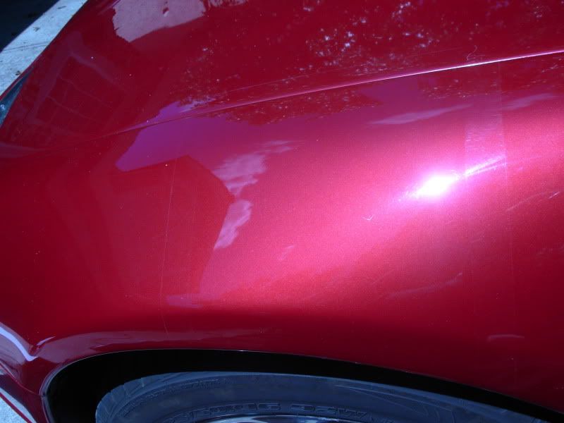

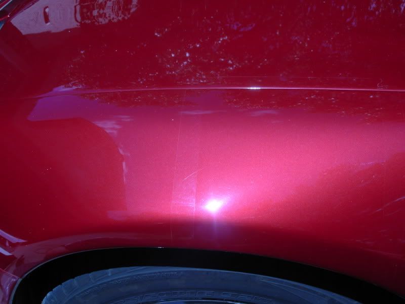

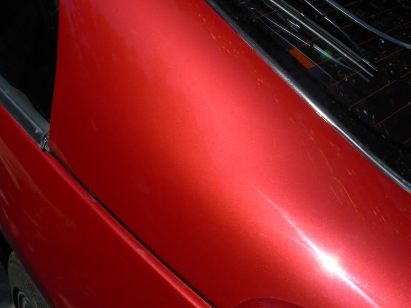

Hi guys. Just finished up a test spot with the PC Dual action polisher.
Here's an idea of the swirls on my car (1991 300ZX Twin Turbo). Just a little history I had my car repainted in early 2008, and I've kept it up with wax and clay bar. But rarely polished.
Here was my process. After wash and dry of course.
1.Clay bar
2. Orange CCS light cutting pad with XMT swirl remover #2
3. Finishing pad with XMT Carnauba Finishing Glaze
4. Finishing pad with S100 Carnauba Wax
I didn't really get the results I want. I've tried certain spots 3-4 times over with the XMT Swirl remover #2, and it gets better, but still not where i want it to be. I was applying ~10lbs of pressure while buffing, went over the area about 6 times slowly.
Do I need something more aggressive? like #3? or something else you guys would recommend? Or am I just picky?
