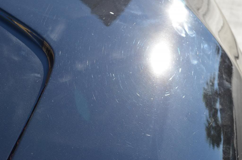

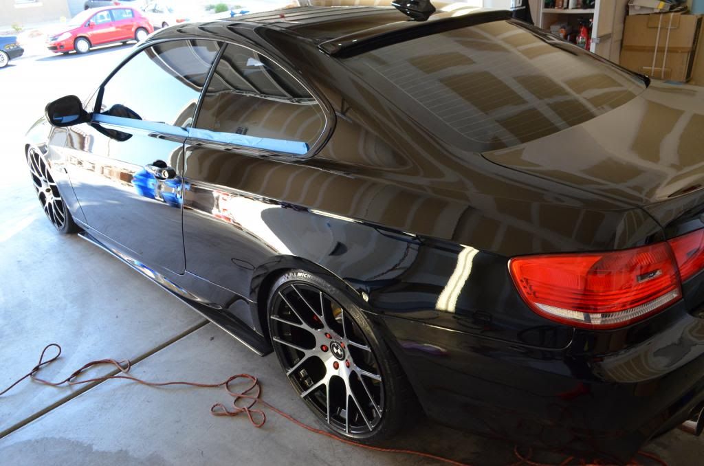

Hey everyone! I have a few more pics to show from a detail I did today. Pretty busy weekend, but all the hard work was definitely worth it. A friend of mine finally blessed me with the chance to touch his paint and here are the pics.
Products used:
GG6 DA
Meguiars Car Wash
Wolfgang Uber Wheel Cleaner
Meguiars APC
Mothers Clay bar
Ultima Waterless wash as clay lubricant
Menzerna FG400
Menzerna SF4000
Eraser
Duragloss 111
Chemical Guys Butter Wet Wax
Meguiars tire gel

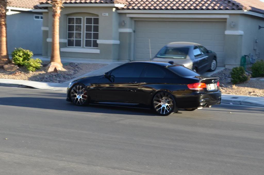

On drop off:

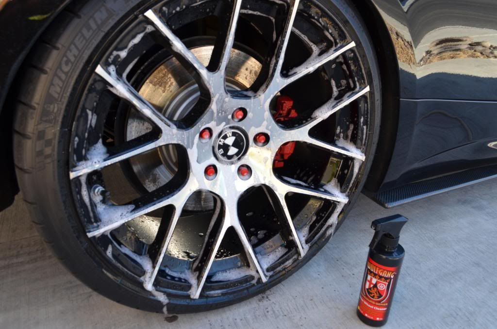

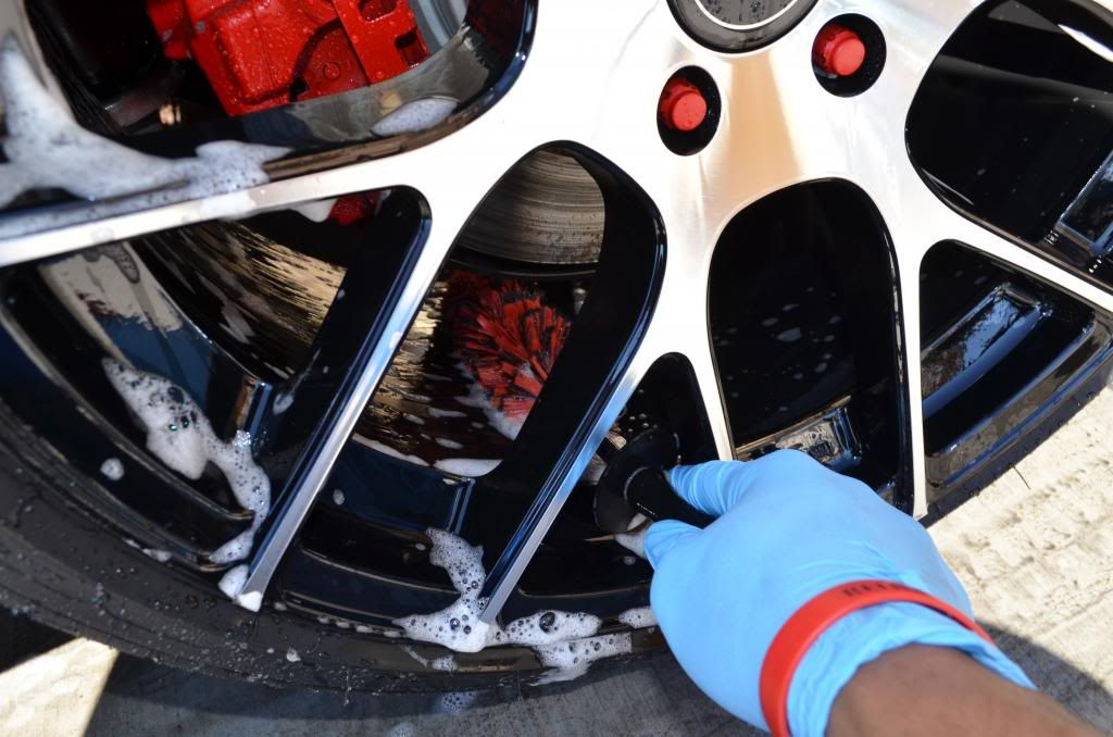

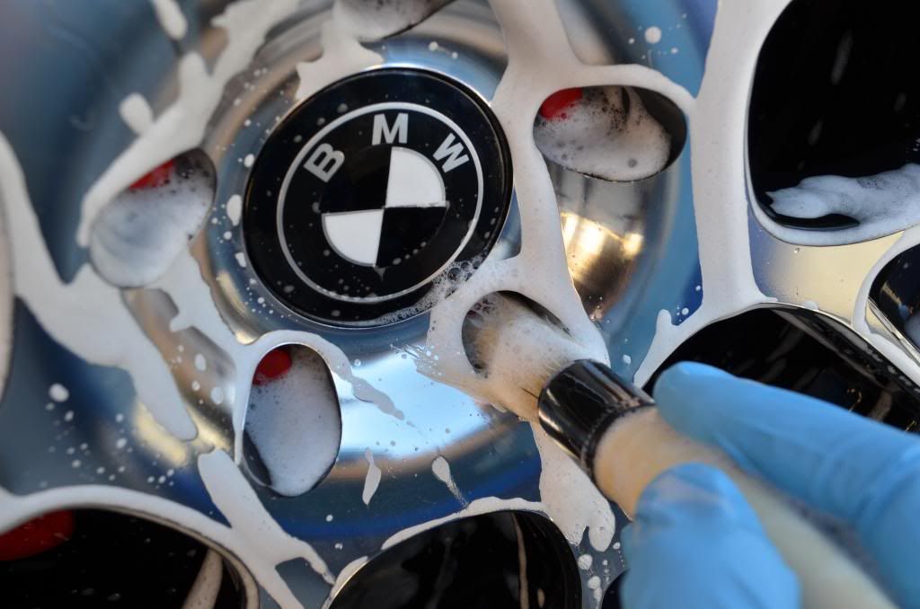

Wheel cleaning in progress:

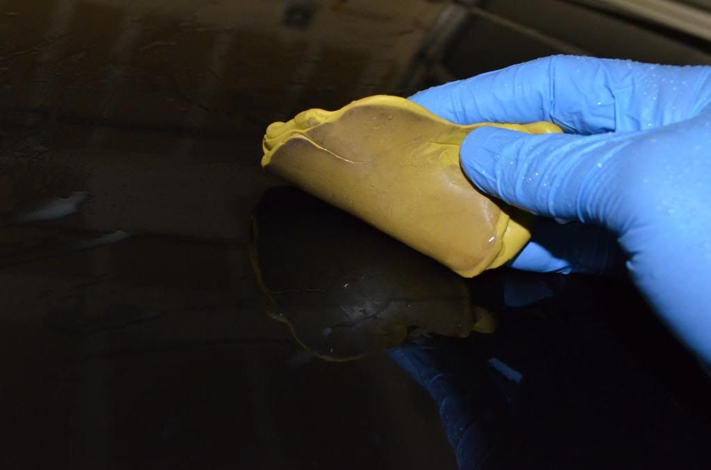

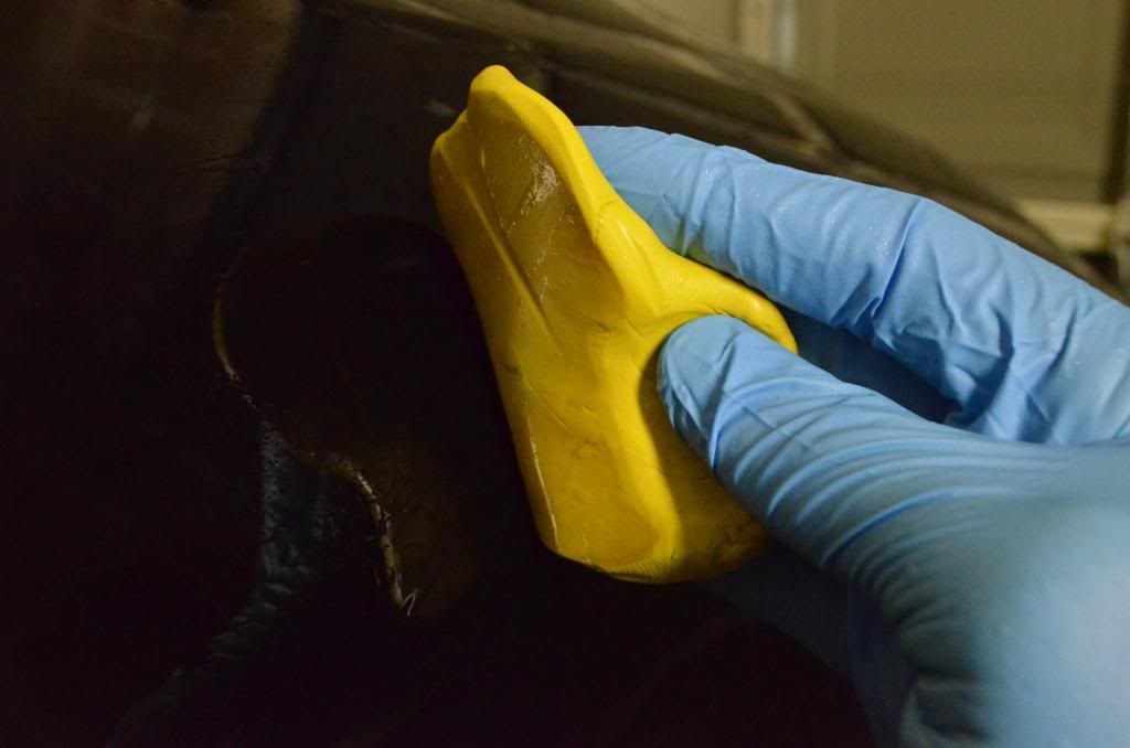

Clay bar time:

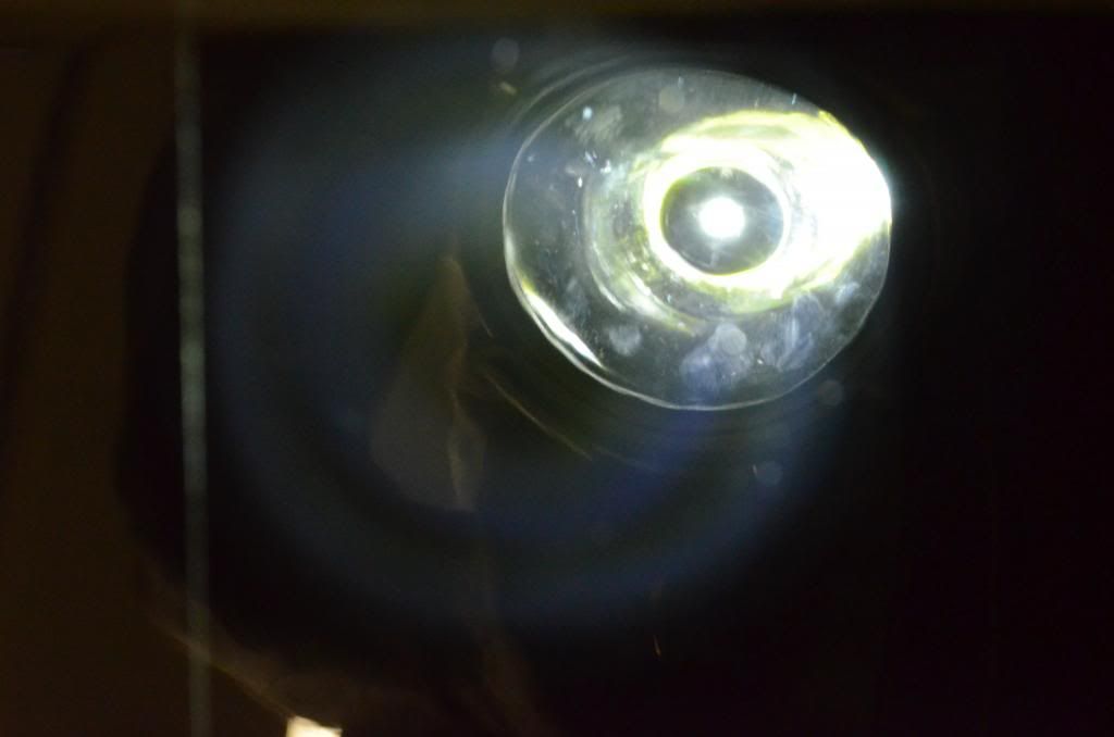

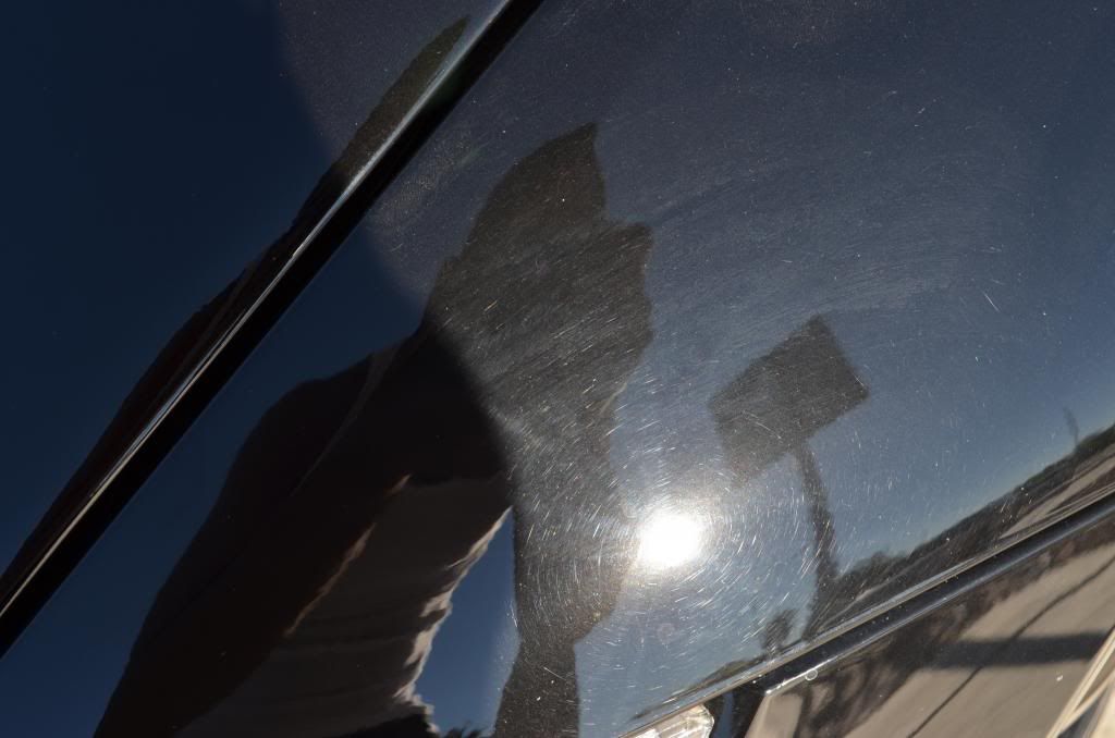

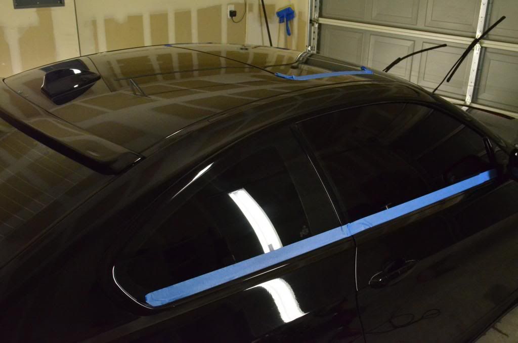

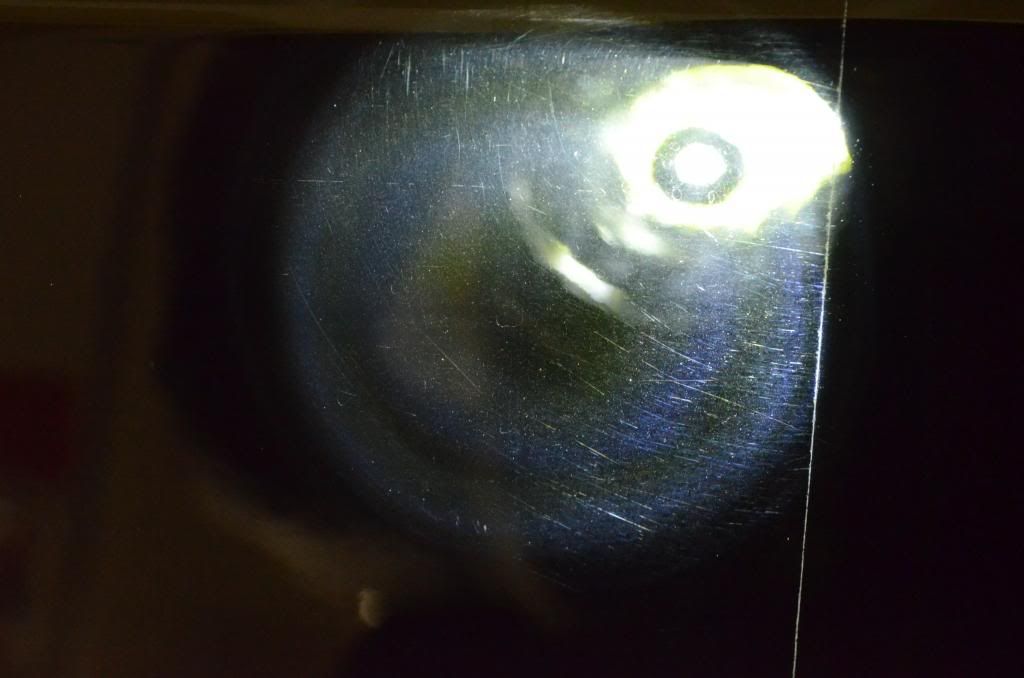

Prepping for correction:

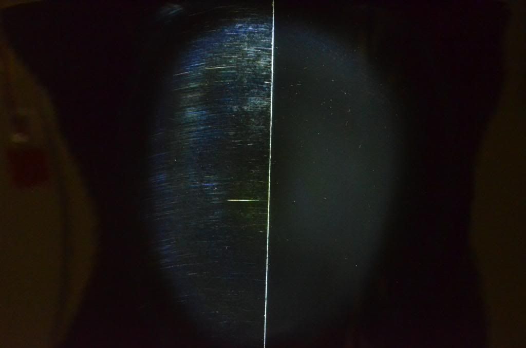

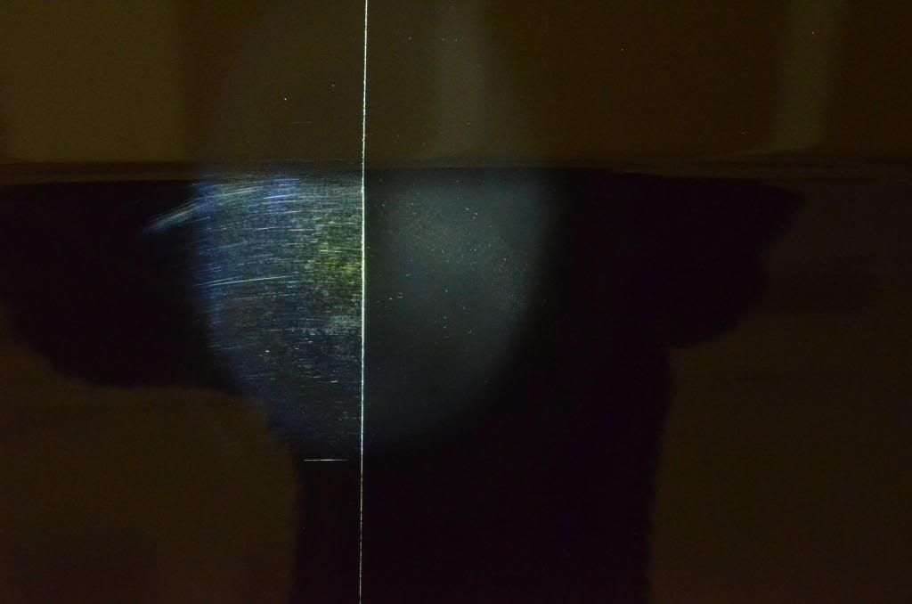

Correction in progress:

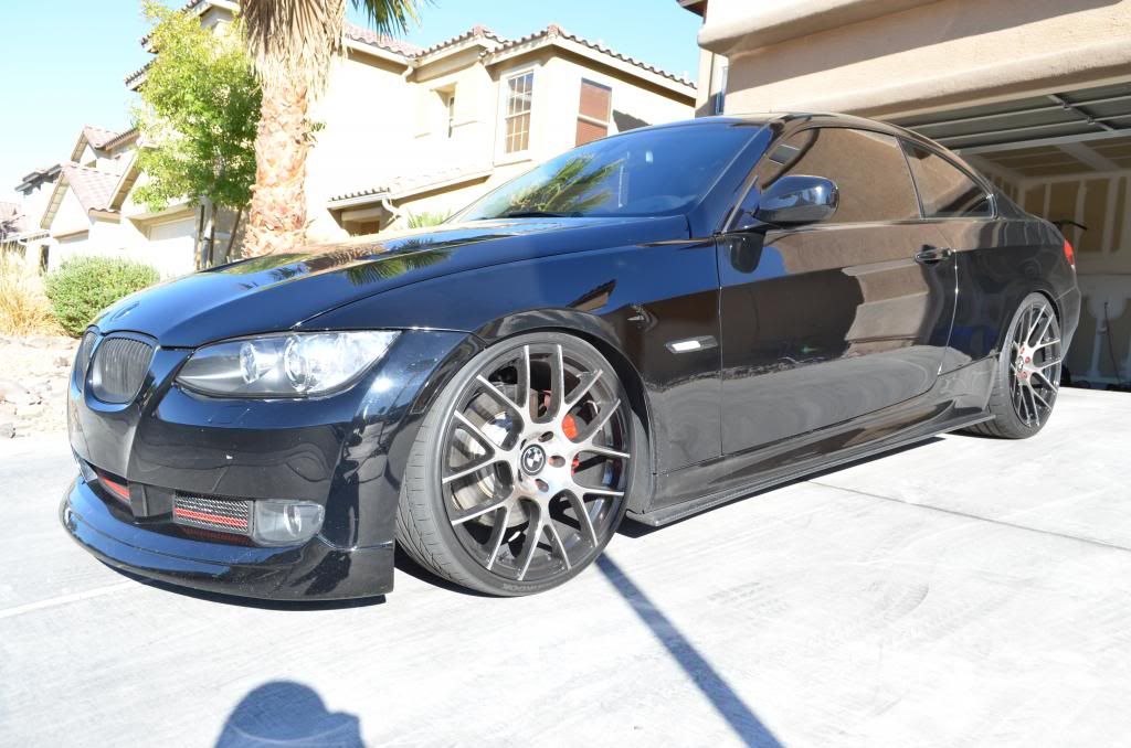

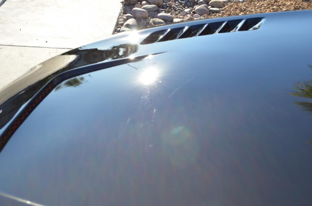

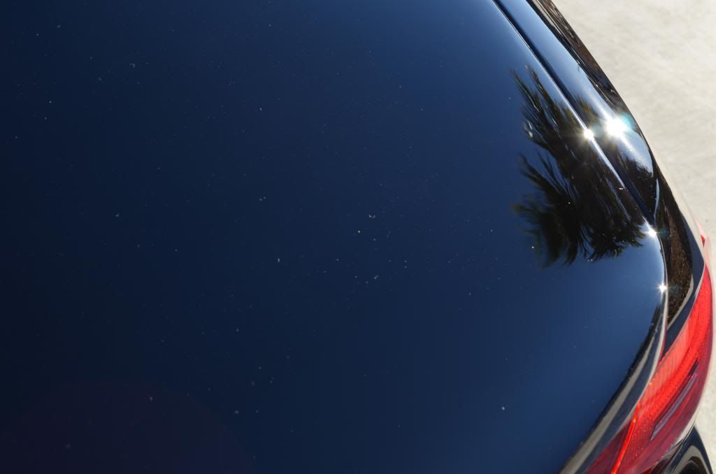

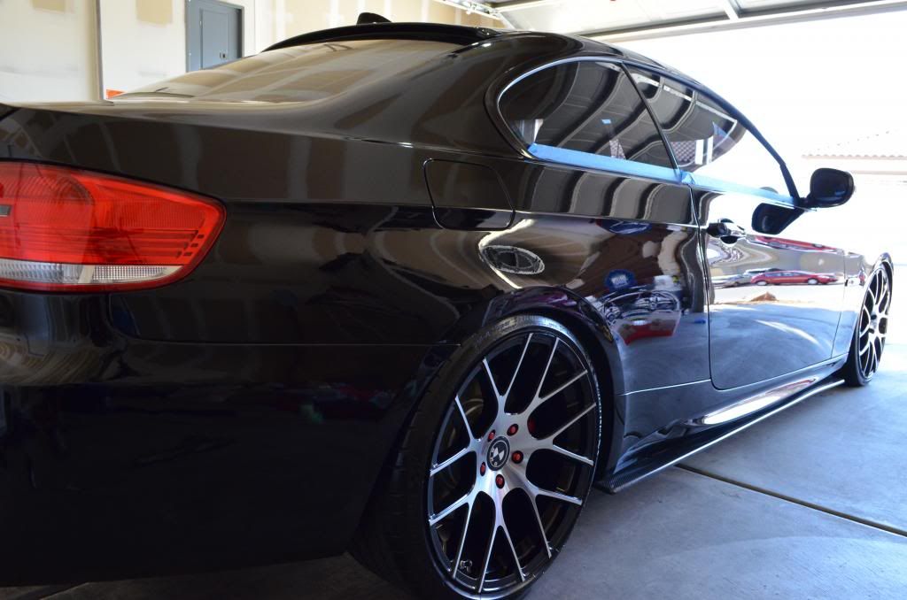

After all steps: Gloss pics:

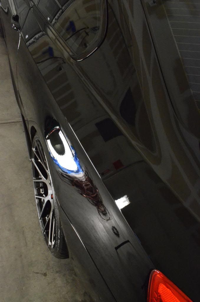

Had to rush the sun pics since he had to rush off. I will get get some next time, but all rotary trails were removed from the trunk as well..
One more successful correction!!
Thanks for looking everyone. :buffing:

What was your pad combo with the menz polishes?
Thanks guys :xyxthumbs:
I used a heavy cut pad (with quite some pressure) from my local store with with the fg400. I did about 5 passes per section on speed 5.5 and 6 for the deeper scratches and a polishing pad with the sf4000.. I need something with more cut than fg400 though. I am gonna look for some candidates to experiment with. I just love how the fg400 doesn't dust though. :/ Need more cut though. Or I may just need to step up to the 3401.

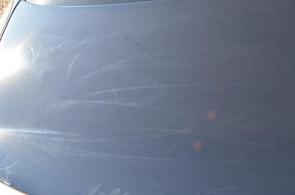

Yea brotha.. he added a C/F hood, trunk and rear bumper. I there was soo much crap on the new pieces. The clay bars were dumped after the job. lol. There were horrible rotary trails on the trunk and scratches all over the hood. He called me back after he got a chance to look at it in the sun. That was when he realized how much correction was done.
